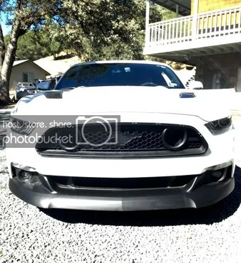

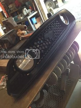

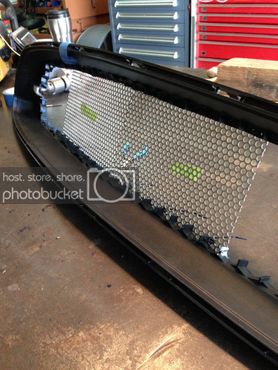

Alright guys HUGE update. So ive been racking my brain on how to attach the two grilles together with plastic welding being the first thing i tried (that went horribly wrong and had to think of somethin else) then BAM! it hit me! And it was so simple. I ended up using a sheet of perforated steel and created a backing to the 50th grille and simply attatched the 14 grille to the backing using alot of zipties (cleverly hiding them was the most time consuming part) and after hitting it with some satin black paint i gotta say it came out waaay better than i thought, now i have to order the damn horse emblem (50$?! Wtf)
The "backing"
All attatched and painted
Another test fit
