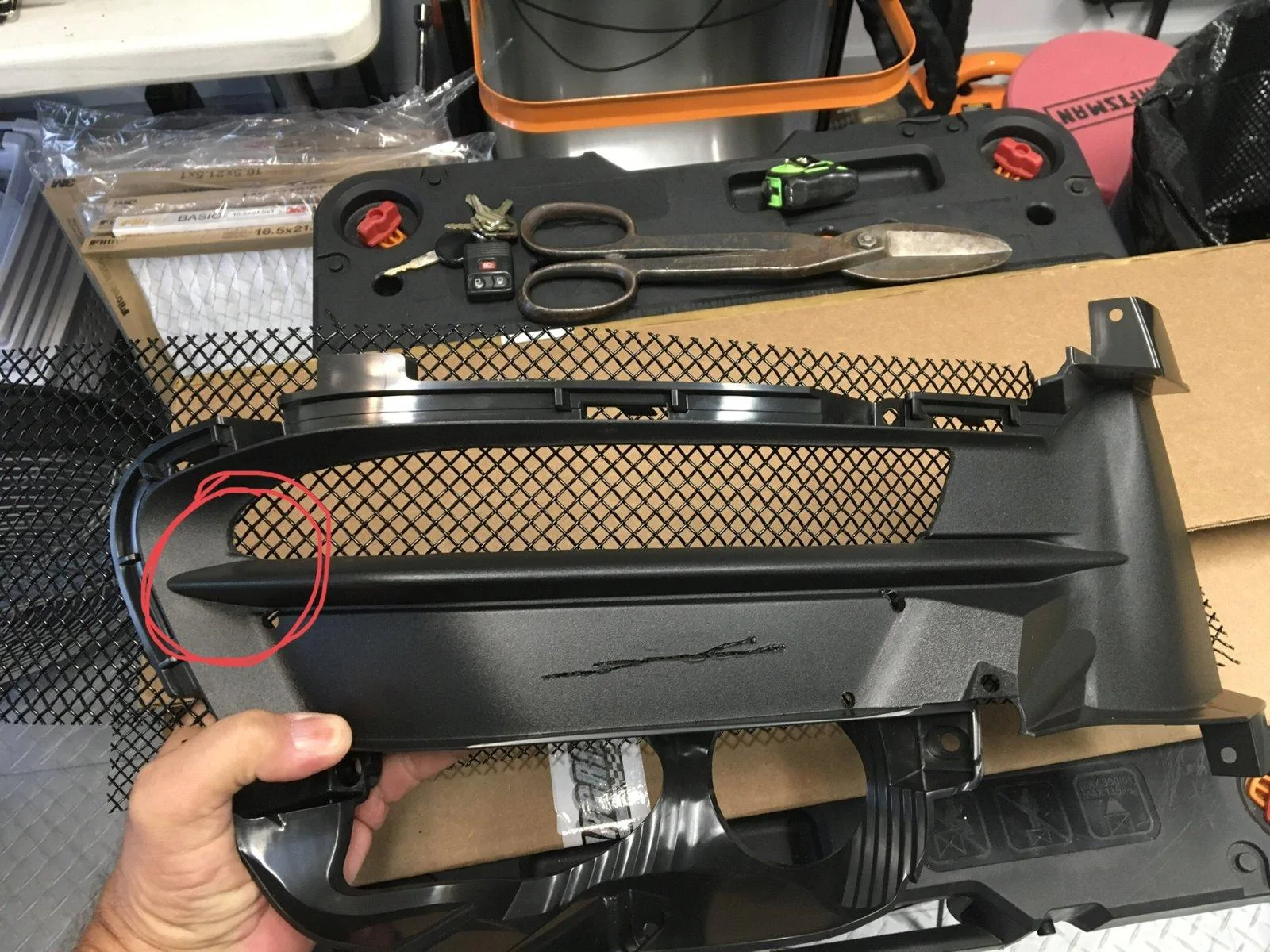

I’m far enough along so I thought I would do a small write up on my foglight delete.
The inserts are for the V-6 car and I cut out everything but the divider. Tried multiple techniques until it was suggested by a couple forum members to use a body saw and paraffin wax to minimize the plastic melting. Once I removed the material I then used a dremel sanding barrel to clean up the edges. This is/was a messy and legenthy project but is well worth it.
Thank you for posting this. I was discussing this with a fellow member and just hadn't had a chance to pull the trigger. This looks better than anticipated!
