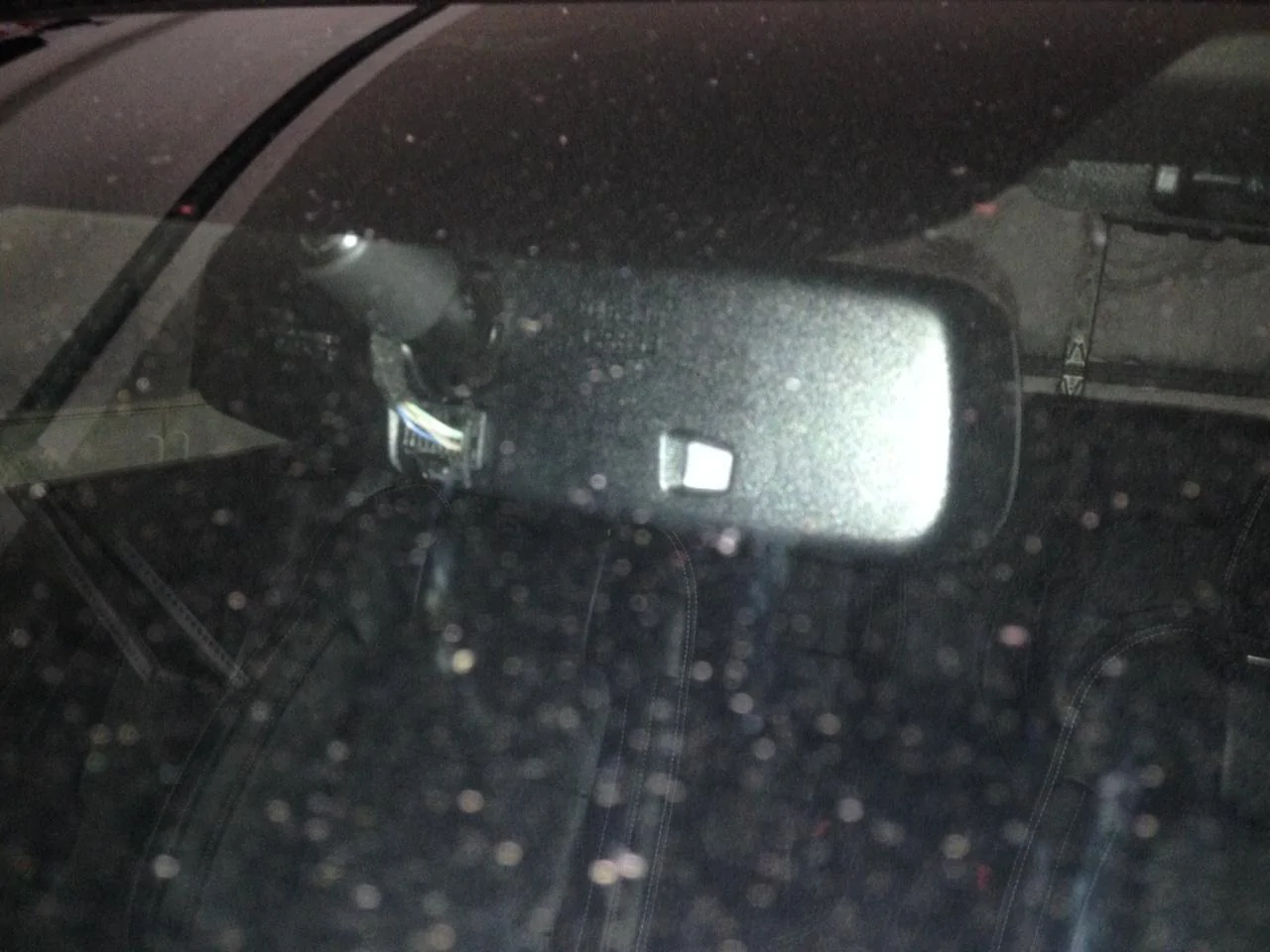

Did you loose any functionality with the generic mirror they built it into? The stock one, on my car at least, has some kind of sensor on the backside. I'm not sure what it is for though. Perhaps rain sensing wipers or the sensor to turn the headlights on a night. (My window isn't near as dirty as that picture makes it look.)

No feature loss at all in the mirror. That sensor is for the auto dimming mirror by the way. When the ESCORT is powered down you can't even tell the display is in there.

Thanks! I wasn't sure why there would be a auto dimming sensor on the front of the mirror. I think you sold me!
