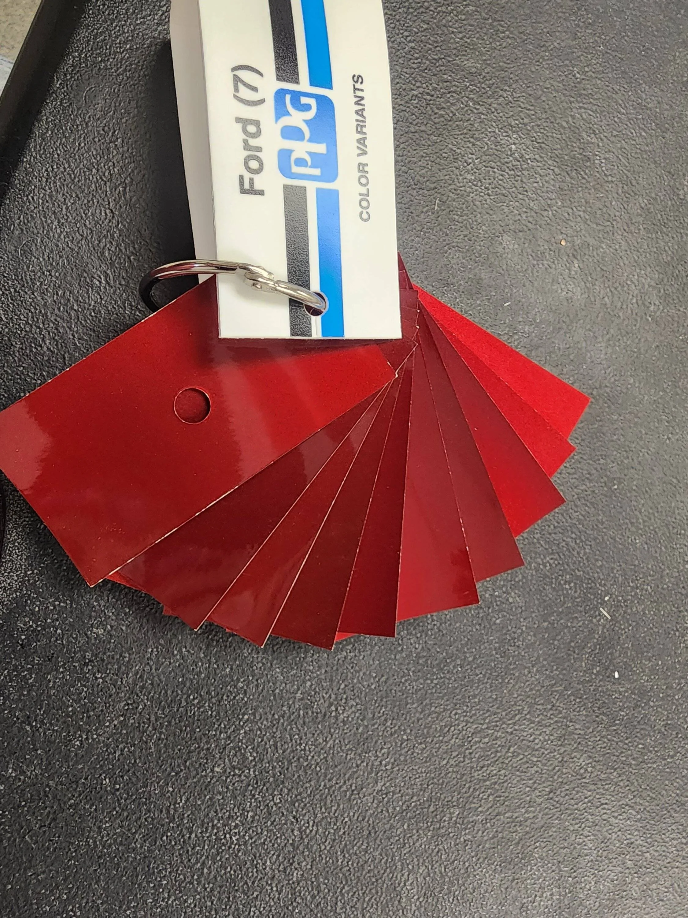

Yep the side tone is off. I would never do a dead shot I always blend into adjacent panels. Ruby red is a tri coat. So it's a bit tougher to match. I do a couple spray outs to see how it needs to go down. Mid coats use the most base. The base sealer color matters also. If you want it to match perfectly it needs. to be blended. I was in the dealership the other day and a mach e and a escape were sitting there. Bumpers didn't match the car. The bumpers are painted separately in a different location not with the car. There are different revisions of colors depending on what was painted before in the paint shop. Dirtier flop.
Lighter flop. Darker side tone ect... here's a pic of ford toreador. One color 10 different revisions
