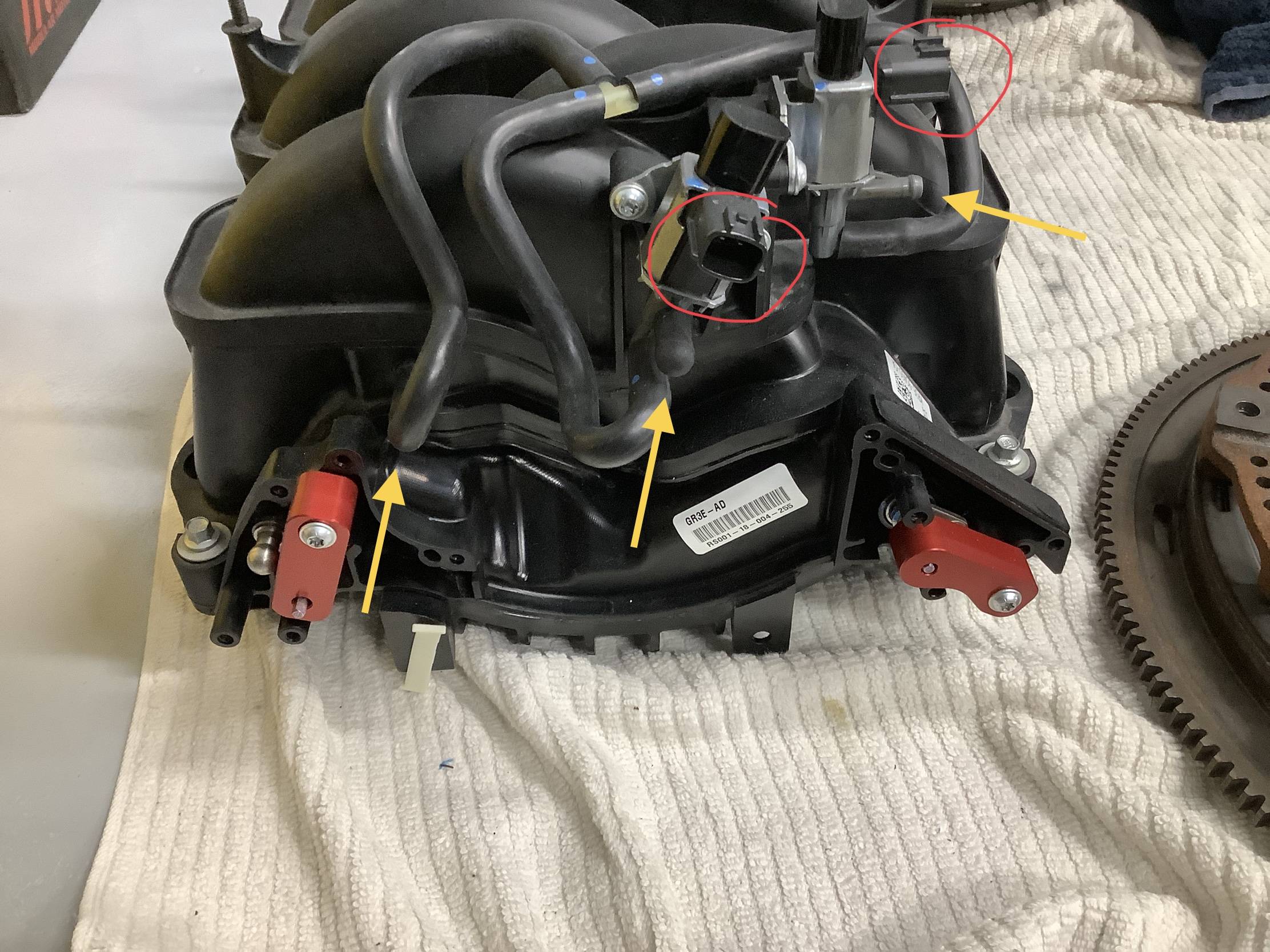

If your IMRCs do turn out to be bad, you can remove all of the hardware and lock them out. MMR sells a lockout kit (see the two anodized red pieces on the rear of the intake manifold). Installation is super easy. All you‘d need to do after installing the lockouts, is have your tuner turn off the IMRCs in your tune. I just went through this myself. I kept the two factory connectors circled in red, along with the vacuum hoses shown and plugged the factory wiring harnesses back up.

Trying to find some VCT Solenoids right now I'm going to have my mechanic checkout the IMRC's i think im going to order the lockout kits to thank you for the advice! I will keep this thread updated when i get everything installed and checkout just incase anyone else has the same problem.
One question will locking out the IMRCs effect anything? & should i have my tuner send me a tune before doing it.
Locking them out won’t hurt anything.
Yes, you could go ahead and get the ball rolling on the tune. When I put my work order in with my tuner, I explained that I wanted to keep all existing tunes and just turn off the IMRCs.

Update:
The cars running like its brand new! huge shoutout to @NGOT8R & @njweatherman for the helping me out!
I replaced the VVT Solenoids, Intake Filter and installed MMR Lockouts. Cars running super smooth haven't had any issues so far! The car feels like its brand new again.
