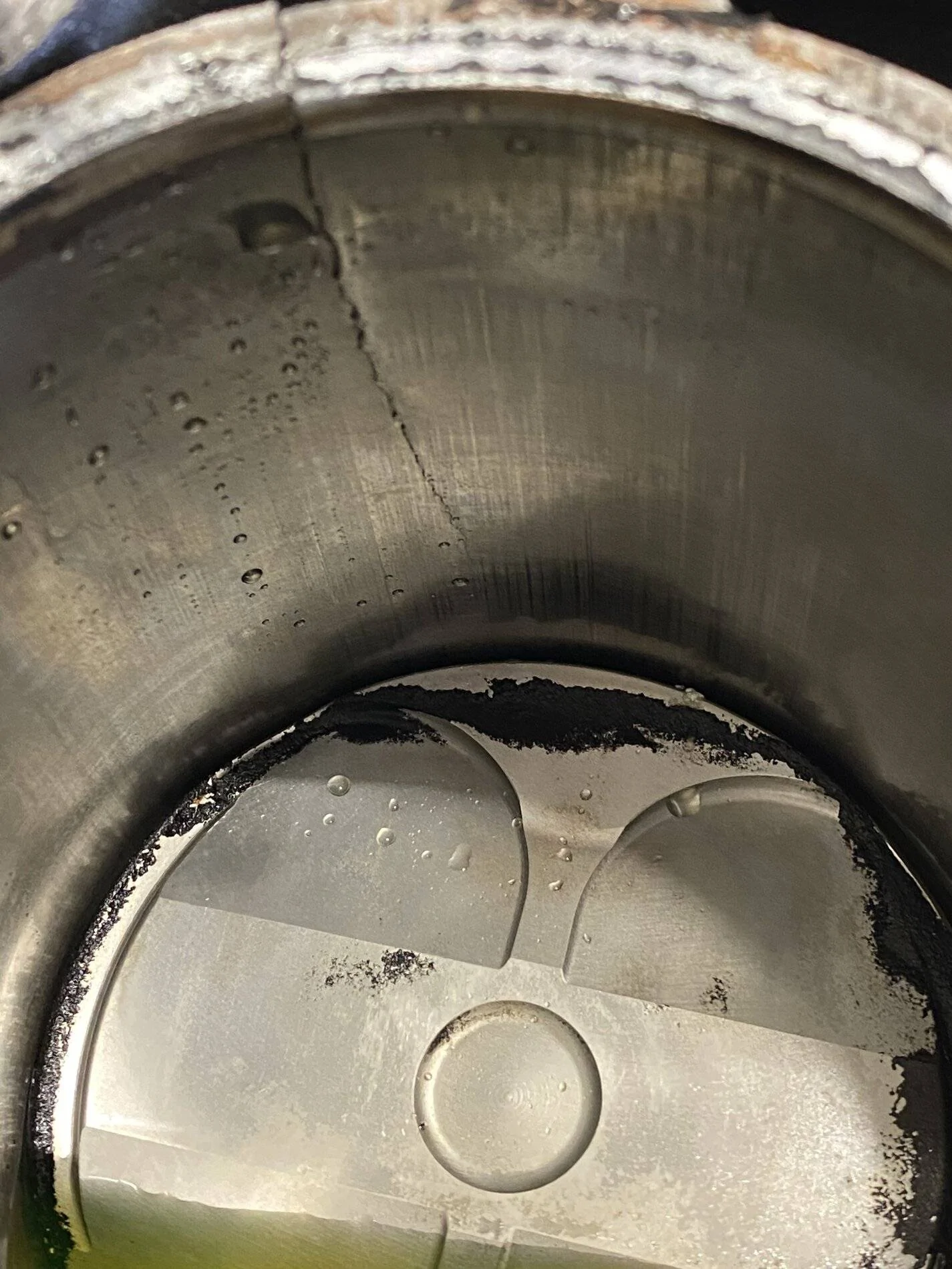

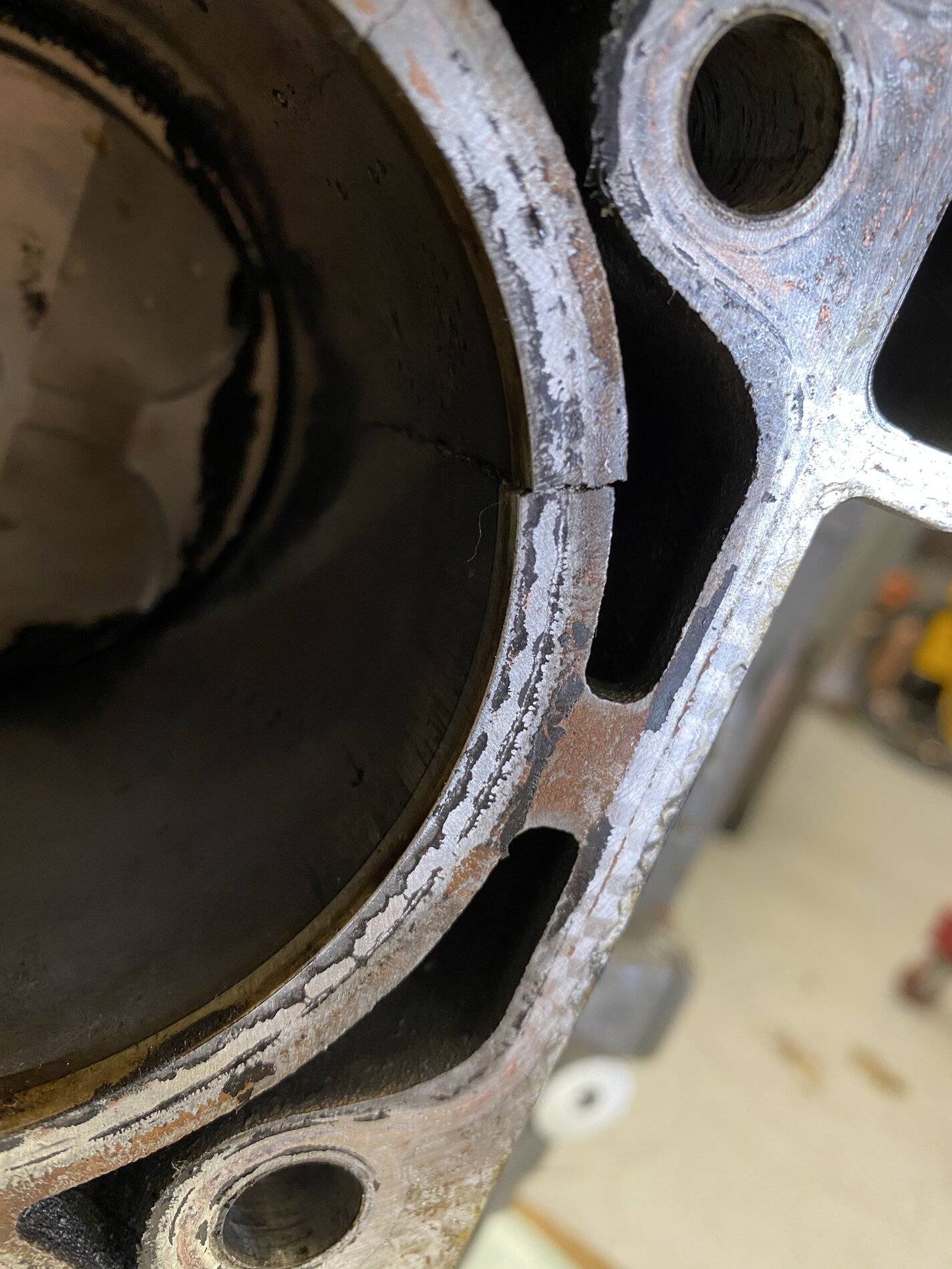

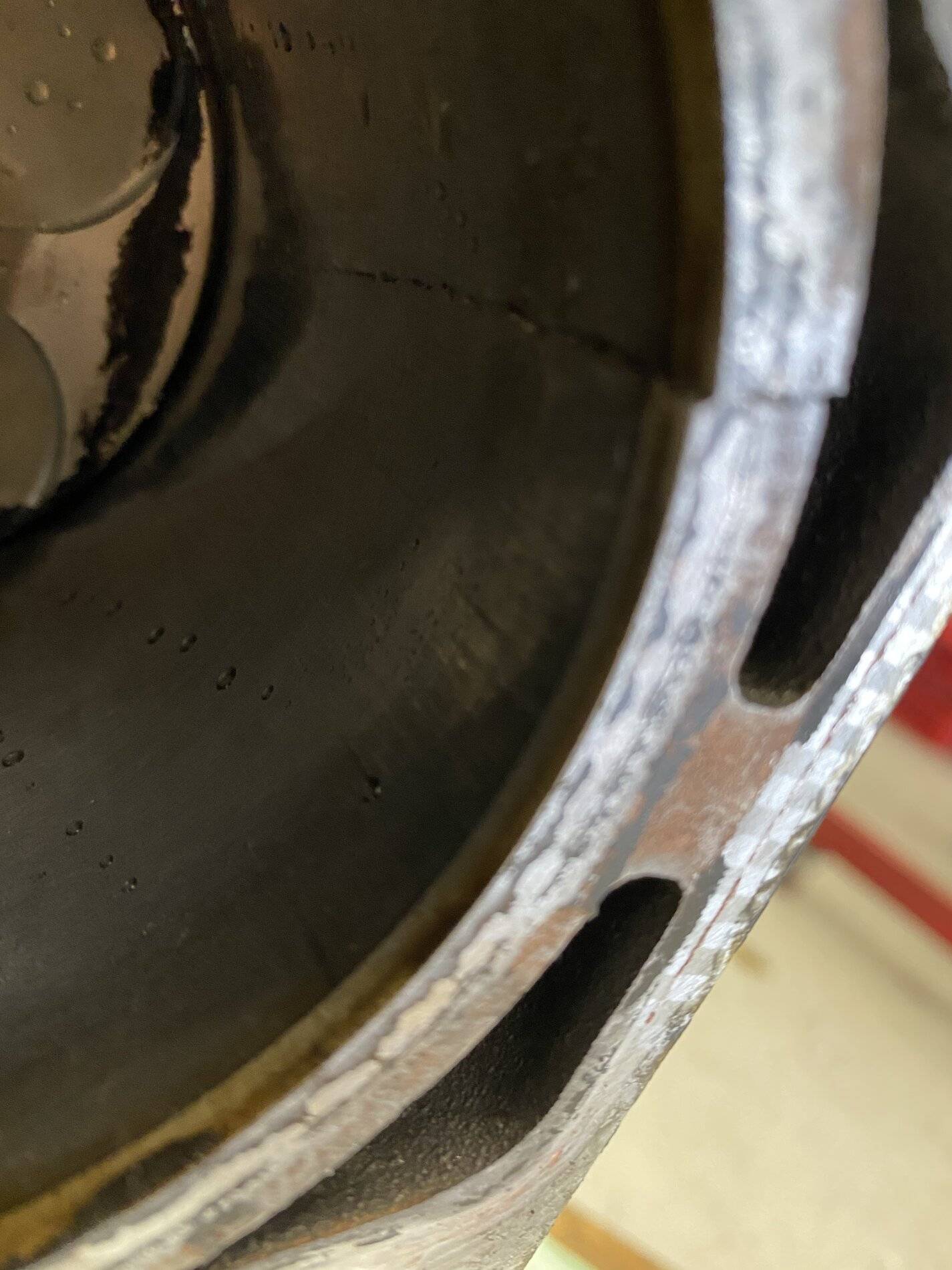

Gen 3s are not stronger blocks. Take that theory and throw it out the window. This issue had NOTHING to do with head bolts. Head gaskets were perfectly fine. Cylinder pressure (knock creates tremendous pressure) over and over and over caused this. I have checked my logs and have occasional knock nothing major and I am not pointing finger at tuner as this is a stock block and fine for N/A but not recommended for high boost/HP it is a chance I took and lost.
As far as beefier head bolts yes the Gen 3 is better. But we are talking about blocks here. Car was in a WOT pull between 950-1000whp and let go. Cylinder 2 said adios.

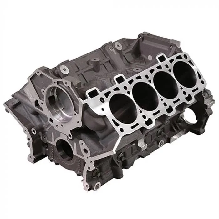

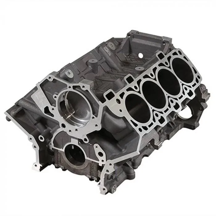

Gen3 and Predator 5.2 this block some say is good to 1300 WHP (Predator) and side by side you can see why. Dont need sleeves.
Got damn it lol.. everytime I think I have my mind made up.. I see some bullshit lol. Sorry about your motor man. That's why I'm asking so many questions. Sometimes the same question twice. So the bottom block is the 5.2 block? I was told you can't add cylinder supports to a gen 3. Is that correct?
