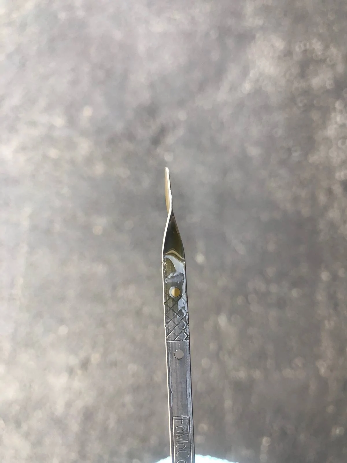

Yes it all the way down the bottom picture.

No actually the opposite. Based on the picture it looks way overfilled. But per the OP comment he forgot to wait and re-wipe to verify the level. Hopefully its within range (Between the two holes).
Per the 2020 Shelby Manual
It looked to me like the two oil level holes were clear along with the OP stating the oil level was way low. I could be mistaken.

The bottom hole on the dipstick should be full of oil. The oil ON the dipstick is irrelevant.
agree, but on my iphone, both holes look empty; in fact it looks like the almost black oil is about 1/4” below the bottom hole. Maybe, I need to look at the pic on a lap top.
I see what you mean. Either way it’s a false reading since he didn’t wipe. But to me at first glance it seemed like there was a high concentration of oil above the dipstick top hole. Normally there is only a smear of oil towards the top then it gets really concentrated towards the bottom where the two holes are to give out the reading.
Looks empty to me

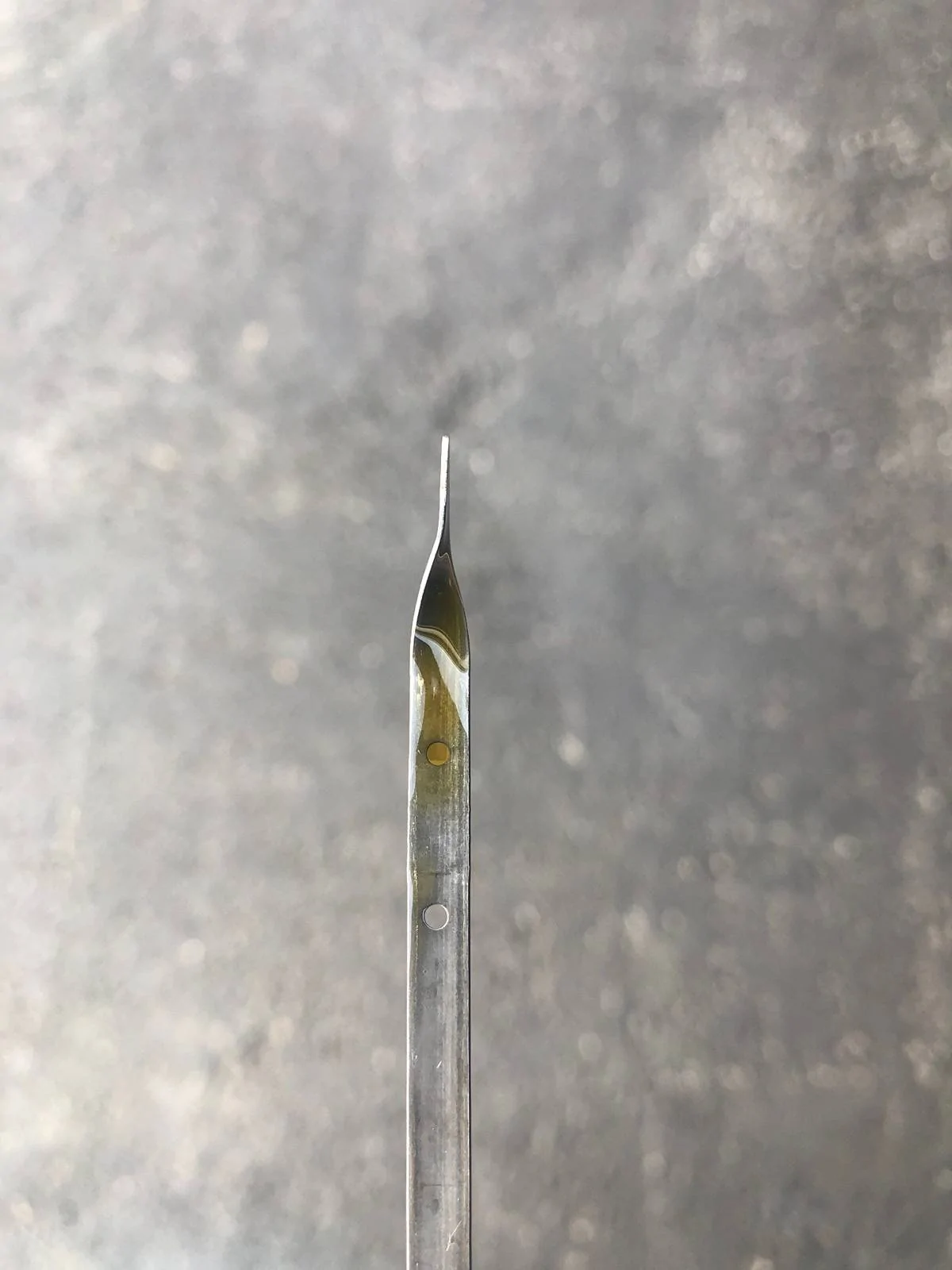

Update: Took it for a drive, felt normal/strong. Took it back, waited 15 minutes then properly checked the dipstick, images below. Equal on both sides. Haven’t changed it in almost a year, done about under 3k miles since. Getting it changed Tuesday. I’ll attribute it to a random hiccup or bad gas. Thank you all who replied.
