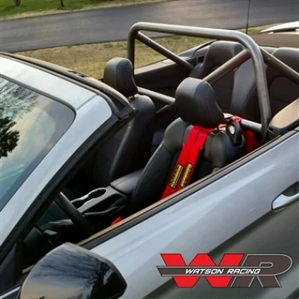

or something like this:
Which is functional, but you can see how it would cause some issues for rear seat passengers.
Like I said, I'm more interested in the second one.

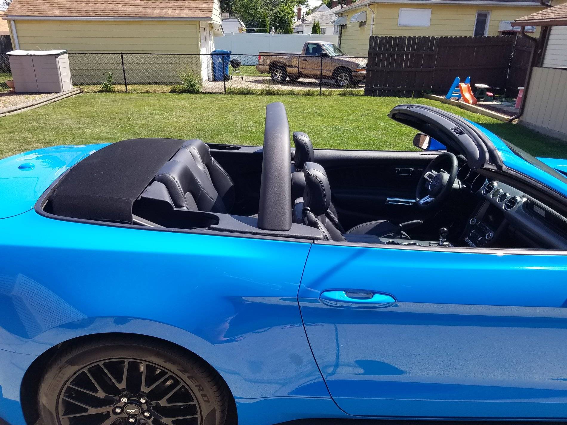

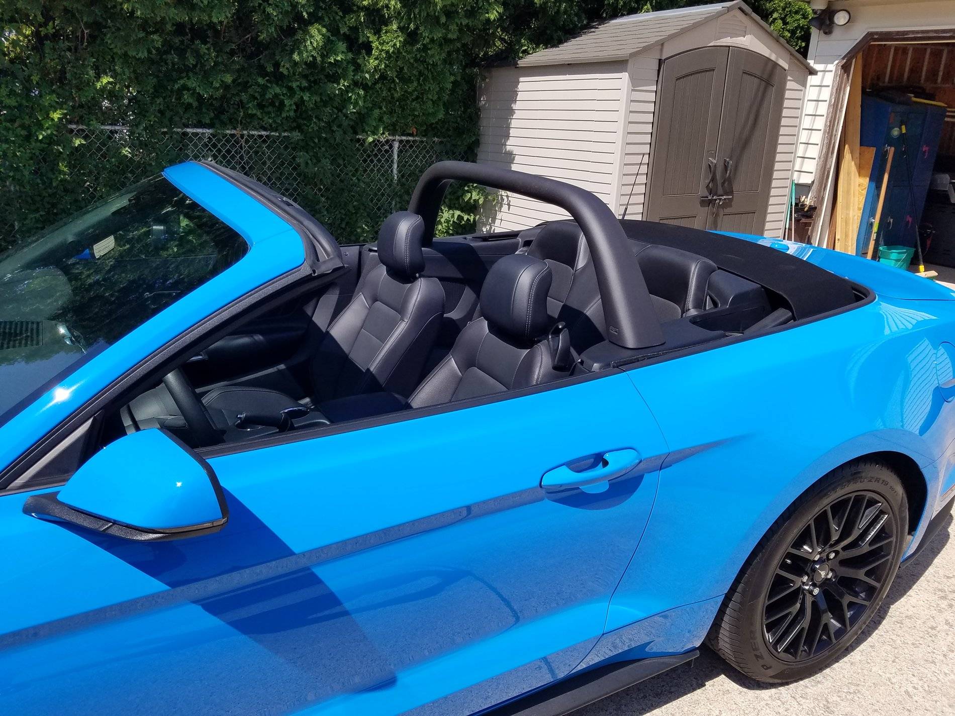

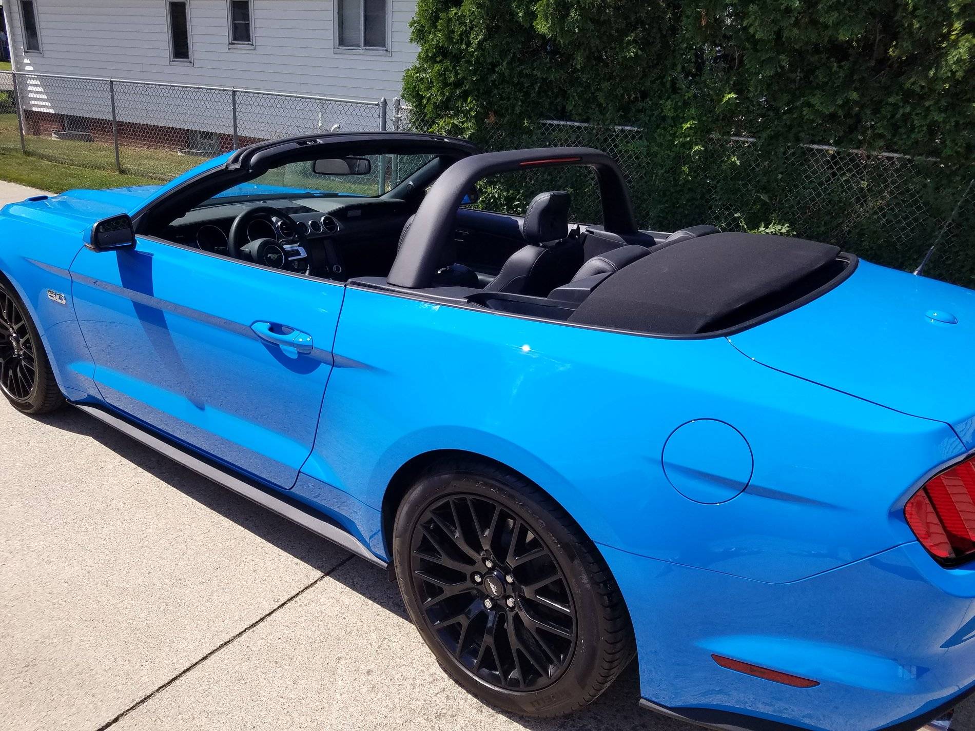

For the op, I put one on my 17 vert back in 17 a few months after I got it.

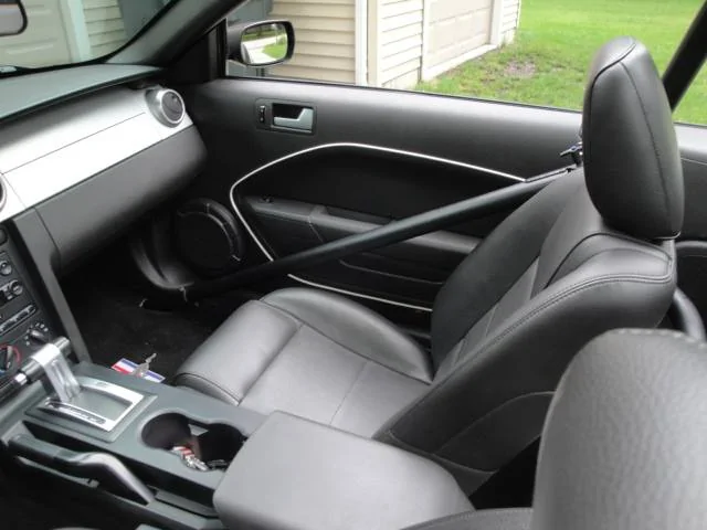

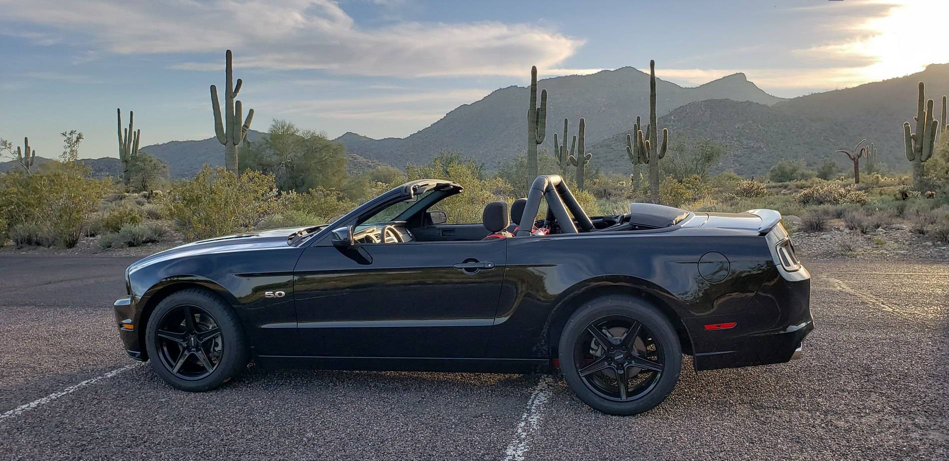

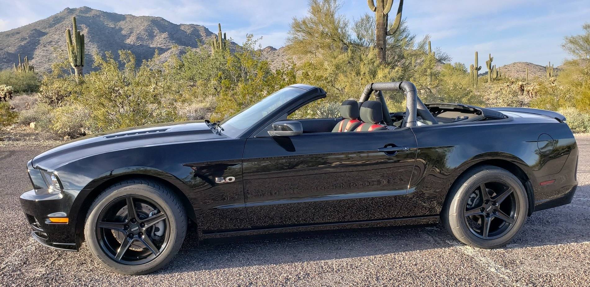

S197 obviously but this one is the Maximum Motorsports 6 point (has the high mount door bars also/not installed in these pics), and 5 point harnesses. Yes this kills the street-ability. Seat swap coming soon. I wonder when they will offer one for the newer cars?
Function over form?
https://www.maximummotorsports.com/roll_bar_crash_test.aspx

You could have one custom made. I did for my 2006 so another S197 (wouldn't fit the S550 due to the changes in the platform). I had swing out door bars on it and could remove those easily for daily driving.

Who's kit is that? I like that the main hoop runs outside the rear trim. The MM hoop runs inside the rear trim which can look cleaner, but requires heavy modification of the rear trim pieces to make it all fit especially with the harness mount bar. The MM kit has bolt in door bars that are still NHRA legal, and I leave them out on the street typically.
Another option outside the kits is to have a chassis or fab shop build something custom. Just make sure whatever they build is going to pass tech at whatever track/series you run in.

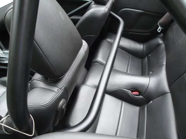

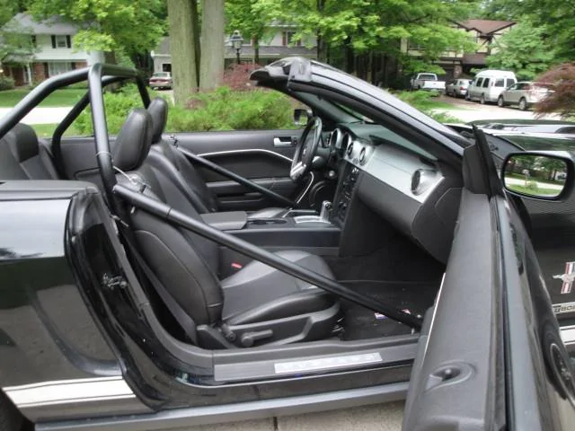

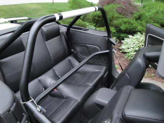

It's not a kit. I had a local guy in Michigan build and install it for me. One of the requirements I had was that it not go through the rear trim so that I could unbolt it and remove it if I needed to use the rear seat. And I never had any problems with tech inspection at any track.He did a friend's Mustang first, and that one went through the trim so we looked at some other ways to install without doing that, and modified the rear support bars because the original design didn't look right when I changed the main hoop mounting.
After it was installed I decided I wanted to add the stripe to match my car. That was fun, in my driveway, had the car and interior covered with plastic sheets so that I could paint the white stripe.
Unfortunately he is no longer doing custom work.
