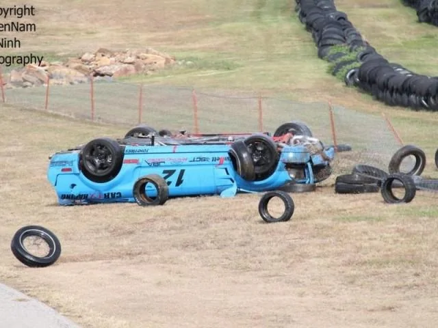

I would stick with Watson. They do the Cobra Jet cars and I would trust them. This is a post I have seen a few times without mentioning names:
"Personally, I'm not a huge fan of XXXXXXX bars. It seems to me like the backing plates are not large enough to keep the bars from puncturing the floor pan in a rollover situation. Here is a picture of a mustang with an XXXXXXXX bar that wrecked at my home track, Hallett. Luckily the driver walked away without injury but I'm not sure how. I realize this could have been an installation error but I've never been too comfortable with these bars after witnessing this...
Here you can see the main hoop bars poking through the floor pan"

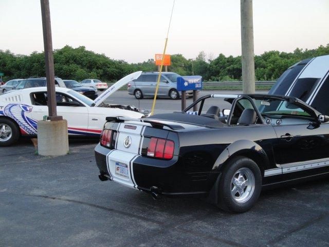

You should not have passengers in the back seat with a roll bar. Hard metal close to unprotected heads is not a good thing.
I had a custom 6 point roll bar made for my 2006 by a local guy. Cost me about $1,000 installed.
For drag racing you need a 5 point minimum if your convertible is quicker than 13.49 in the quarter mile.

That looks pretty nice!
I am trying to think up something thats good for 8.99 and quicker but also have functionality like yours. Sounds like you got a great price as well!
