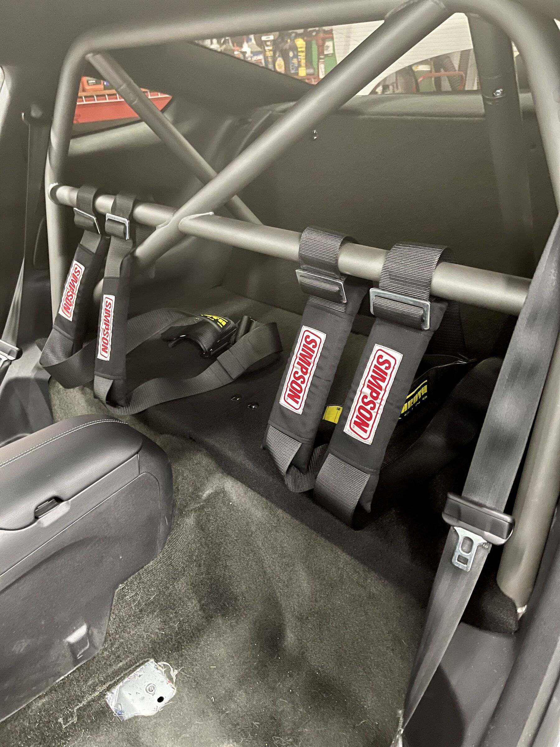

Just looked at their instructions for this kit; If you go with the 4 point there is no drilling correct? At least that is what I am seeing? It looks like with the 6 point you have to drill.

Great pictures. I like that rear seat delete kit. It looks like it came as a factory installation. Perfect.

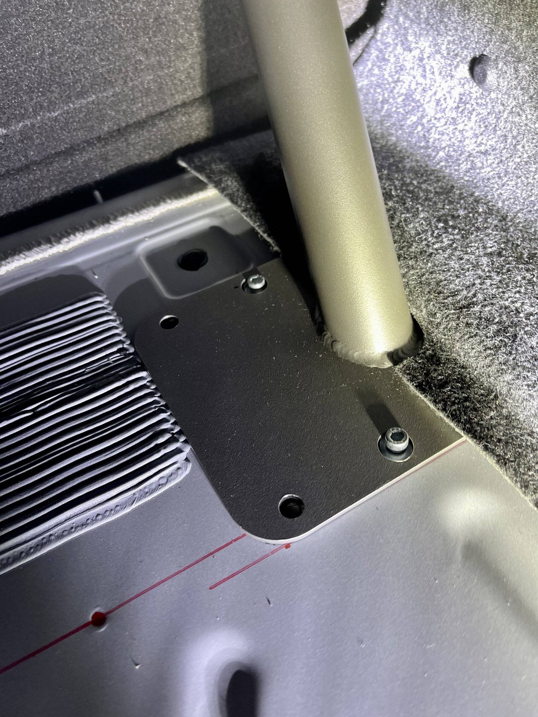

You have to drill through the trunk floor, twelve holes, to mount the rear plates.

yes you have to drill 12 holes, and they have to be exact, no room for error, but its not bad i will put a pic up of the plate install

here was during the process

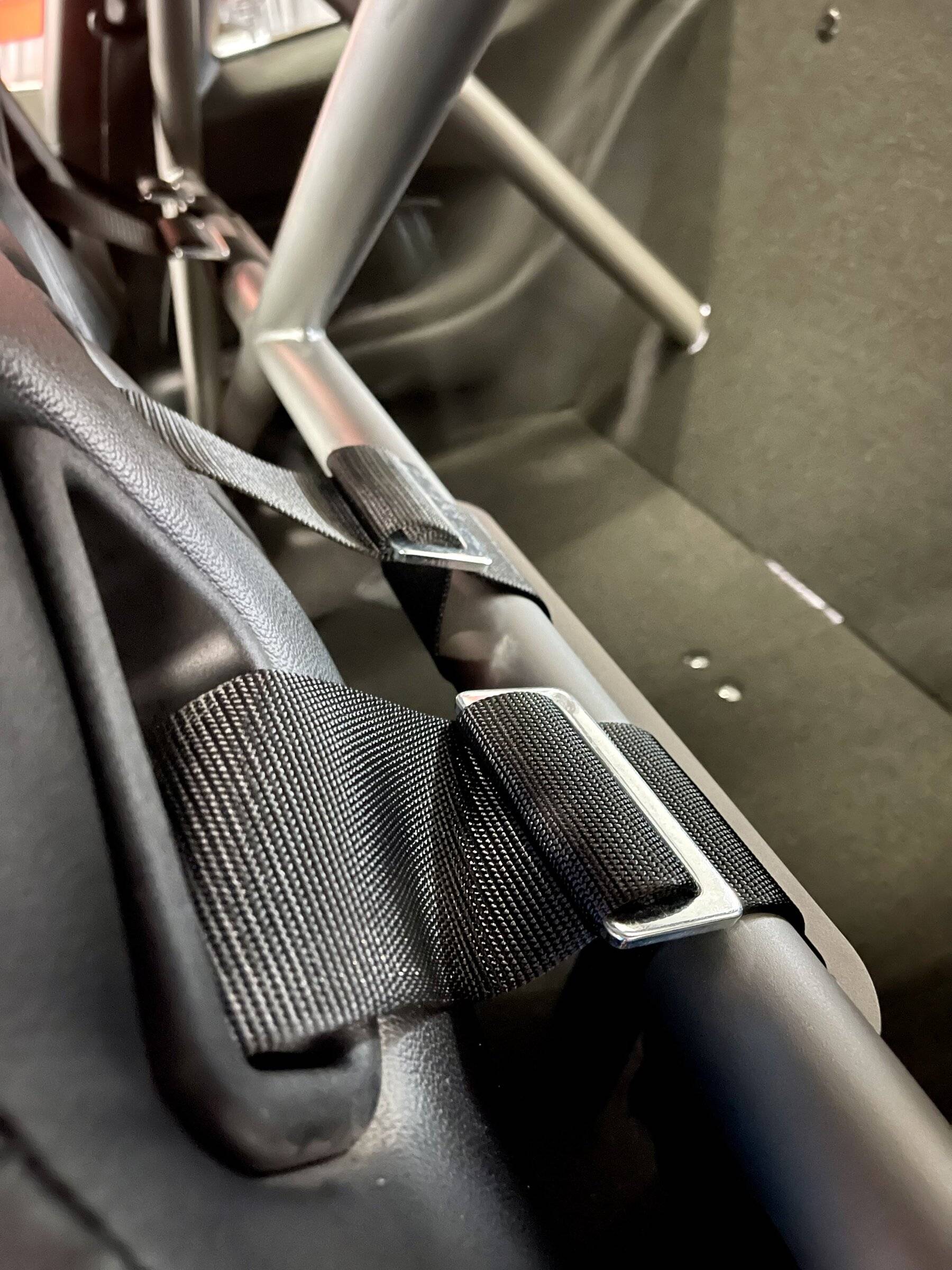

I went with the same and love it. Such a clean finished product.
For anyone trying to do this on their own, check my YT for an install vid.
