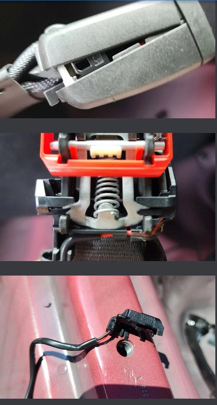

Those documents were written in 2020 and 2021 respectively, could explain the year limitation. I did a RSD on my 2023 and I just simply removed the sensor from the seat buckles and taped them to the harness that runs under there. I’ve never gotten a single alert about backseat stuff.

How hard is it to remove the sensor from the buckles? Can you put it back?

That was 3 years ago so I don’t remember. I wouldn’t plan on them going back together easily. You could probably scoop up a used pair on eBay and preserve yours.

This is a good idea, thank you for sharing
