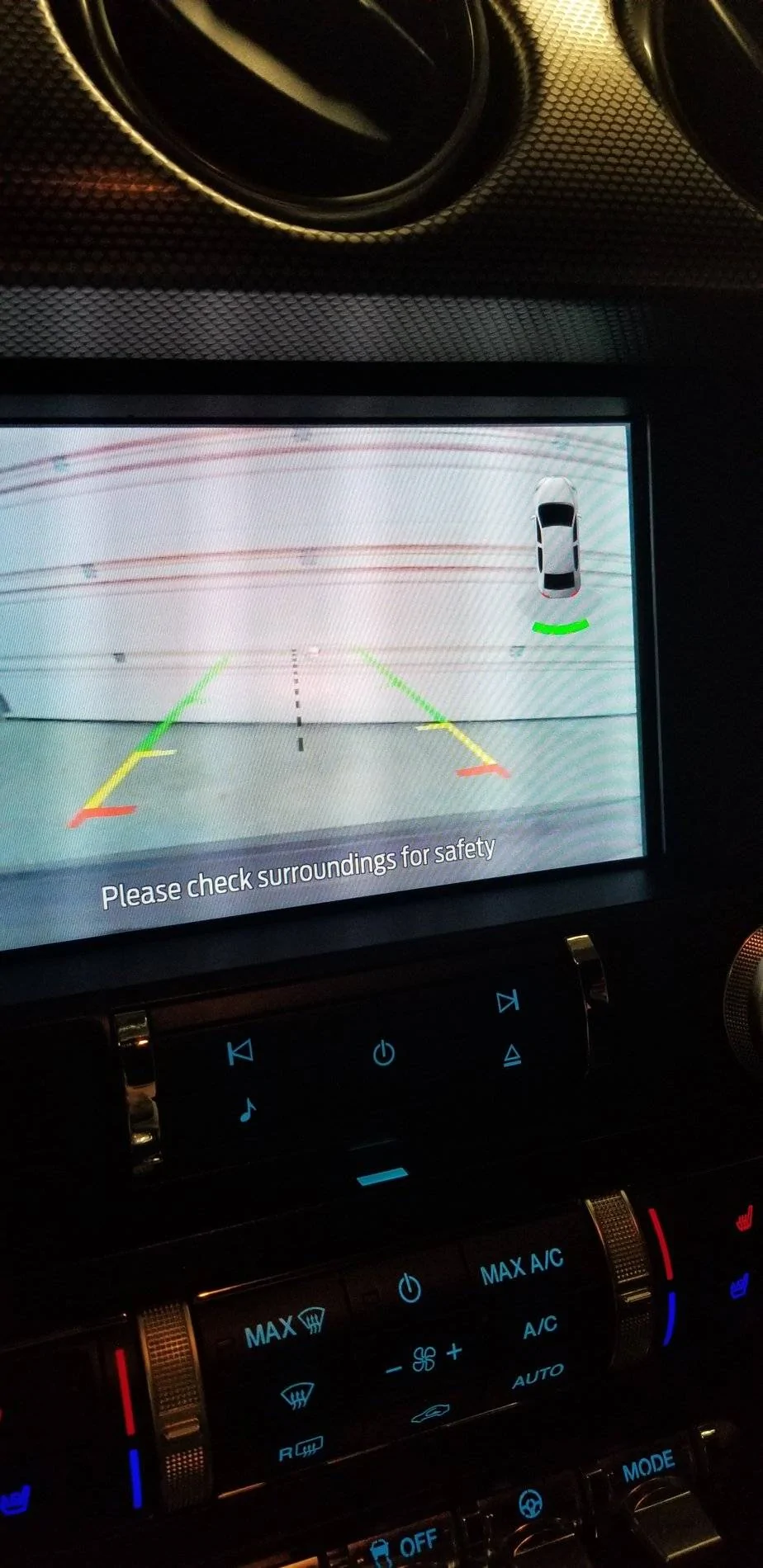

Okay, so from the help of Sam at Hellhorseperformance I got these lines underneath my 2D vehicle added onto my rear view camera which I used to have on my 4inch radio. Switching over to Sync3 8 inch display made me lose them until I went and changed my 0 to a 1 in this line of code for FORScan
7D0-04-02 xxx1 xx
Its in the AsBuilt data for APIM.
Heres a picture for anyone wanting to see what I mean by "sonar lines" Ford calls it object detection.
