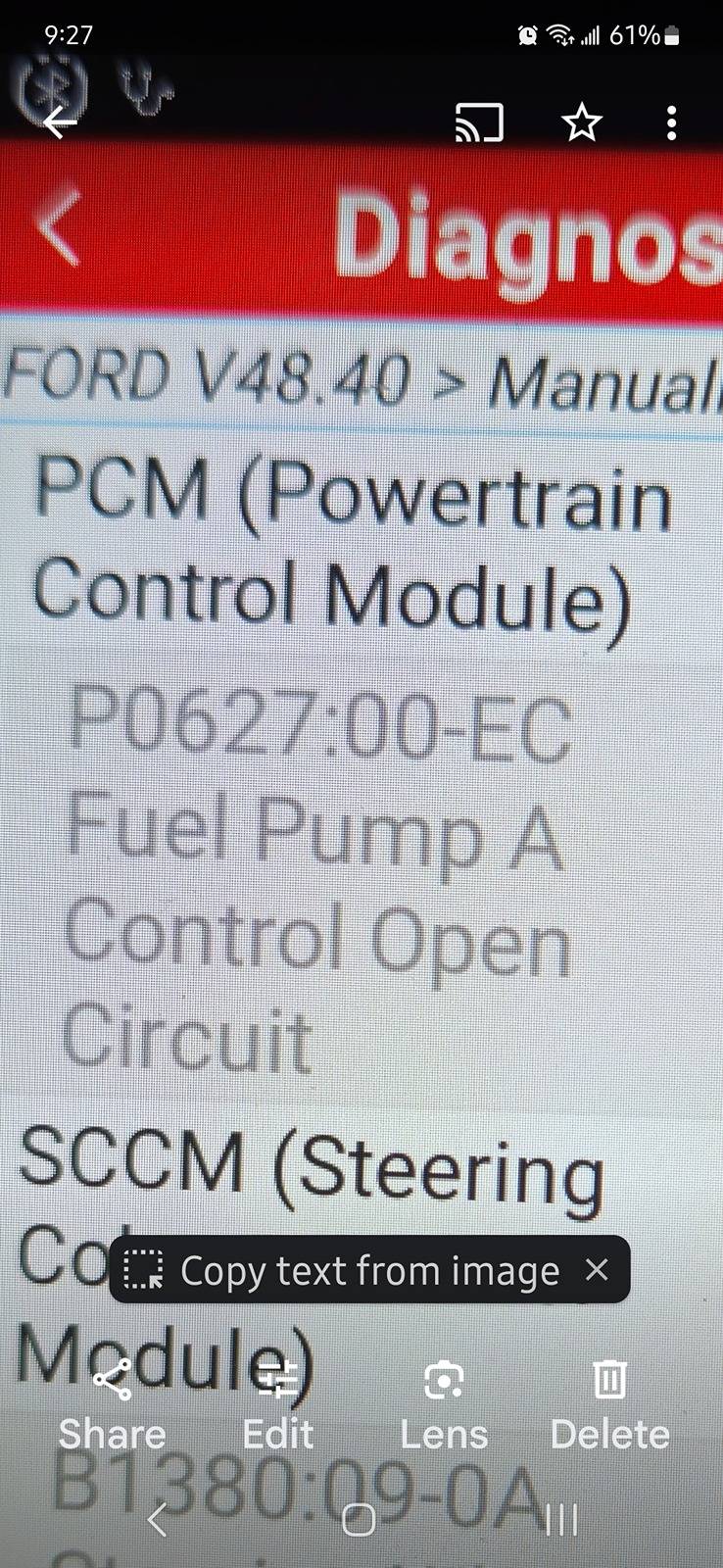

I got a Fuel pump fault and David from KPM said to have tuner turn that one off for with his system that fault code is irrelevant.

I have driven for a couple of hours in stop and go traffic, and freeway 70ish mph and. Numerous WOT letting my car shift at redline with my A10. I will take to dyno after I get my alignment done later this week due to steeda dual rate springs and front camber plates I installed. Opinion/issues so far.
- I cannot hear pumps running
- Had to ask Wengerd to turn off pump A fault code.
- Engine took 2 trys to start 10 minutes after I turn it off.
** Even though KPM said their systems have a check valve, I installed a radium high flow check valve before my filter real close to tank under car. Engine fuel pressure gauge still showed 70psi fuel pressure 3 days after my last engine start. Started right up, no issues.
