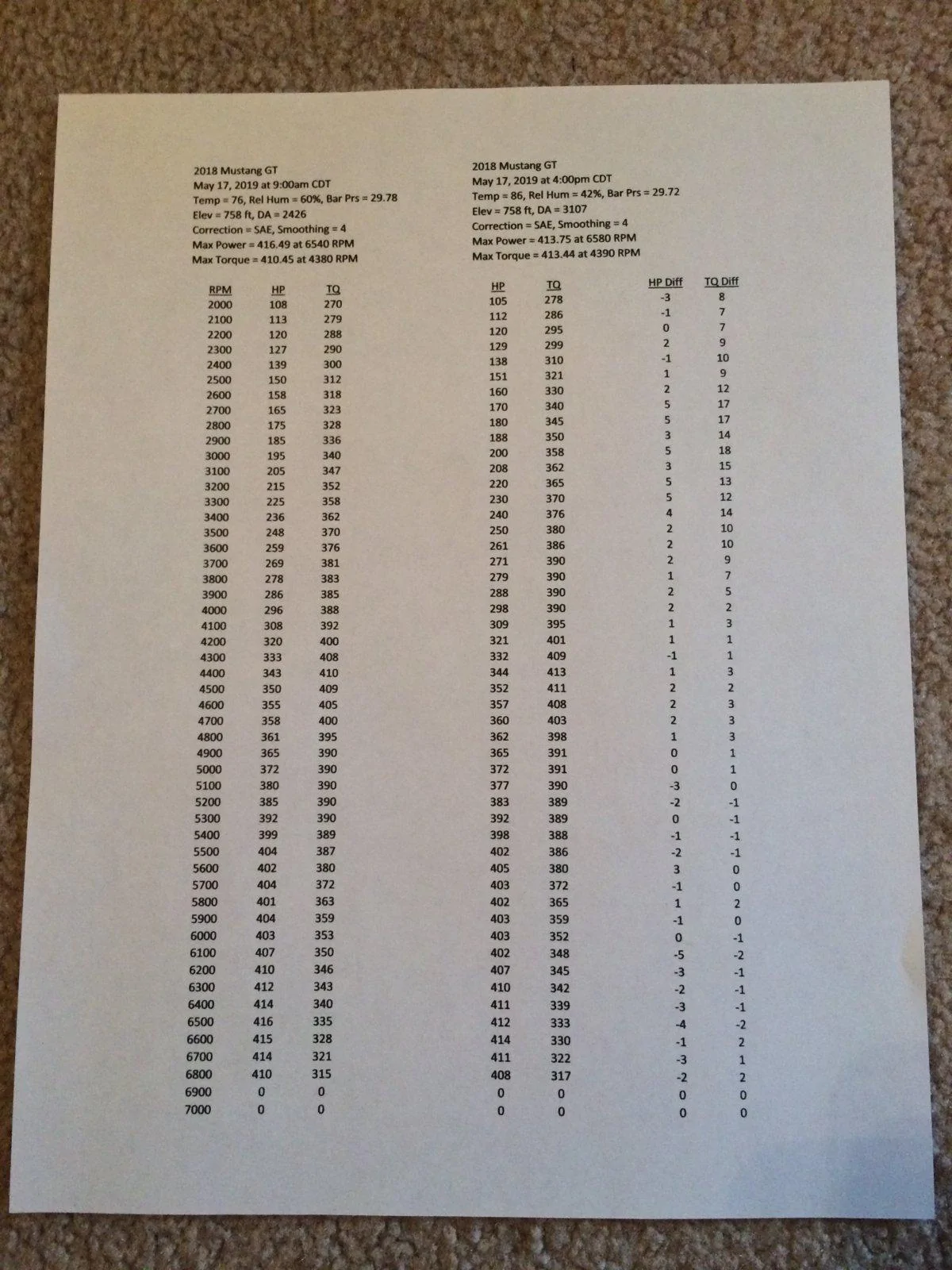

Love the sound of the Steeda H-pipe with active exhaust. I only hear a little drone in Track mode. Sport mode is perfect. You won't see much in performance gains, but I did pick up some minimal torque gains under the curve from about 2000-3800 rpm. Wish someone would do the same for an X-pipe just for comparison purposes.
