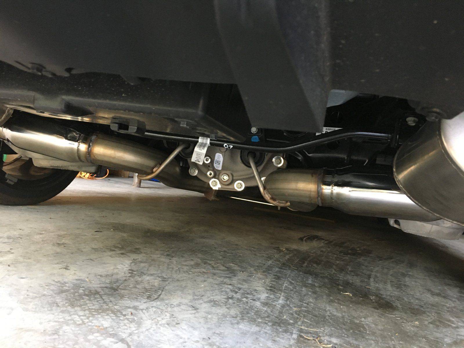

AZ18yote
Nov 24, 2017
3,221
1,531
Arizona
Bryan
2018 Mustang GT Prem PP Magnetic
Check out Vibrant bullet resonators. I used a pair to calm down my ARH LTH with direct connect to Corsa Xtreme. Could also be an option to consider.

Where do the resonators typically go in the exhaust? Right behind the h/x pipe?
AZ18yote
Nov 24, 2017
3,221
1,531
Arizona
Bryan
I fit mine right past the mufflers before the double x. Was based off of these:
