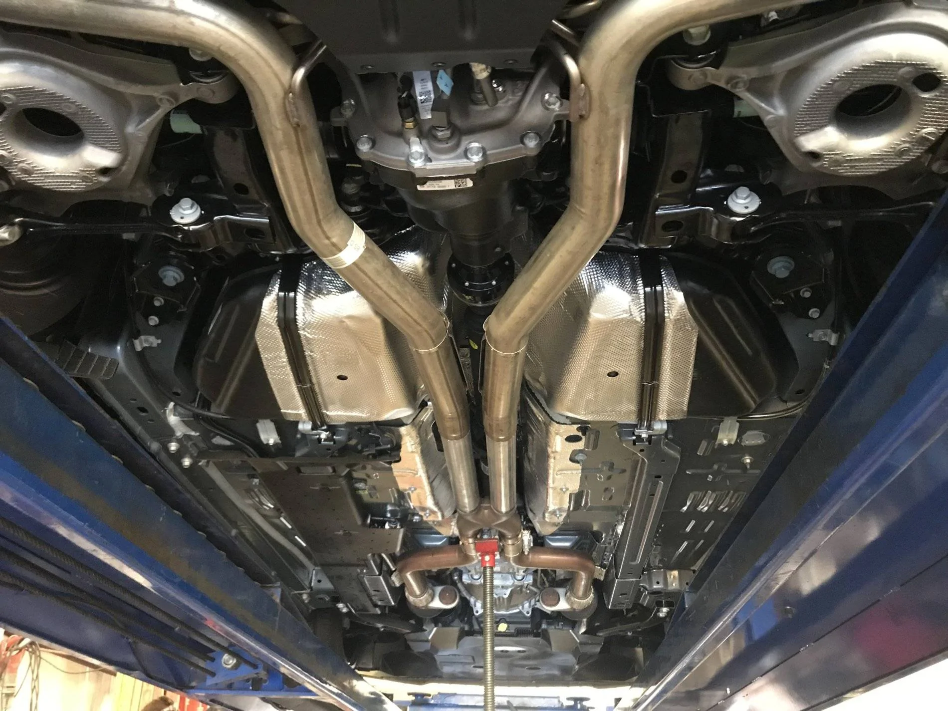

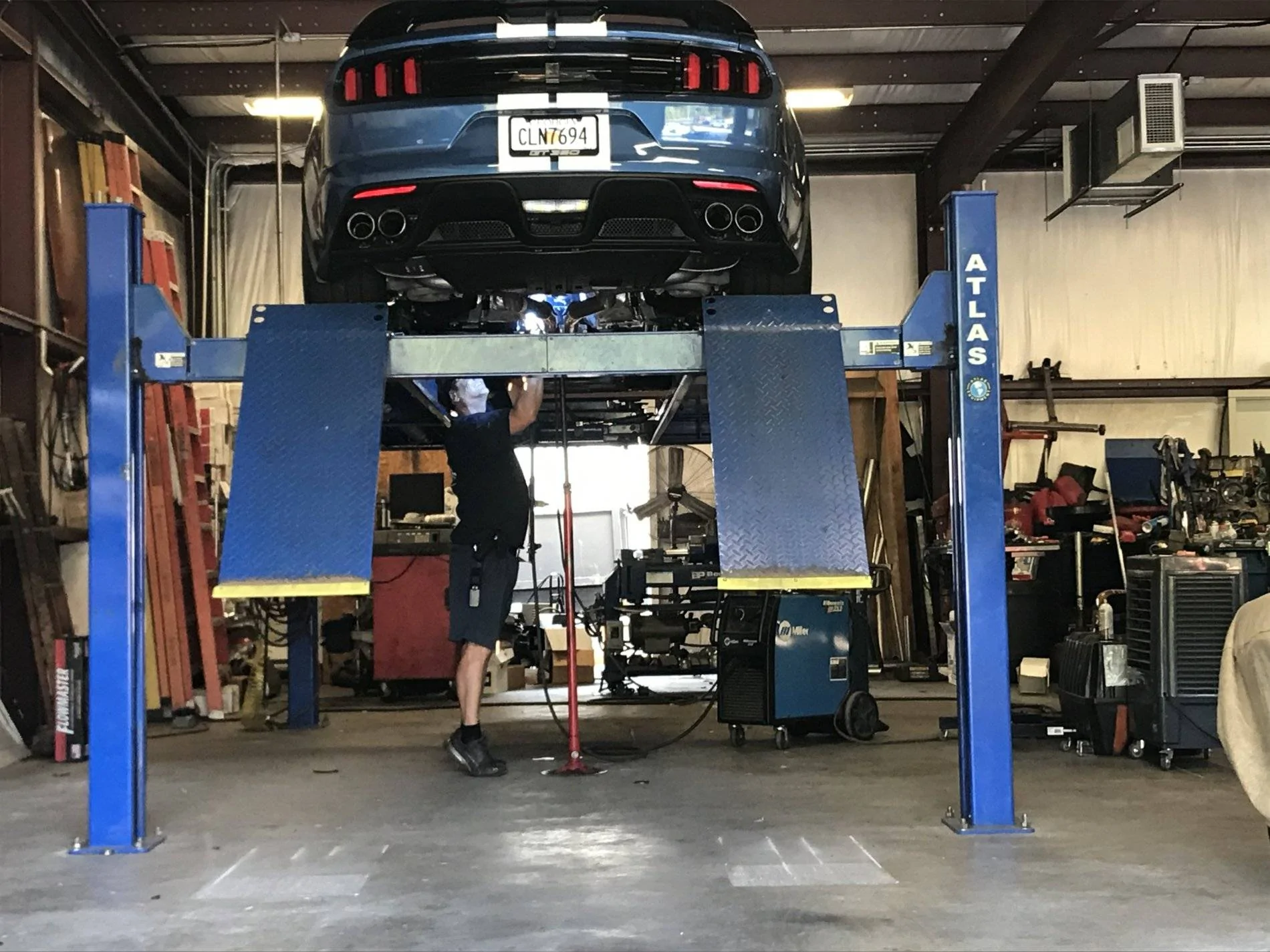

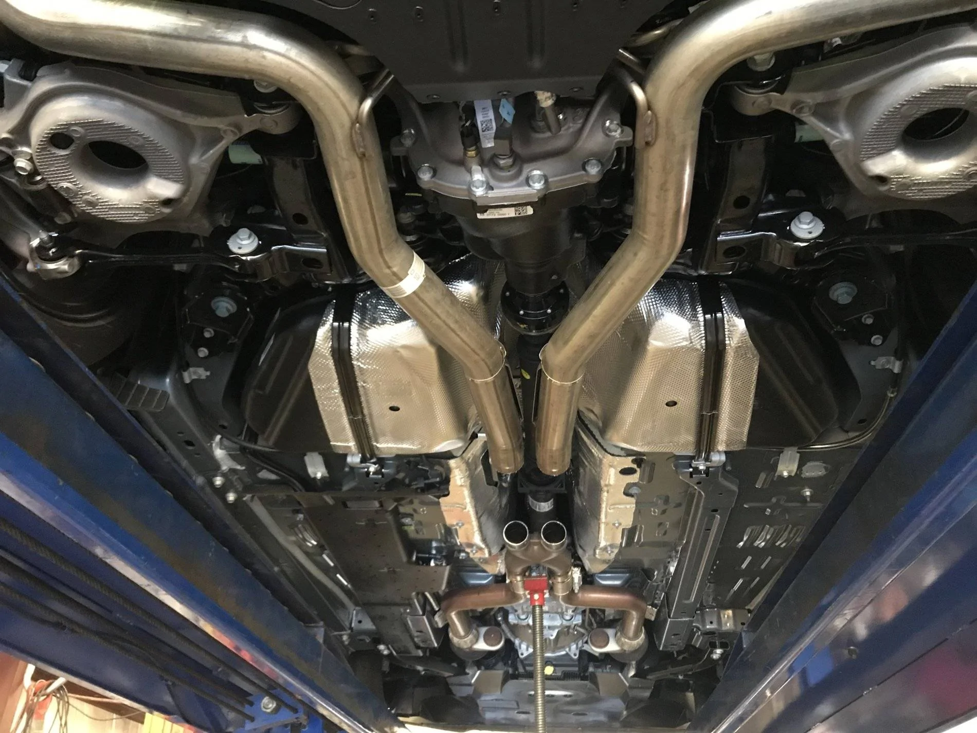

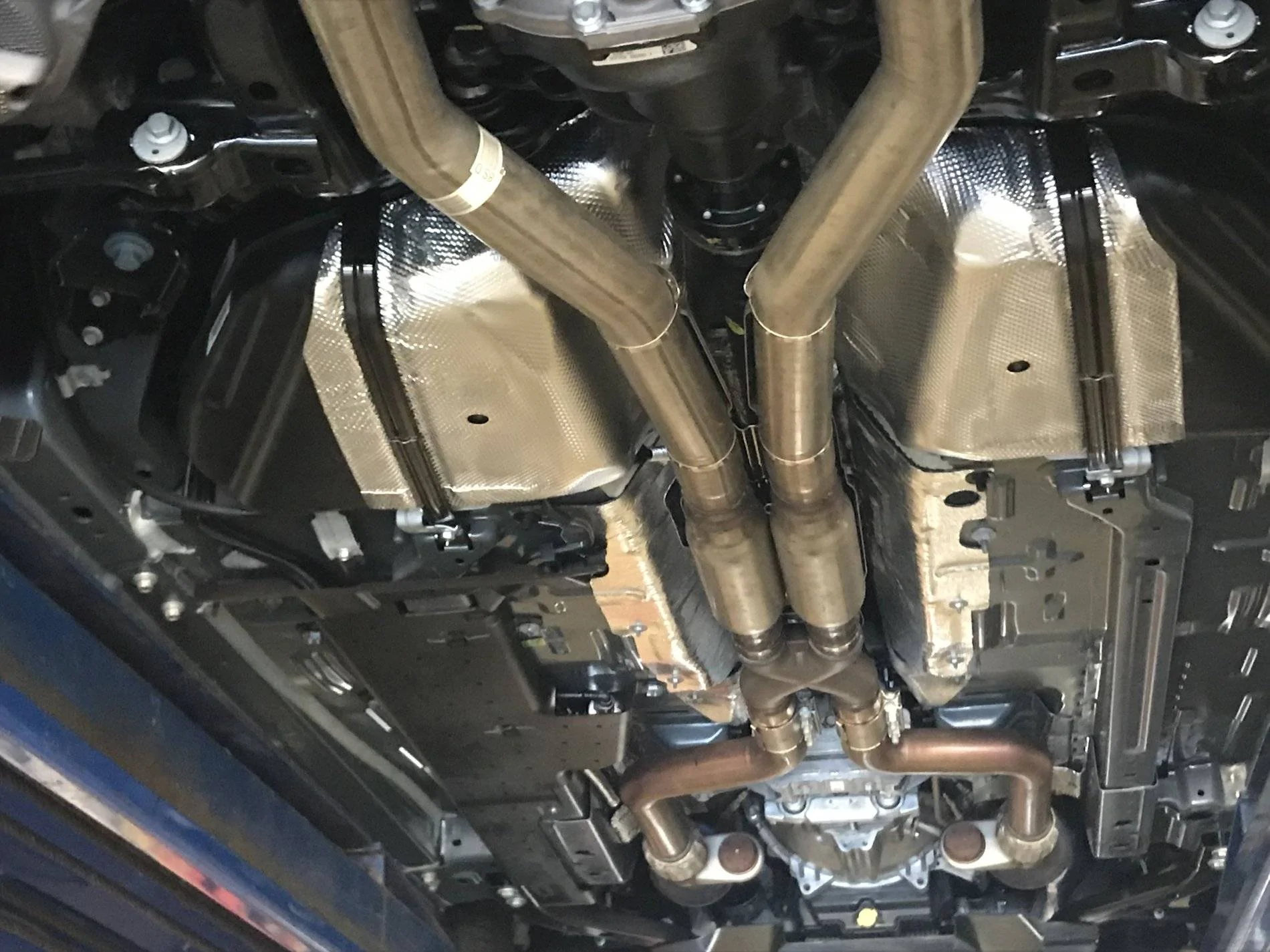

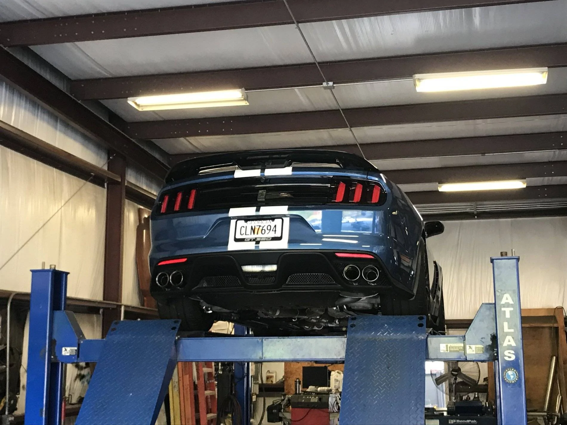

Hey dpAtlanta, great pictures! I like the way you did your delete. Did the muffler shop open up both ends of the two pipes to slip them over the OEM pipes then weld? Curious why you did not remove the heat shield from the back portion of the OEM pipe to prevent rattling, and/ or reweld the entire heat shield back on the deleted portion? Have you seen any performance issues, loss of HP/torque? How's the tone comparison (before and after)? Any droning at cruising speed? I was going to do my delete using a replacement 3" X pipe but now I might go the route you have taken.
Sorry for the late reply… I had not been back to this thread since I posted.
The shop slipped the pipes over the factory pipes and started welding;
I don’t remember if he flared the ends before installation.
The heat shield was removed. He cut it off and it was scrapped. It can be seen in the 2nd photo, and it is missing from the 3rd and 4th photos.
I have not noticed any performance improvements.
The exhaust note is the same in quite mode which is rarely ever used; it has a more aggressive tone with more burbles and babbles on deceleration.
There is ZERO drone what so ever…!!!
Two years and 31,000 miles later, and I have no regrets. The exhaust note on this VooDoo kept me from putting a deposit down on a 2022 718 GT4 last month.
