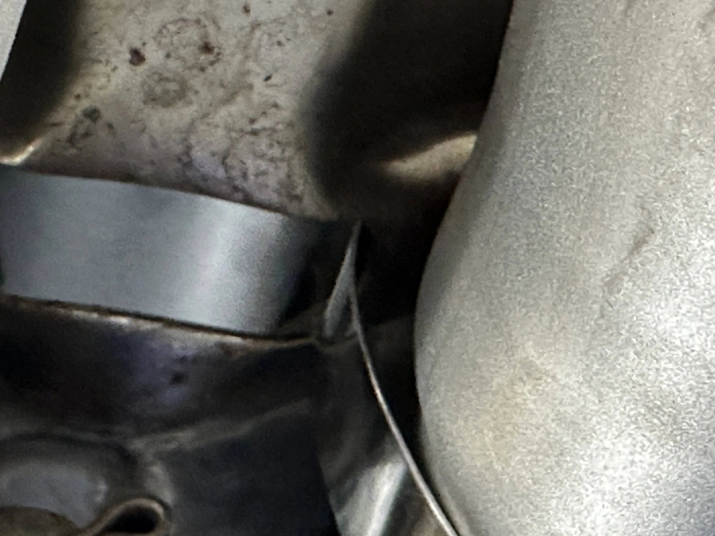

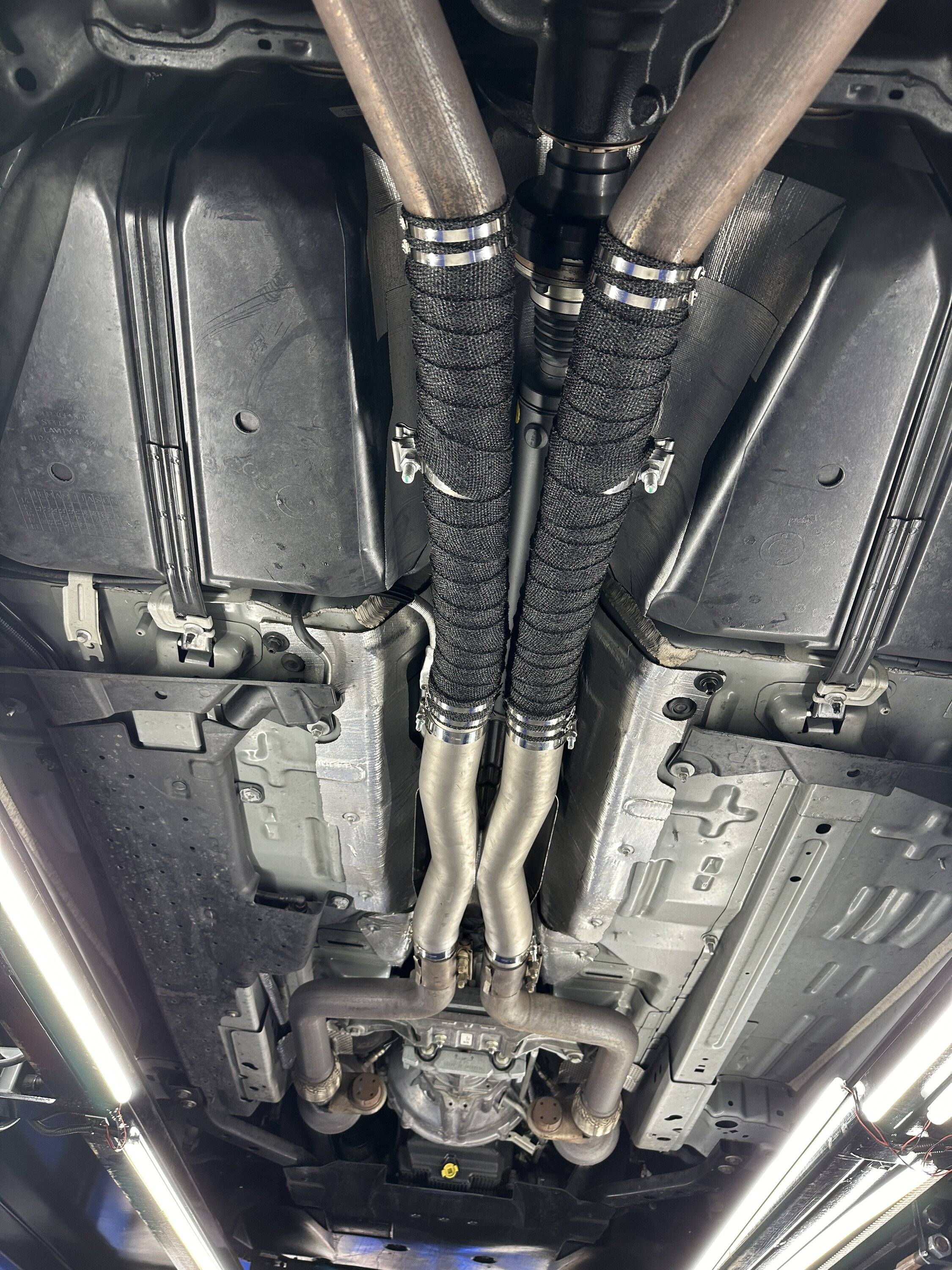

So I attached the heat shield using t-bolt clamps (and trimmed the bolts) then wrapped the remainder with header wrap.
Second thoughts:
1. I should have wrapped first then attached fwd heat shield. This would have allowed me to use the aft t-bolt clamp to secure the wrap vice the ss straps.
2. The fwd heat shield clamps are not flush with the pipes b/c they clamp on the ‘necked down’ portion of the LTH section.
Wrap first then clamp and slide the fwd heat shield aft an inch so the fwd clamps are flush on the pipes.
Hope this makes sense. I rattle checked it with a lead shot hammer but I am certain the fwd clamps on the heat shield will loosen as the shielding ‘self clears’. I will then buy another set of t-bolt clamps as the trimmed ones are now too short….and shift the shield aft an inch using the aft clamps to secure the wrap and the fwd clamps will be around the expanded portion of the LTH section.
