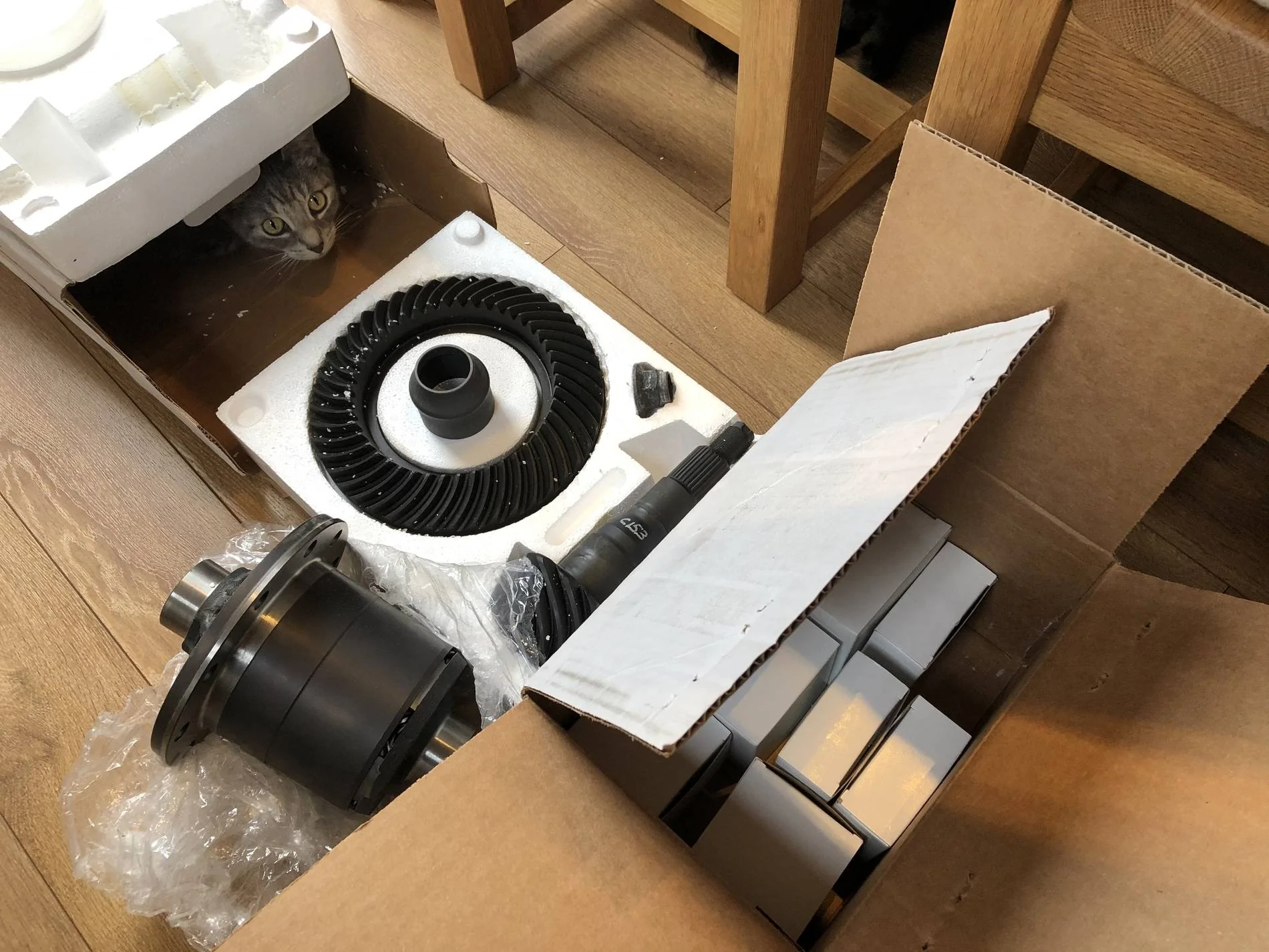

@Vlad Soare - separate items. So long as you buy the right kit, the gear and / or diff can be swapped individually. The fitting kit is also required :

Yes, and as far as I understand, while the diff itself is easy to replace and more or less plug & play, changing the gears isn't for the faint of heart. So I was hoping to avoid that. I was hoping that changing them would be necessary only if you wanted non-standard ratios, like 4.09, but not if you stuck to standard, factory ratios.
But I guess that's not the case, is it? Replacing just the diff would leave me with the same 3.55 ratio that I have now, wouldn't it?

Yes, but you would still need the fitting kit and I think you would have to set the backlash anyway as you are replacing the part the ring gear bolts too (introducing a different / new part with ‘potentially’ a different tolerance).

You would need the torsen diff and 3.73 gears to change the ratio. If you only got the diff you would have to swap your gears onto it.
Easiest way to do this is to buy a loaded 3rd member or pumpkin. That way all you are replacing is the center section. Too many ways to describe the same thing.
They come up on this forum quite often. Shipping will be expensive.
