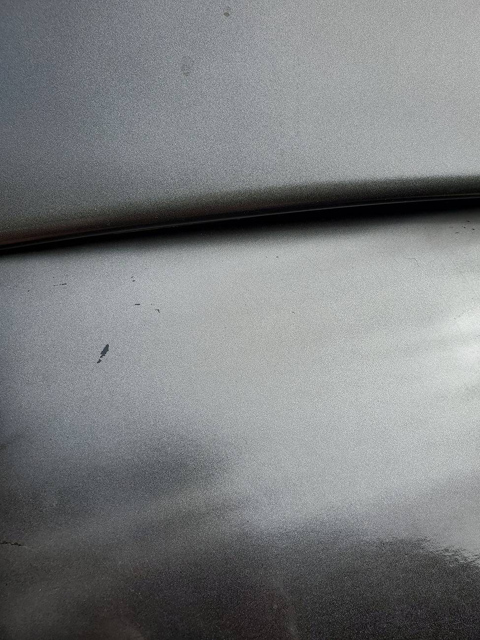

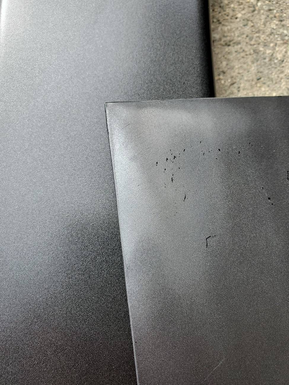

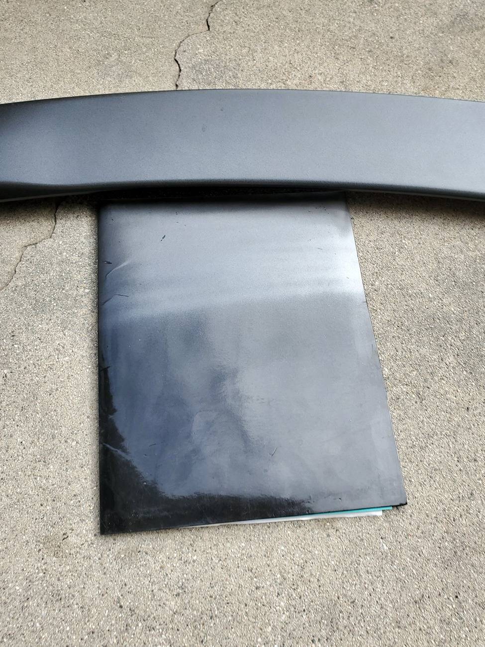

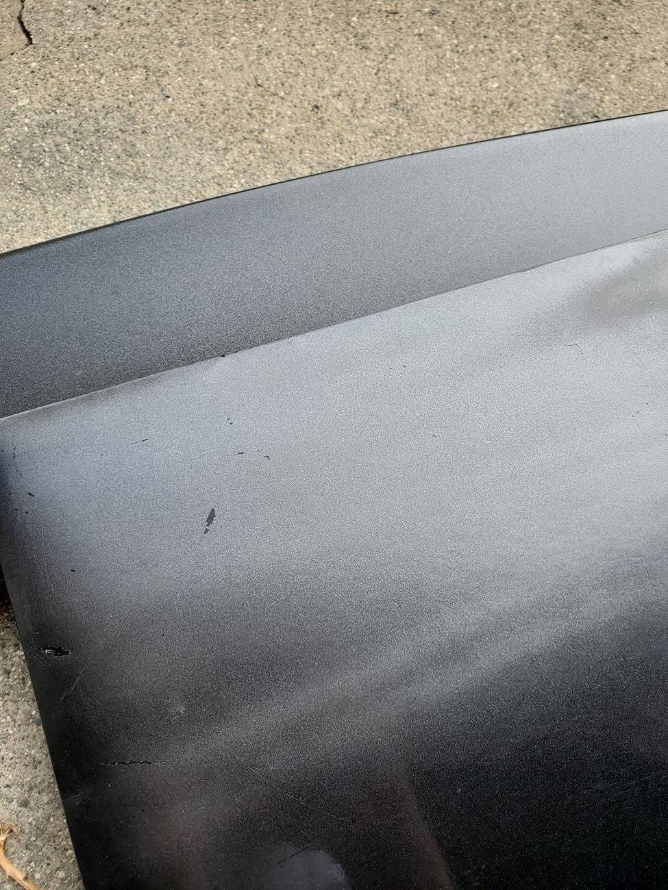

The closest rattle can I used as test sprays were Duplicolor BFM 0360 which is their match for 5FM6 from Autozone, this is VERY close to a match, I'm sure many people would be satisfied with it, I'm just not skilled enough to do this type of job on my own. Here is a spray out over a gloss back folder compared to the stock wing for color comparison.
Here is my thread on a professional repaint of the HP spoiler I bought.
https://www.mustang6g.com/forums/th...on-hp-car-color-matched-by-paint-shop.192583/
Now there has been big back and forth in determining the color for the wing. When I removed the existing stock spoiler there was a yellow sticker underneath it that says 5FM6, other people have confirmed this too. 5FM6 is Magnetic Metallic, it was actually used as a body color for a few years on the Mustang line.
