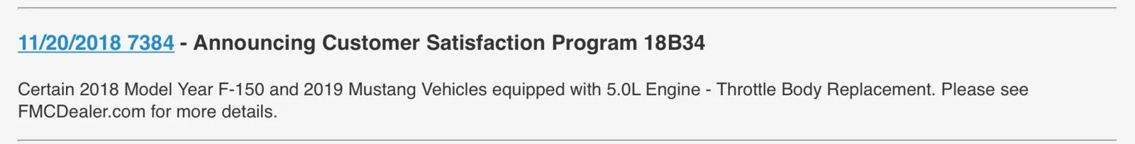

I’m not sure if what you were experiencing is related to a recent Ford Customer Service Satisfaction Program for some 2018’s to replace the throttle bodies (attached), or something entirely unrelated.
