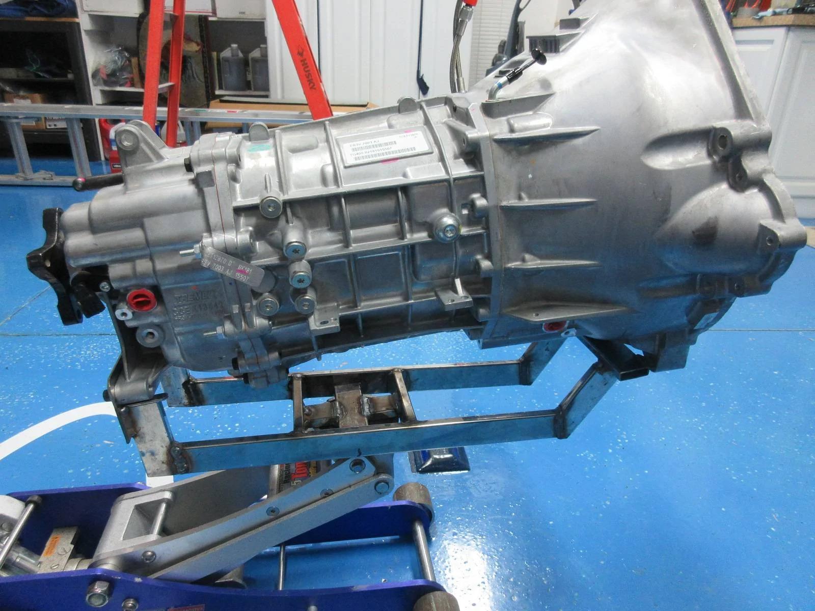

Before I did my TR3160 swap I took some time and designed this Trans Fixture, with some angle built into it. It worked great, I may consider selling it now.
But one issue is: After you remove the trans from the engine, the back of the engine angles back up and makes the trans install more difficult. What you want to do is while the old trans is still attached and the rear support removed, take some wooden blocks, and block the engine (around the exhaust manifold area), so the rear of the engine stays down. (Makes the re-install much easier)

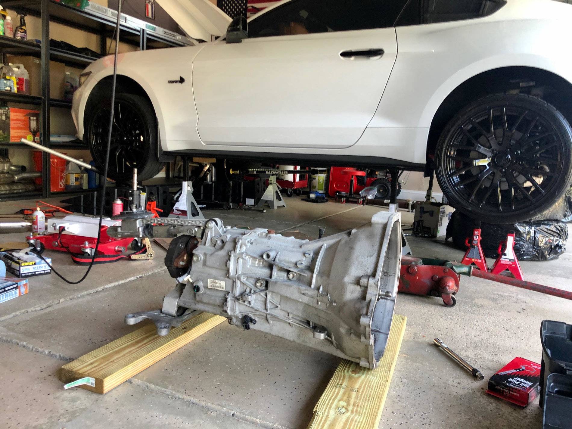

Here you go, it was a walk in the park but I had 2 other buddies and I used a trans jack from harbor freight. I wanna say it was right at 20”. I was able to leave the shifter on the trans, I also installed the new shifter while it was out and was able to get it back in with the shifter installed. I suggest the trans jack with at least one other person to help and at least 20” off the ground.
If you imagine that image being a red 1994 Cobra in place of your ride; that’s exactly the same Jack stands I have/use and how high mine was lifted too. Worked great for doing the clutch job (and another subsequent rear main seal fix later down the road).
It’s doable in a home garage or driveway with PROPER jack stands and safety measures, but as others have said, definitely get a trans jack for an S550. Pulling a T5 out of a Fox (79-95) isn’t difficult, but the T5 without the bell is at least 85-95lbs - doable without a trans jack. If you can’t bench or lift at least 85-95lbs to do that type of R&R laying on your back with only about 20” between you and the underside of the car, DON’T attempt it without a trans jack under an S550.
The S550 MT82 and Tremec appear to be much larger and most likely weigh a lot more than a small T5.
