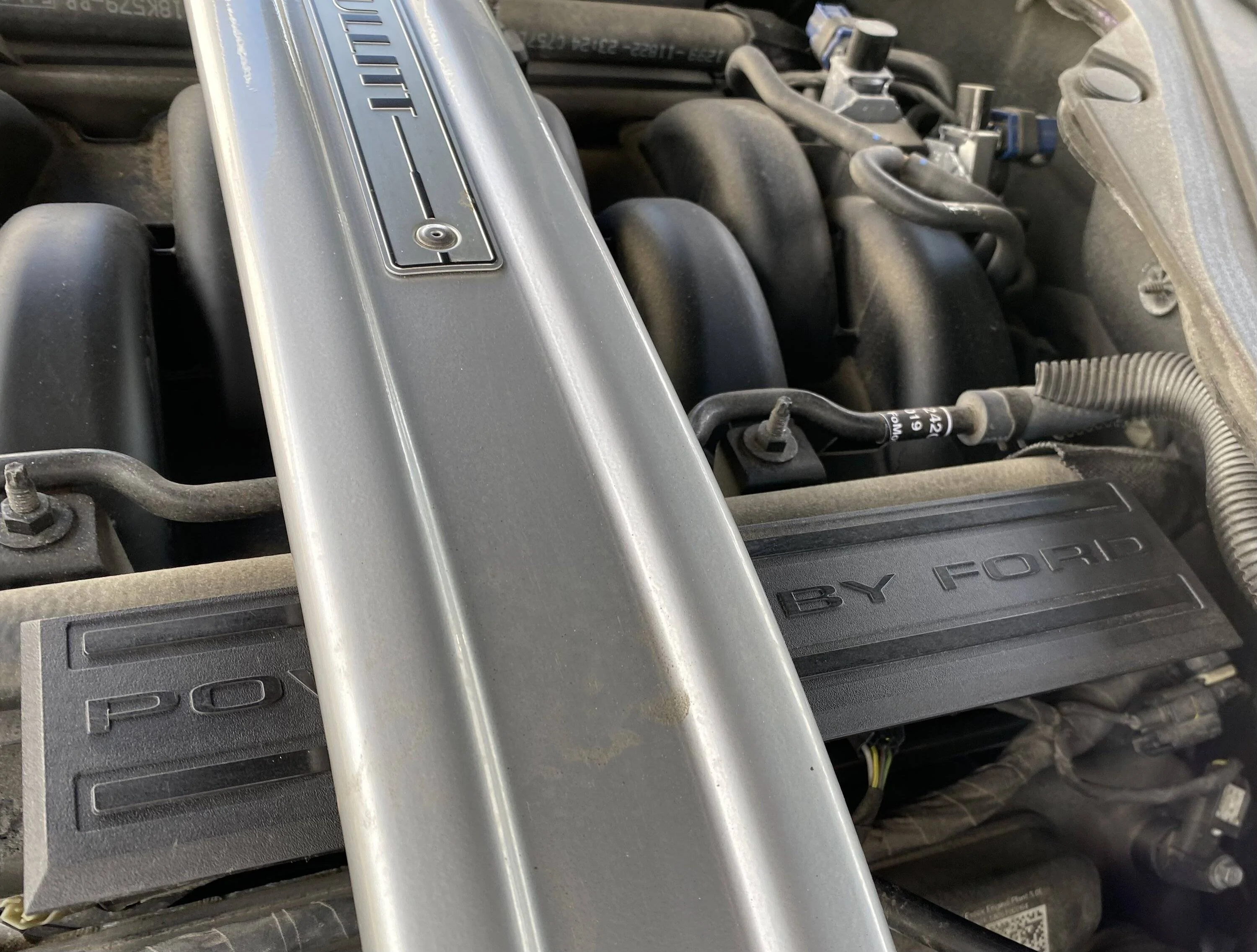

Am planning on removing my Powered by Ford covers to paint them, but just wanted to check to make sure the hardware wasn’t holding anything important in place. Any surprises when I remove them? Anything to watch for?

Speaking from my 2015 gt with the gen 2, but it should be basically the same. You will need to remove oil cap and disconnect the 2 pcv breather lines. After that the covers should just pull off. They are just press-clipped in.
Just go slow and make sure that you have the lines off / oil cap so that the cover will be able to fully come off.

They will come right off, you do not have to remove the strut tower brace. Lift the rubber hoses and tilt them off the studs ands slide forward.

Thanks!
Any screws or anything to be undone.
