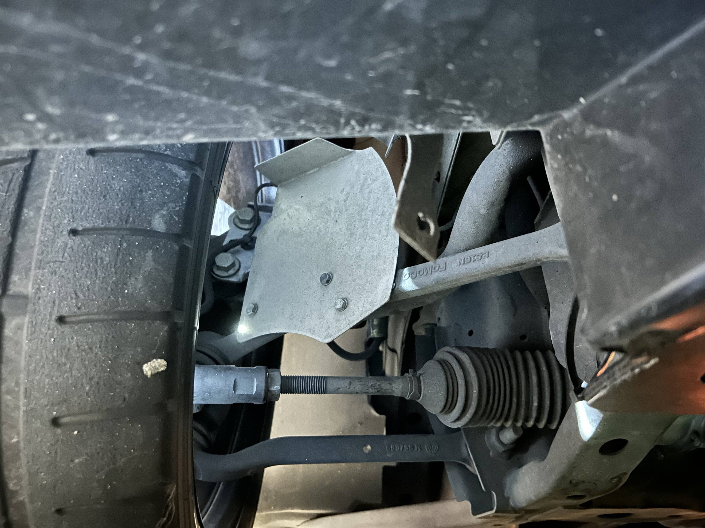

Don’t see any……
Not a great photo, but one of the backside…..

Okay, little miscommunication. Brake dust shields no, Mach 1’s don’t have them. Little heat shield by ball joint yes…..
(Picture courtesy of @mattlqx )
My car has those too, just can’t see them in the photo. (They’re so small, I do not believe they impact the cooling from the factory or aftermarket deflectors.)

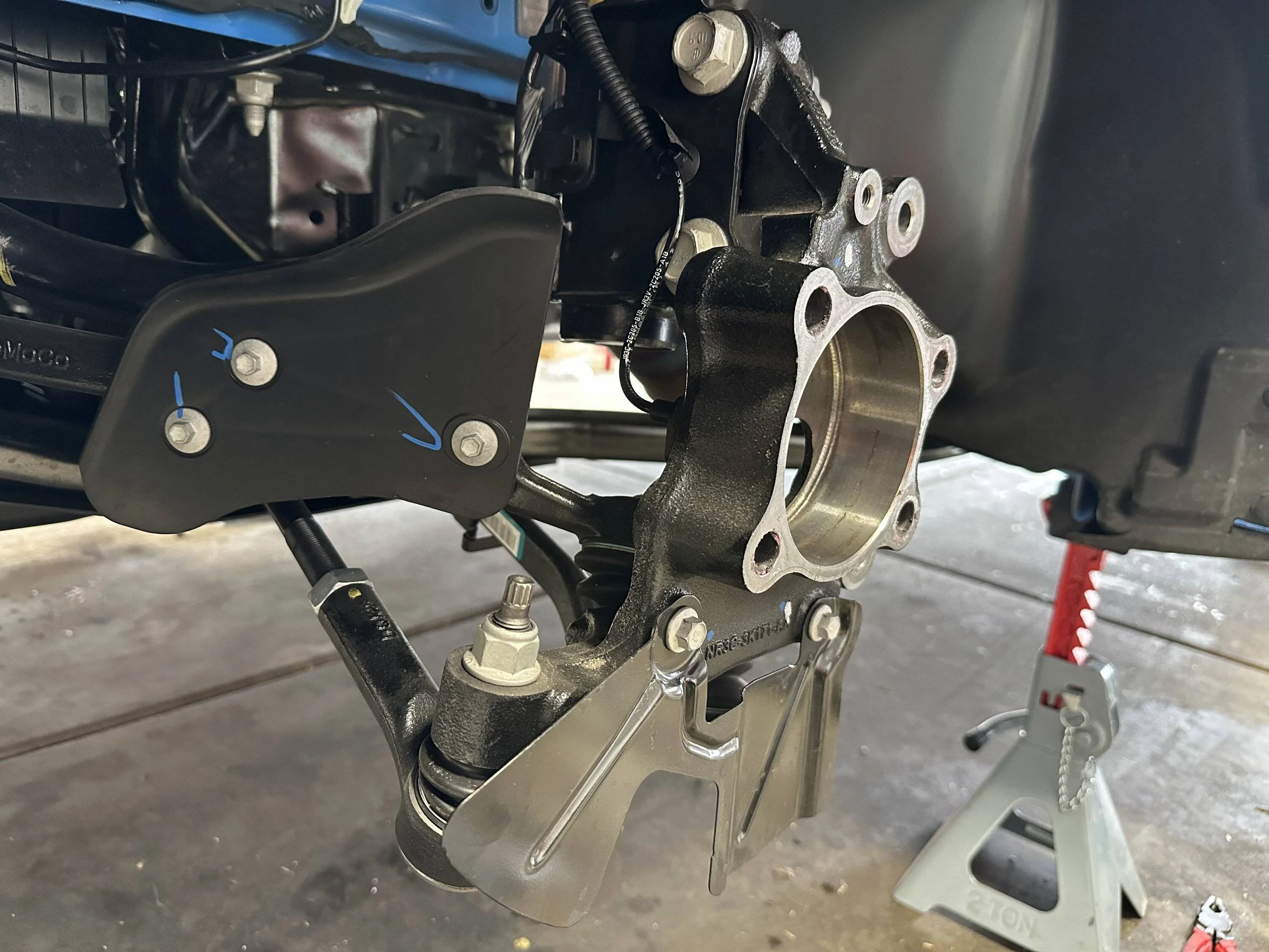

OP: do you have a pic of your modified vanes? Not really sure what you're talking about there.
If you're talking about control arm mounted deflectors like those pictured above, then yes you want to remove your stock brake dust shields or switch to the smaller ones used on the mach 1 and Performance Pack cars.

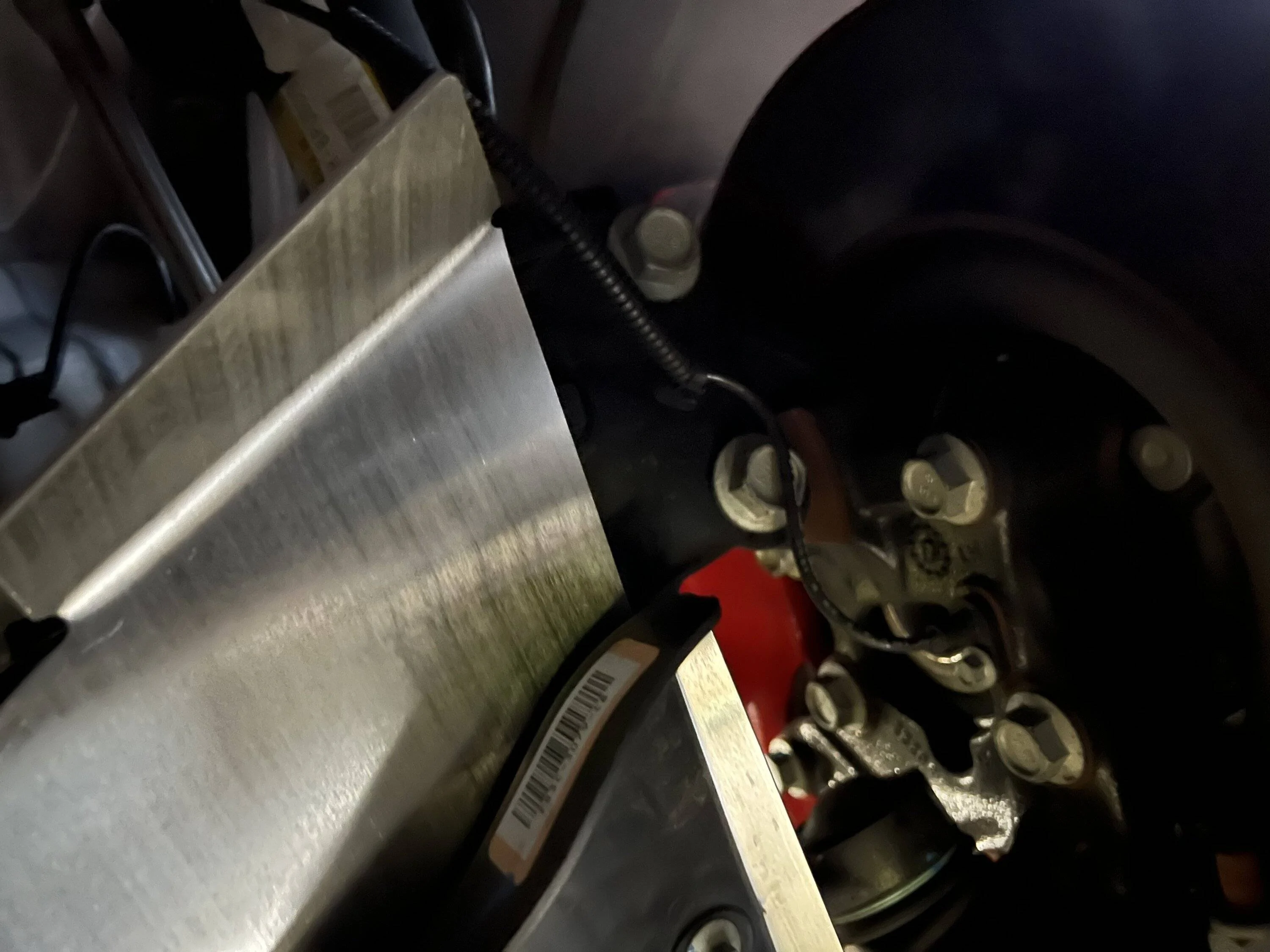

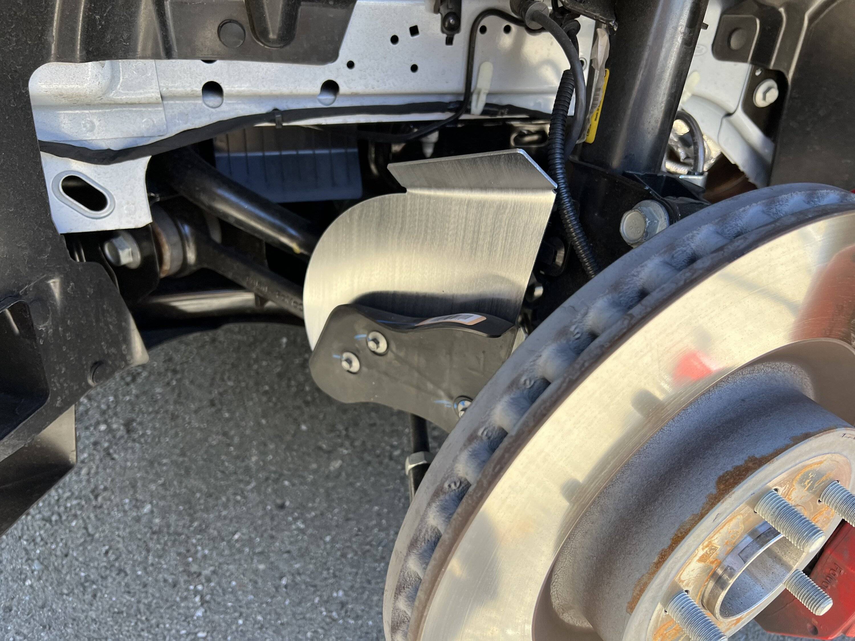

@NightmareMoon I decided to make my own air vanes since the non pp cars don't have them. I made them out of 1.2mm stainless steel and powder coated them. I used orange locktite, 60lb permanent adhesive tape, and the u bolts. After 500 miles of some seriously hard driving they are still rock solid. I do notice a difference in the feel (takes longer for the brakes to warm up) but I definitely think removing the dust shield would make a big difference!

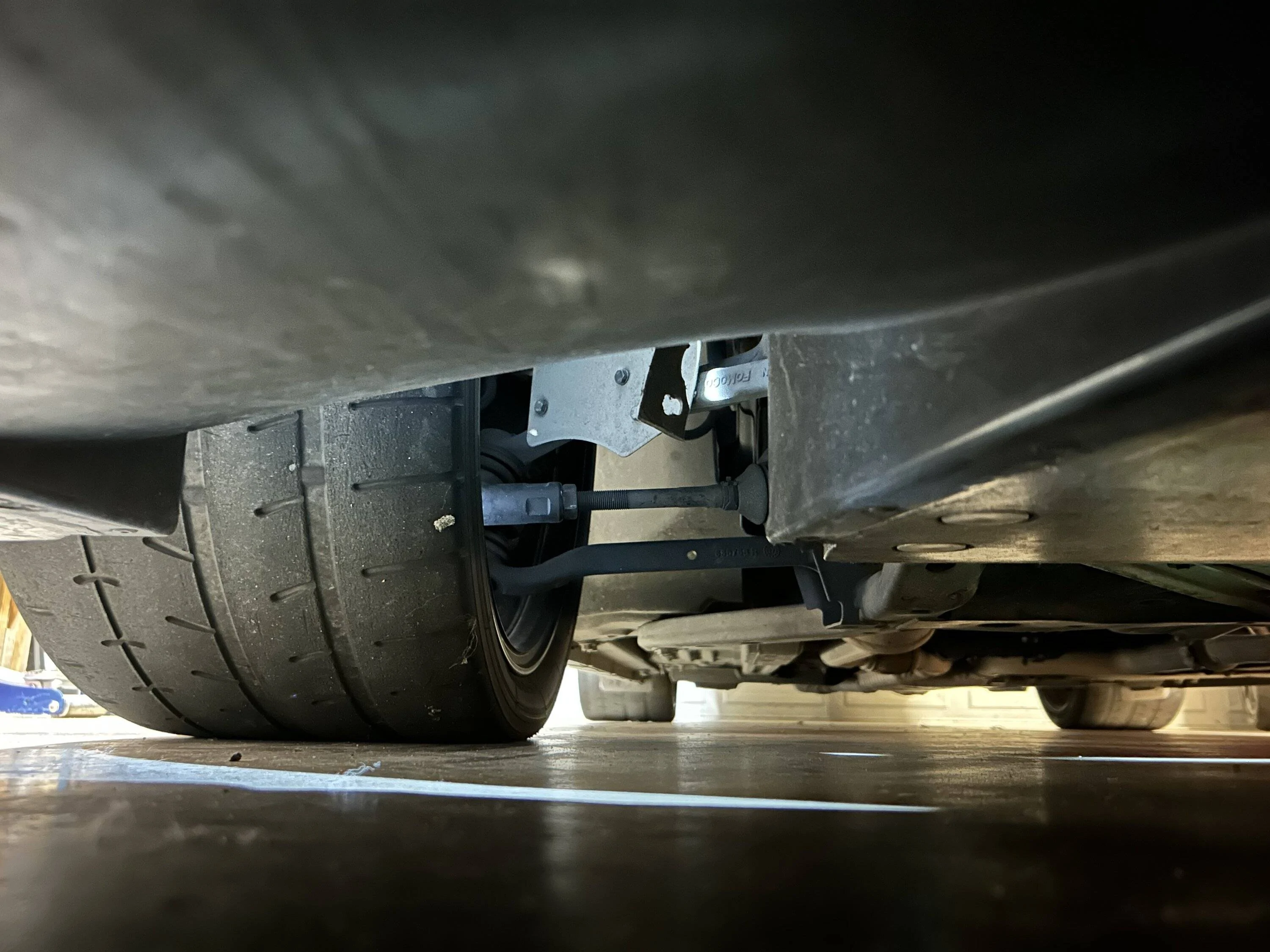

Nice! You’re barking up the right tree.
dont be afraid to go bigger, but it really helps to channel some air up towards the deflectors from the back of the undertray.
Pictured: not-stock. These are Vorshlag’s deflectors and the splitter ducting is a lot larger than usual.
