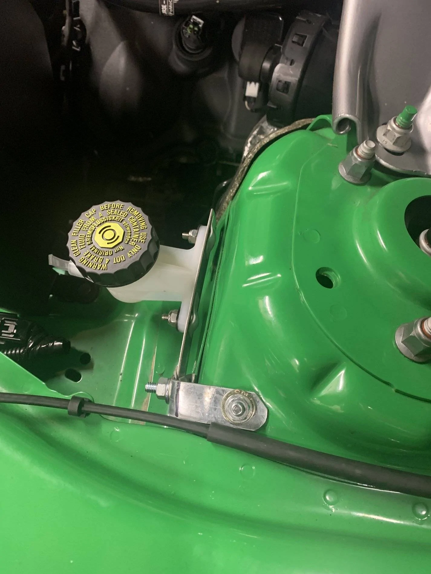

Bringing this thread back. Couldn't find a viable option for my 19. So I fabbed my own.
I used the existing hole in the strut mount, 1" aluminum strap, and the GM reservoir. Haven't run the tubing to it yet, but it's mounted. The only drilling I had to do was to the aluminum strap.
Lock washers or nylock everywhere. And soft rubber behind anything that might rub against metal.
Picking up a hose, a plug, and clamps later today. But doesn't look horrible, or out of place, really.

Like the idea of a separate reservoir. Curious why ya did not just drill 2 holes matching the reservoir mount, rubber washers on the back side.
Posting a mod you'll always get opinions . A factory install would be a tad cleaner, the RH strap looks out of place, after thought.
You happy all that matters, again good idea.

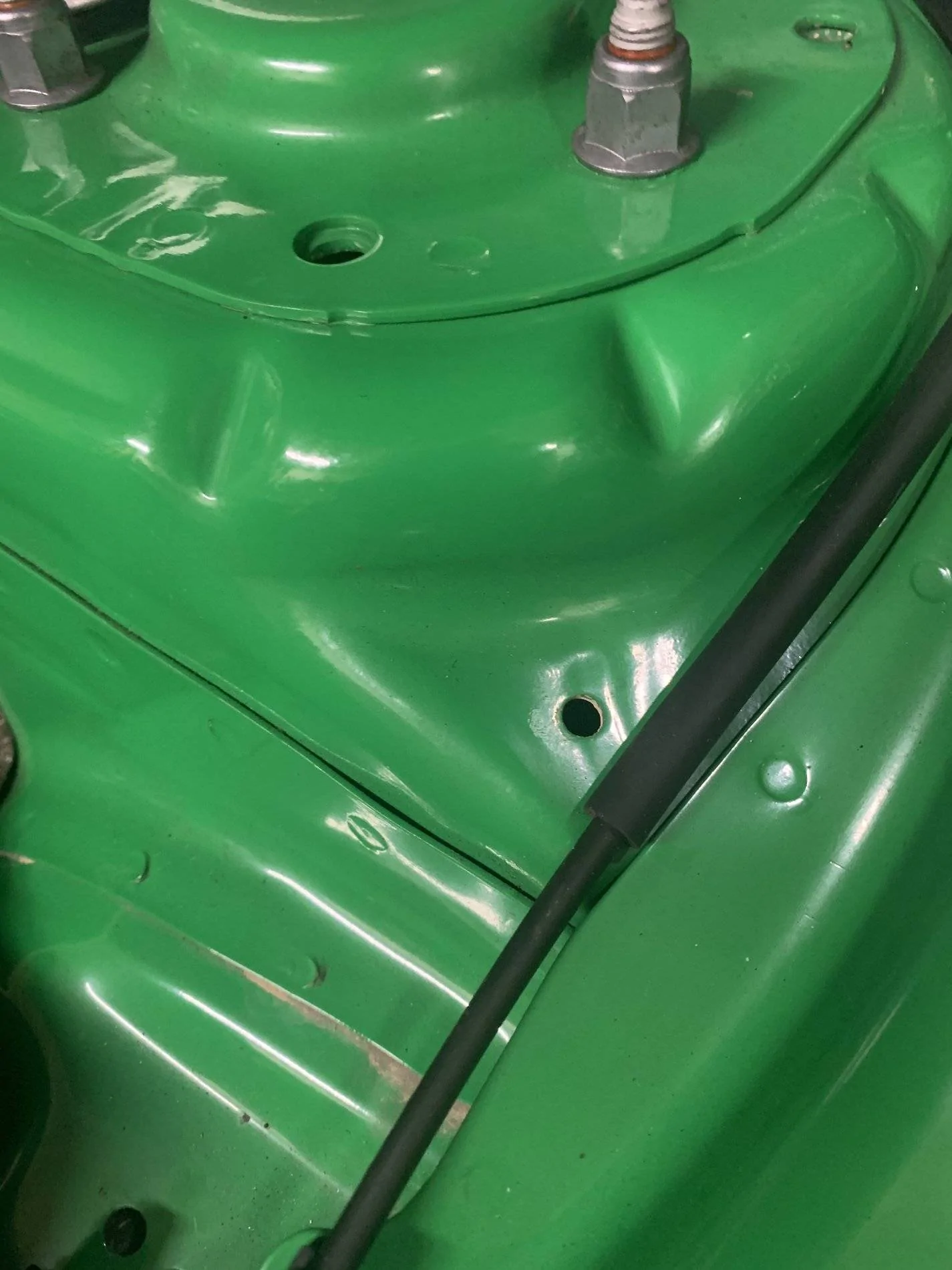

Came down to I just didn't want to drill through the metal on the strut mount. That and it wouldn't have sat level - which would have driven the OCD in me absolutely crazy. :crackup:

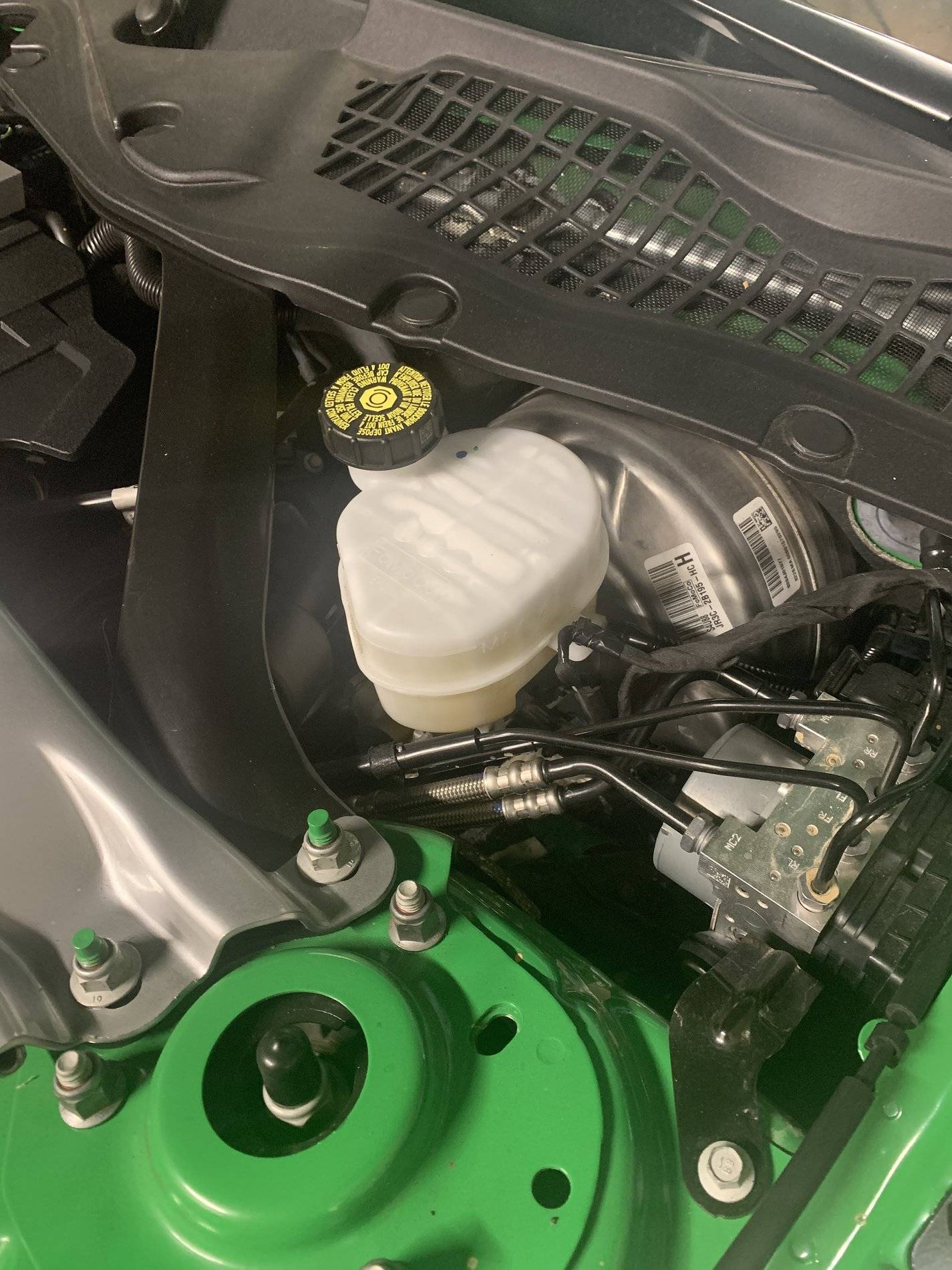

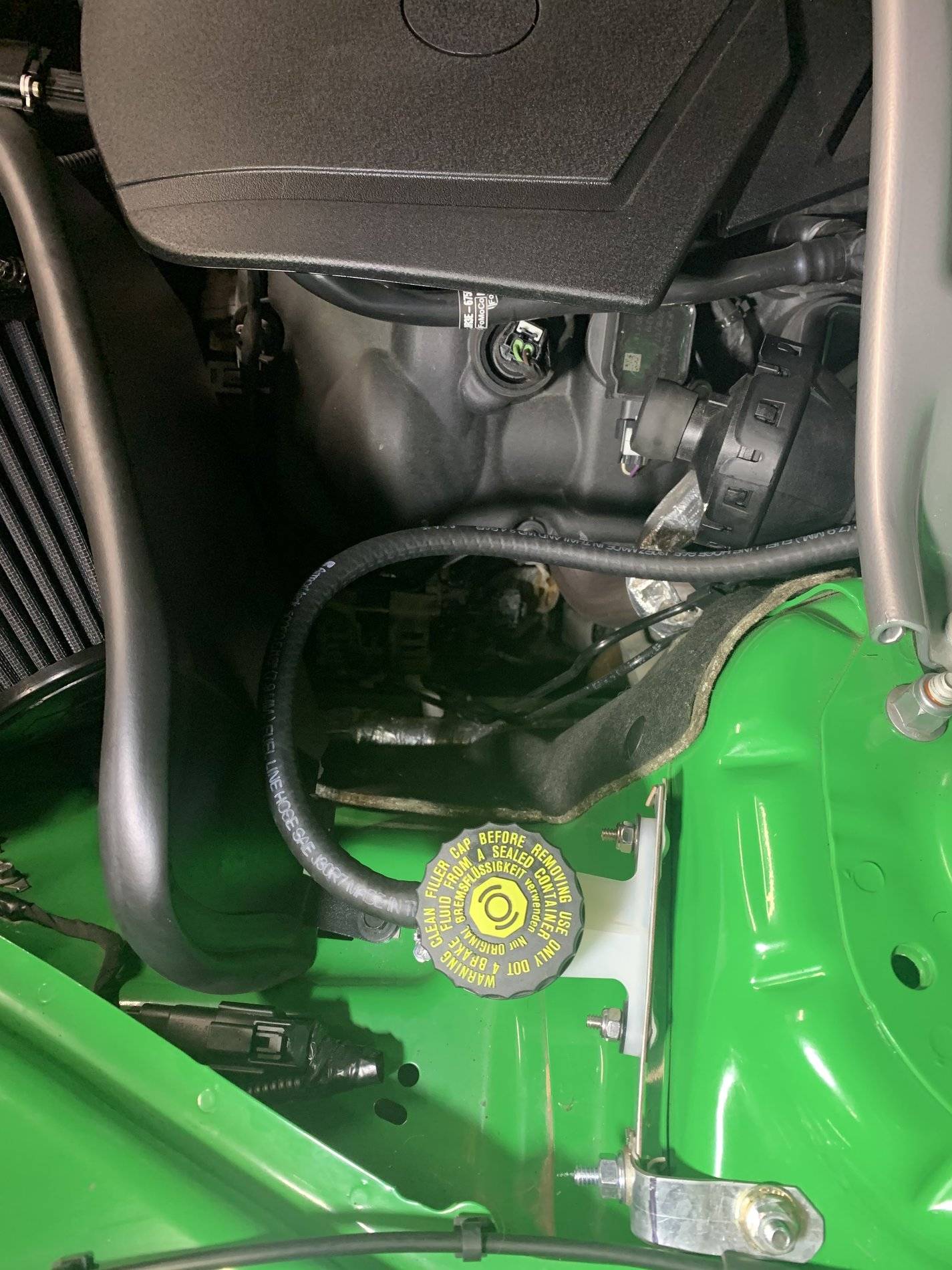

This is the only part I don't particularly care for, but it works for now. (And I still need to remove the noise tube) ;)

On my 2013, i was able to mount on the back side of the tower and the hose connected right up.
On my 19, the line lock fills the back of that space, there's no room right there, unfortunately.
