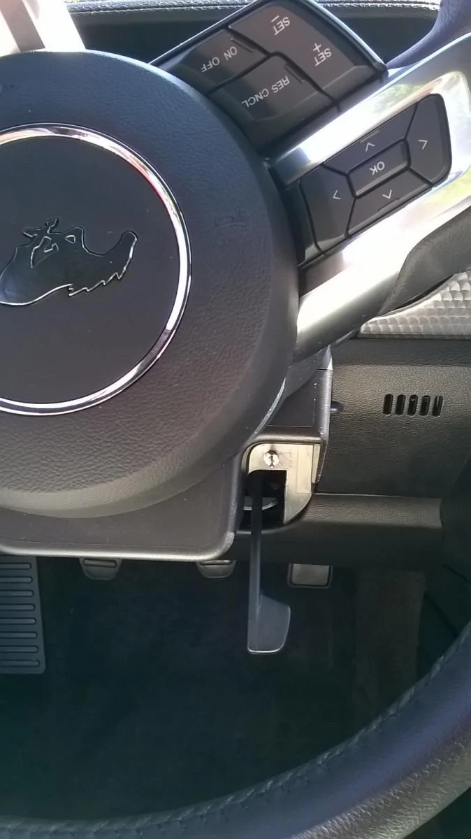

Fairly easy to do. The biggest challenge for me was where to put the micro toggle switch. I wanted it to be discrete yet convenient, I couldn't find an ideal spot. Ended up putting it just above the tilt lever on the steering column.

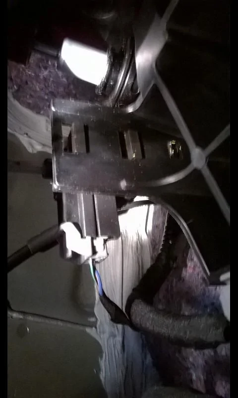

There are two wires on the switch under the clutch pedal, the green/black wire is the one that you splice the toggle switch into.
Works perfectly...throw toggle switch car WILL NOT start! Flip switch car starts normally...
