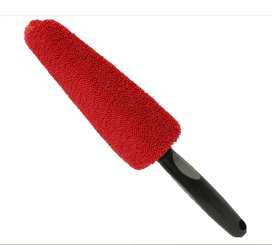

Dude.....they're awful. I mean absolutely awful to clean. Gives you the arthritis.
I got all the stuff/tools for doing wheels, and this one is everything, especially for those wheels.
You can usually get one at VatoZone.

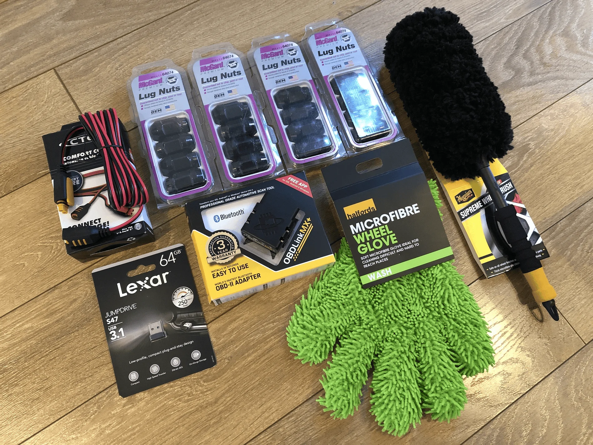

The two things on the right are my weapons of choice for the PP wheels :
The glove in particular is really good and quick for getting around the base of the spokes etc :like:
WD :like:
As a Brit who emigrated to the US in 2001, I miss Halfords!
