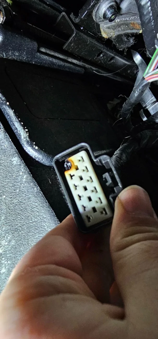

This may be a silly question, but all queries i can find regarding this doesn't answer my particular worry:
Does the passenger side harness being burnt out, also affect the driver side heated/cooled from working? I just checked and mine is definitely burned out, but no burned out harness under the driver seat..

To get a definitive answer you need to check a wiring diagram.
If, as I've read, there is only one ground wire it's entirely possible the answer is yes.
Either get an FSM with the wiring diagrams or hope someone will post up the relevant diagrams to confirm.

Thanks very much! Harness ordered, excited to heat my buns once more after four years.
