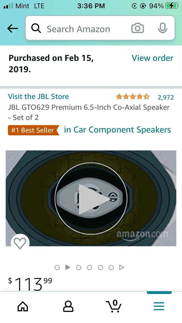

I have GTO629's in my coupe, im happy w them, 3 ohm. Got on amazon for like 70 bucks

Those are 4ohm, if he has a 12 speaker system, his are probably 2ohm stock- he will lose half his volume.
If he is a 9 speaker car, he has 4ohm shelf’s. Direct swap-
My car was 9 speaker and I had 4ohm shelf speakers, I tossed gto629 and got 3ohms
So gained a little more fill. Just something to consider

You 99% have 4ohm. It’s kind of done on purpose. 9 speaker systems have 6.5 door and shelf as 4ohms, it reduces output. Less volume.
when you get ina. 12 speaker car with the upgraded system and they have 2 ohm door and shelf speakers, they playtwice As loud.
so you’re like damn!So much better.
ger 2 or 3ohm replacements if you want more volume.

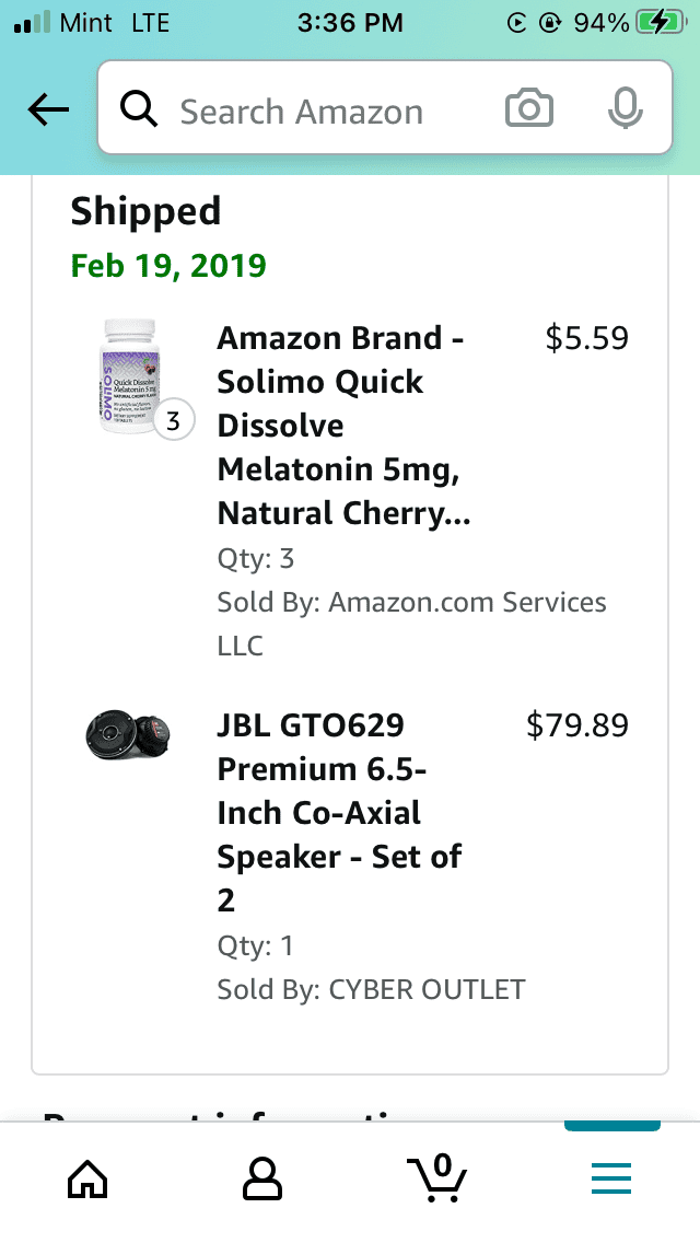

I put2ohms in my door 6.5’ and 3ohm in rear. Becausethe gto629’s are efficient speakers they pumped out a lot of volume.Much louder than 4ohm stock or probably afteremarkedones too
Sorry I’m on iPhone and it’s small. iPhone 5.
this is what I have in my rear. Sounds great imo.But holyshit prices went up! Damn covid
you can always return them if you don’t like them.

I also put a 12 speaker shaker pro amp in my car, since this amp was originally w 2Ohm speakers I went ahead and plopped a 2 Ohm door 6.5 set and I found the 3ohm gto629’s because people was installing and really liking them. Much better than the original rears imo
