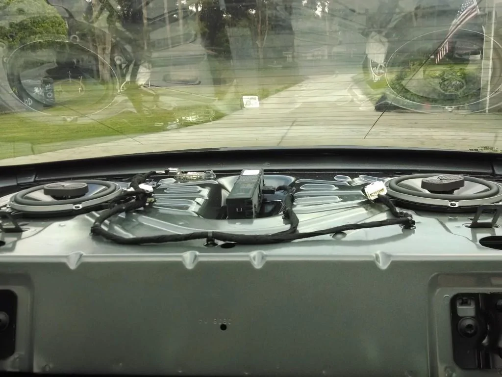

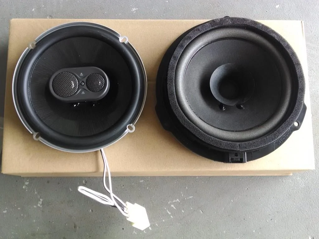

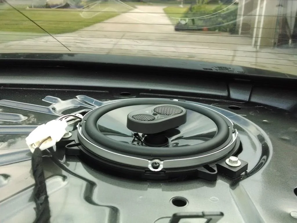

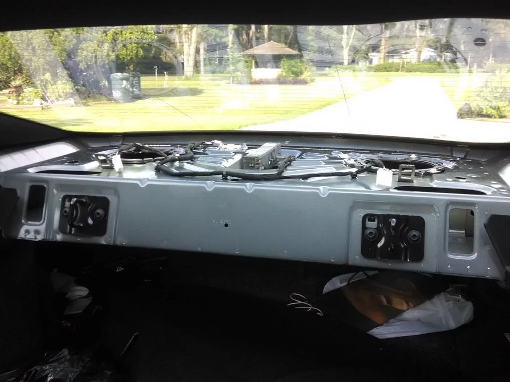

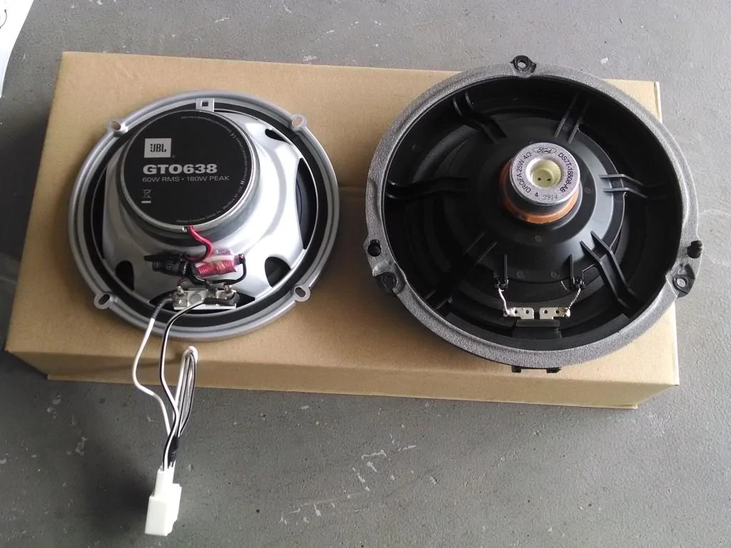

Just finished installing mine. Make sure you have a small quater drive ratchet and a 7mm socket. Of course I've lost both of mine on a previous audio install, so all I had laying around was a short 7mm wrench.:frusty: Did anyone else get a wiring harness with the GTO638's? I thought it came with one, but didn't see one in the box. Luckily I still had some of the pos/neg terminals. Oh, and that back area is not made for people who enjoy a good cheeseburger every once in a while. I had the dog lay on my back just to try and get it straightened out...which made it worse...apparently he gained weight:doh:
