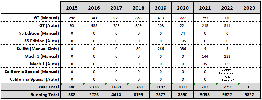

I’ve never seen an official reason, but the most plausible explanation is type approval, mostly relating to emissions.
I just don’t think the market is big enough to justify additional testing by model / by diff type / by diff ratio.
Our U.K. numbers are in comparison very low, here’s something I have been compiling for a U.K. thread :
