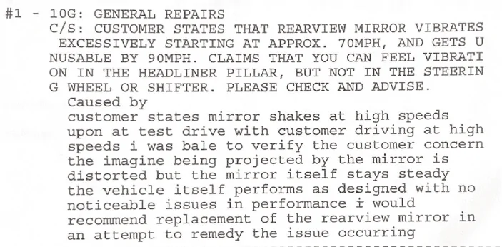

So the service warranty write up from today is copied below.
Because I bought the car from this dealer, the service manager, the sales manager, and others took a serious interest in what the service tech reported. As I was driving, he pressed his hands against the floor, windshield, steering wheel, dash, and other places in the passenger compartment to see if anything else was vibrating. Found nothing. Tires/wheels all felt balanced. Car tracked straight like an arrow. So they were all quite curious about what they themselves witnessed. They are going to advise if/when they will replace mirror.
To be clear, I almost never exceed 80mph. I took delivery 14 months ago and it only has 4,000 miles on it. I only discovered this a few months ago.
I'll post updates and reply to anyone's questions.
