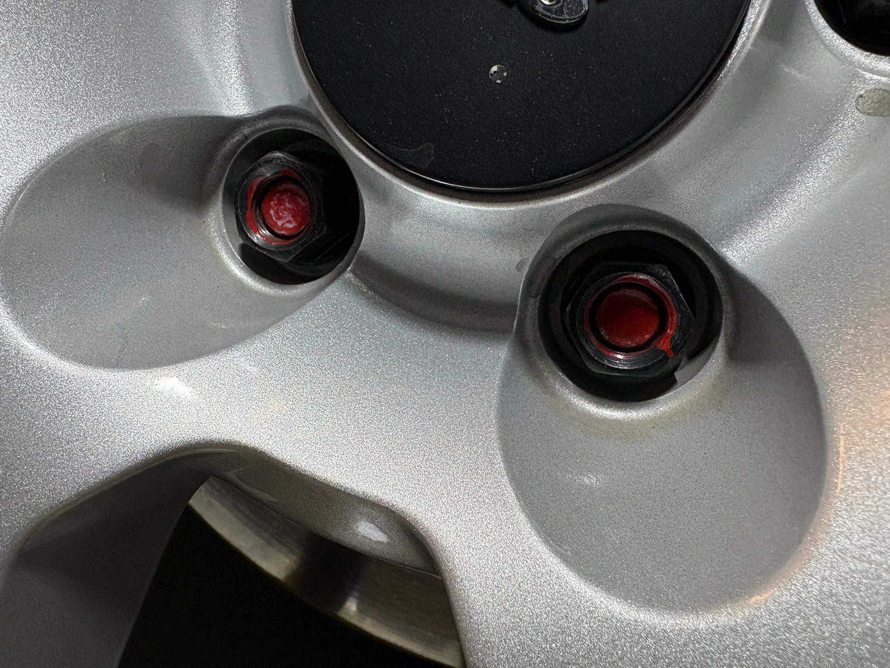

There's plenty of thread engagement within the threaded cone section but it sure looks sketchy. These are SVE wheels I use on my winter setup and the Apex wheels I use on my summer setup look the same. I'll eventually upgrade the studs.

How many turns of engagement you got there?

20mm of thread engagement so that would be 13.3 turns. I never measured the OEM wheel engagement but I doubt it's much better? I got Optimum Performance's PGT4 extended studs up front but I'm undecided what to do about the rear studs.

well 7 *full* turns or more is ok with good quality lug nuts.
I had a friend loose a wheel trying to run a lightweight lug with too few threads engaged. Chassis scraping the ground as it slowly came to a halt missing a front wheel was a truly terrible noise. Needed a new rotor after that, rotors dont make for good wheels
