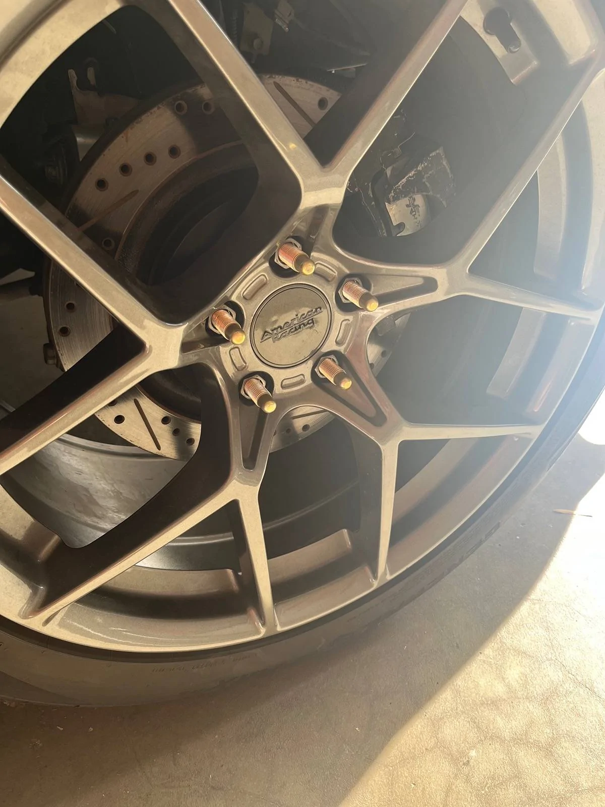

Those of us with the FP rear hubs, what are you doing with the longer wheel studs? Trimming, if so, best way? Open ended lugs and having them stick out? Longer lug nuts?

They’re intended for wider wheels. Some use spacers with them.

Use an open lug nut, take a measurement to the end, remove wheel, run nut down to the same measurement, cut off wheel the stud, then unscrew the nut (which will clean up the thread, round the sharp edges with a flap disc, then you can run OEM or closed end lug nuts.
We offer a mid-length stud that is approx. 3/4" longer than the stock rear stud so it does not stick out as far. Currently at coating so should be back in stock in a few weeks. Our long studs are mostly designed for the front to run spacers. The mid-length was designed for up to a 15mm spacer.
