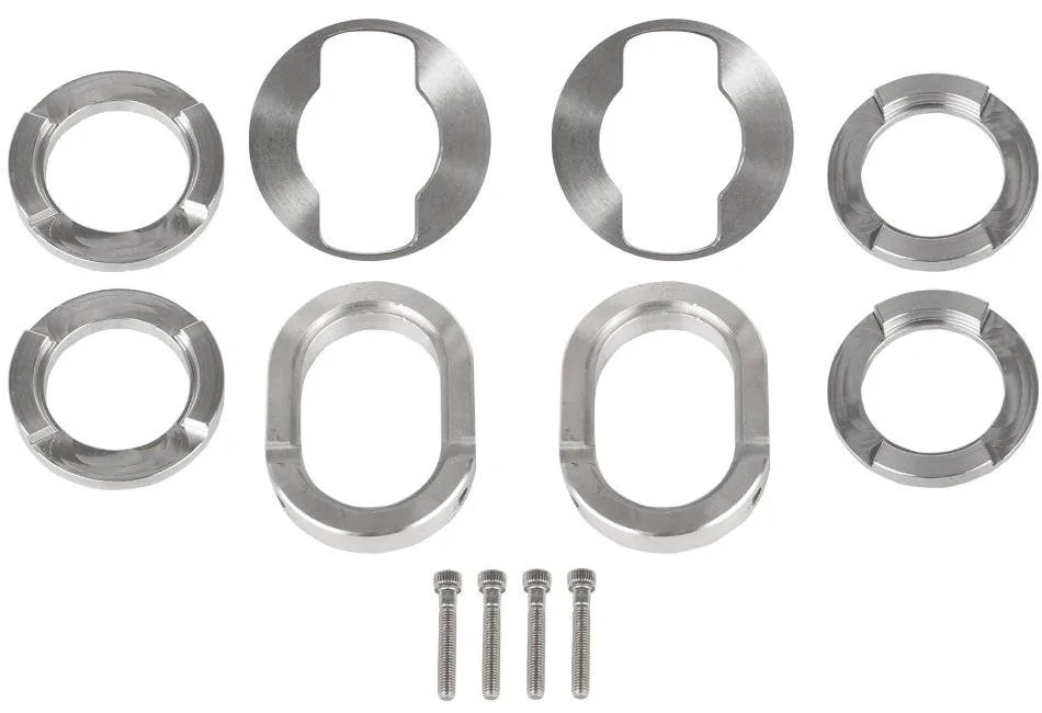

To be clear, when I'm talking about the subframe supports, I'm talking about these:

The subframe inserts will have minor NVH. I haven't done the work, but I have heard the differential bushings will be more NVH. I would start with just the subframe kit.

Fair enough. But my main question is whether I should get the polyurethane subframe bushing inserts or the solid supports.

Hi Sloppy, that's a good question. The manufacturers of the solid billet inserts recommend them for track and racing applications. I have the black polyurethane inserts on the subframe and differential mounts. I haven't noticed any additional NVH, but I have 90 percent hearing loss in one ear and 50 percent loss in the other, so the point may be moot. I have not noticed any additional NVH through the seat or steering.

Steeda says their aluminum rear subframe supports do not add any NVH. However, when combined with the diff bushing inserts (I'd go with the softer 80a reds), there may be a significant amount of NVH increase. I'd like to get some idea of what I'm in for with only this combination of aluminum supports and red diff bushing inserts. If it seems like too much, I'll do the subframe bushing inserts instead of the aluminum supports. If it's mostly just clunks and some gear noise on accel and decel, then that's great (maybe even welcomed and will make the car feel more racecar). If it makes the chassis resonate like a subwoofer, it's getting removed as quickly as possible.

I've got the solid supports and there is no noticeable increase in noise. The rear is firmer and the sound of bumps is sharper but not unlike any performance car. No harmonics, no resonances......
