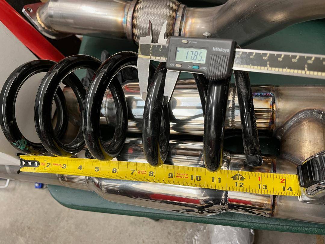

Can anyone tell me the inner diameter and unloaded length

Spring specifications are different for various models and applications but attached is a ballpark sizing of a Mach 1 HP rear spring. Installed outer diameter will be pretty close to the free outer diameter so subtract your wire size (x2) from installed outer diameter to determine the inner diameter.

Pretty sure it's a 5.5" (ID) spring.
