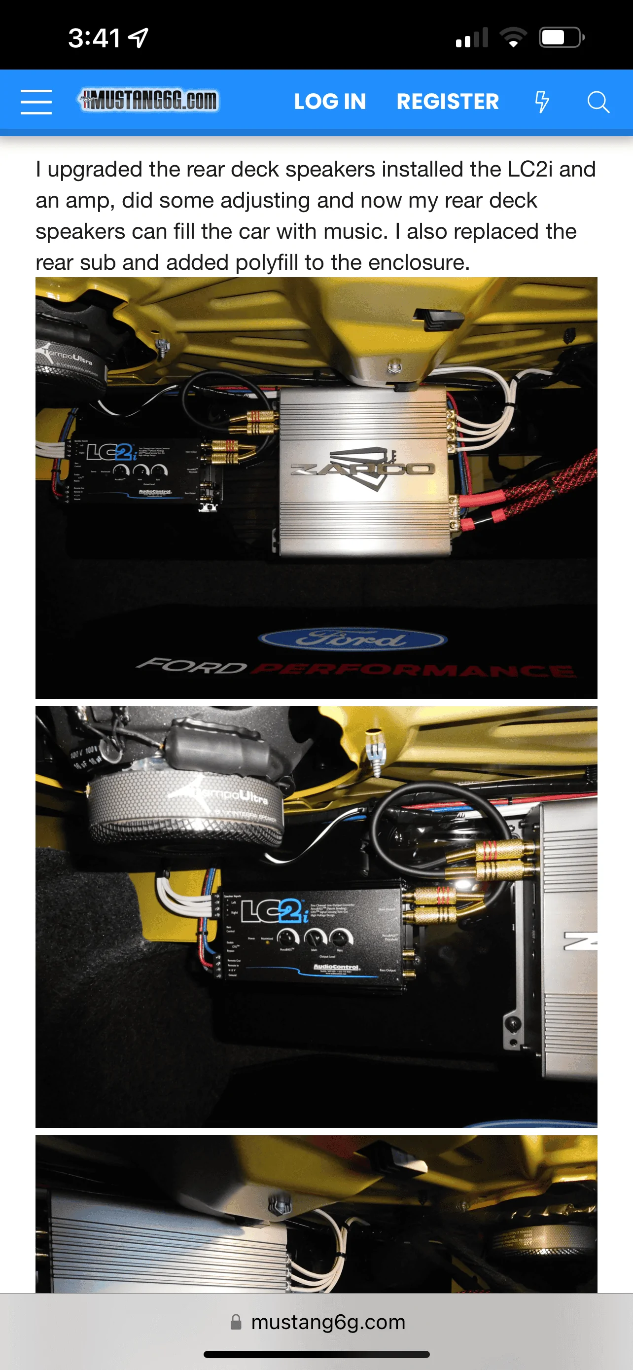

The photo's the OP posted are my car. I have the 12 speaker system and the bass was weak. I'm old school and wanted more rear sound when adjusting the fader. With the Morels in the rear deck and the sub upgrade I have bass that cannot be reproduced from the front stage. It's f-cking loud and sounds good. My hearing is shit from working at a car stereo shop from '78-82 then 38 years in commercial/industrial electrical construction and a lifetime of shooting sports. Any questions?

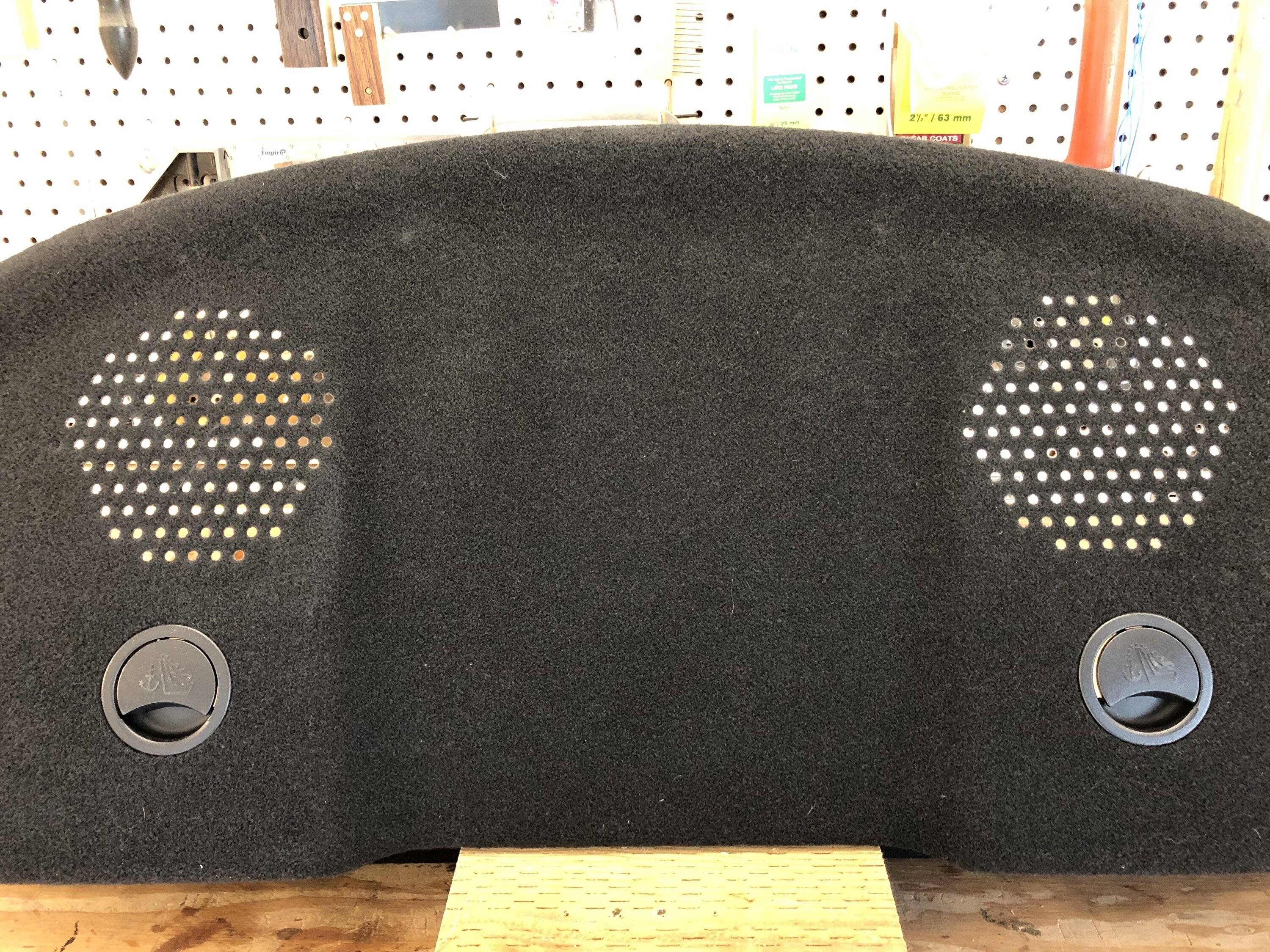

Forget your grill ideas. Go to Crutchfield, buy the adaptor kit. Go to Harbor Freight and buy a punch kit. Punch holes in the deck lid, install the speakers and put the deck lid in. Nice professional installation.

I actually have a leather punch kit in my Amazon cart right now.

An 8mm is the perfect size. Punch from the back as there are holes already there and you will just be punching through the carpet. Use a very hard sacrificial backing board to punch against. I used a piece of HDF board. More than one strong hit with the hammer was required to make a clean cut.

HF tools are hardly sharp.
I own about $10,000 in tools. I only go to Harbor freight if I need an inexpensive one and done tool. The punch kit worked just fine as evidenced by my photo.
