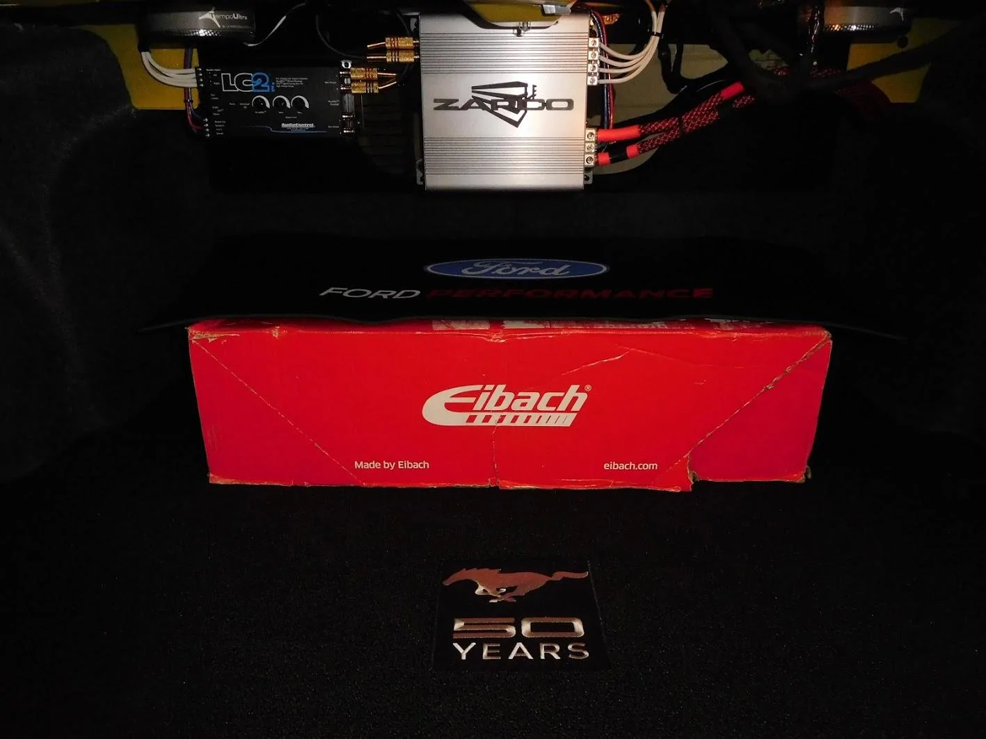

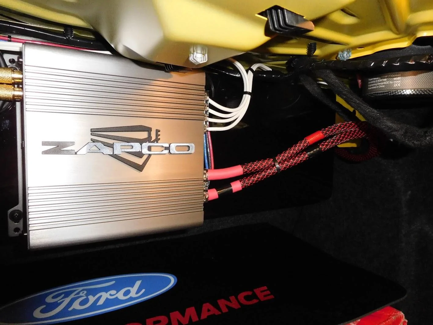

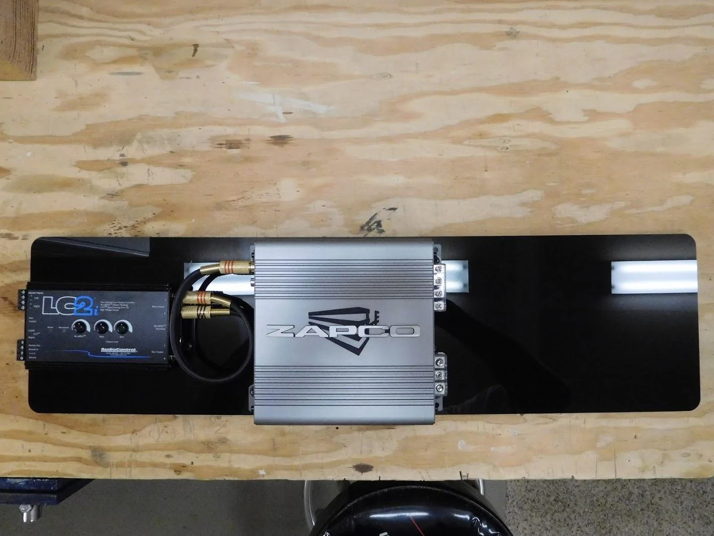

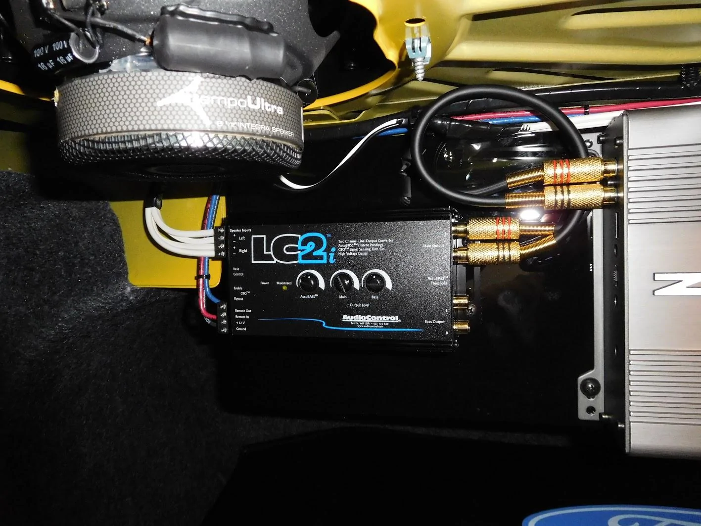

I just upgraded my rear deck speakers to Morel Ultra Tempo 602's with a separate Zapco ST-2D amp and an Audio Control LC2i signal processor to my Shaker Pro 12 system.

It sounds really good! I have adjusted the output of the LCi2 line converter and the gain on the amp up so I have a balanced sound between front and rear when adjusting the fader. Now the entire car if filled with sound evenly. Using a line converter makes it possible to take speaker line level inputs and converts the full audio signal to RCA outputs to send to the signal to the amp. No need to run RCA cables front the head unit to the amp location.
