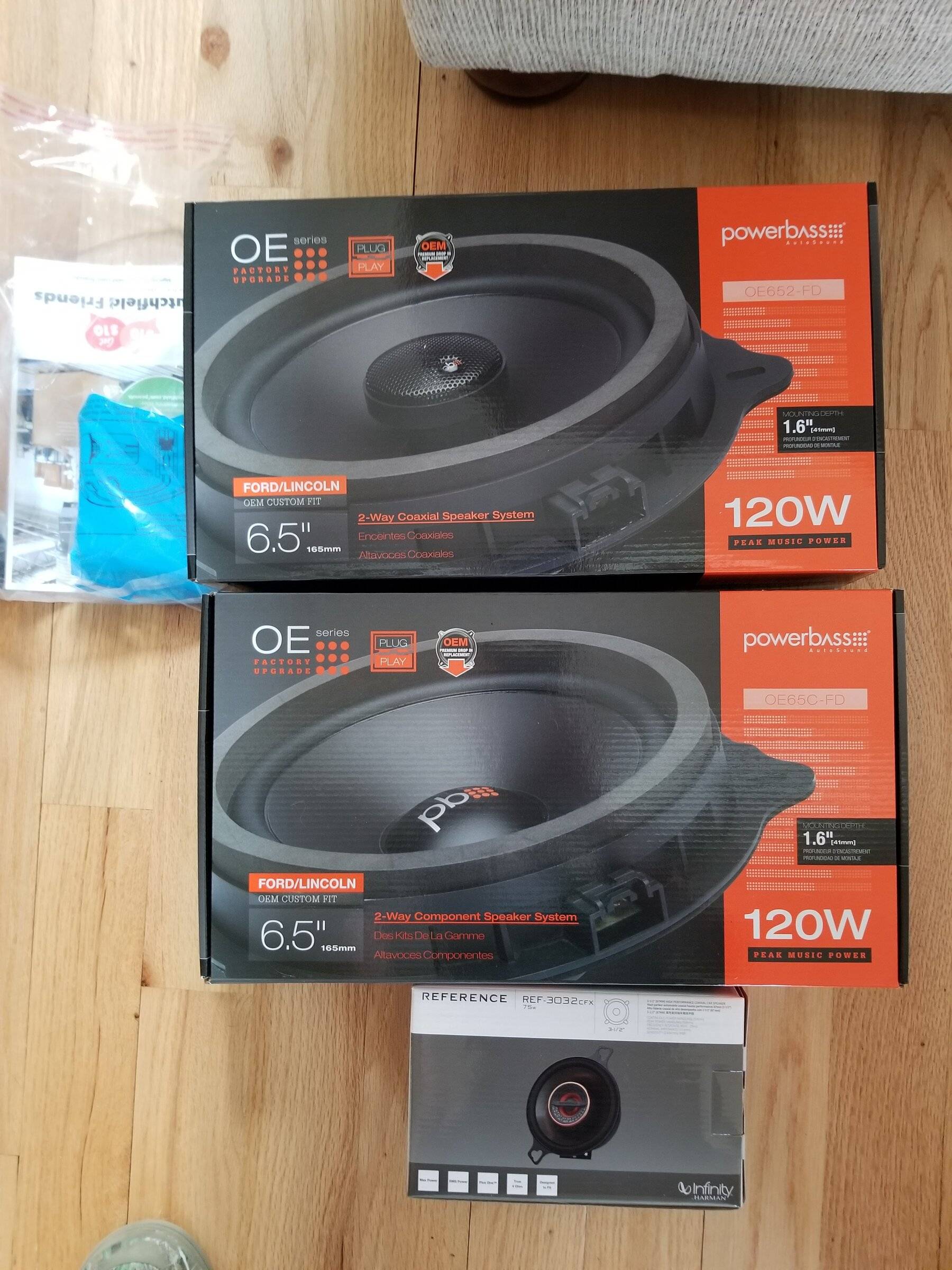

Thanks for the replies peeps, the stock 9 speaker system got better when i added my sub, really filled in the bottom end...however after rocking it this way for a while i started to notice crackling and popping in the speakers...volumes over 19....after some further research as much as i dont mind tearing into it....im going to leave it for another day. The rockford dsp i was planning to use seems to have some werid feedback on things. That, along with the cost of multi channel amps...ill back burner it.
For now, i ended up going with crutchfiels recommendations, plug & play PB set up for doors n deck, Infiniti 3.5s for doors. I've read were this alone has made a difference that many were happy with....well see.
