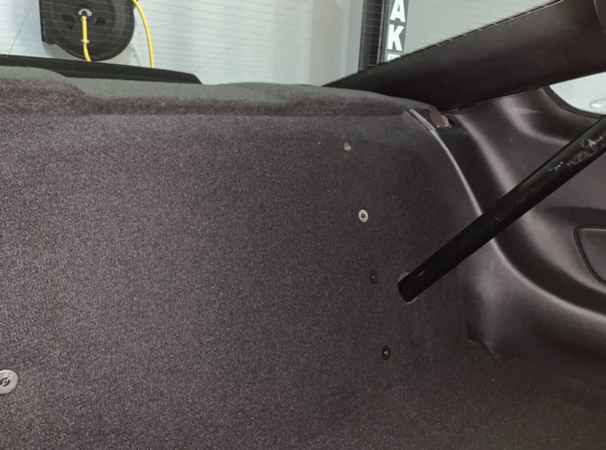

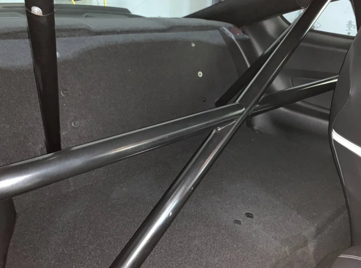

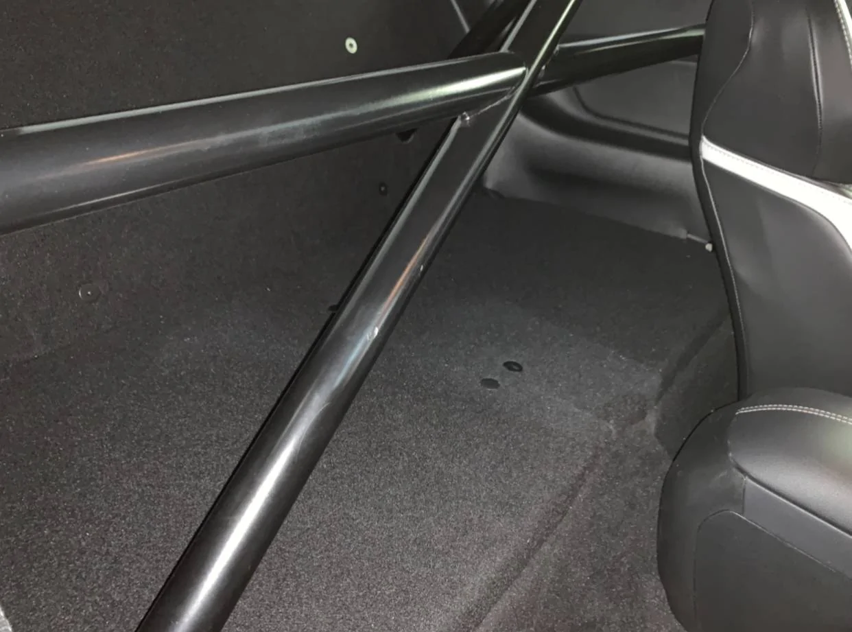

Here are a few photos of my rear seat delete.
It was more difficult than I anticipated due to having to cut holes in the back piece for the roll bar. I should have paid a little more for the backseat delete for the Watson engineering roll bar it has the holes already cut out and you just cut out the carpet over the holes.
There are only 2-push pins at the top of back piece. I added an aluminum bar from top to bottom and added 3-bolts per side for added support.
I purchased the Shrader Performance Rear Seat Delete Mustang (2015+)
