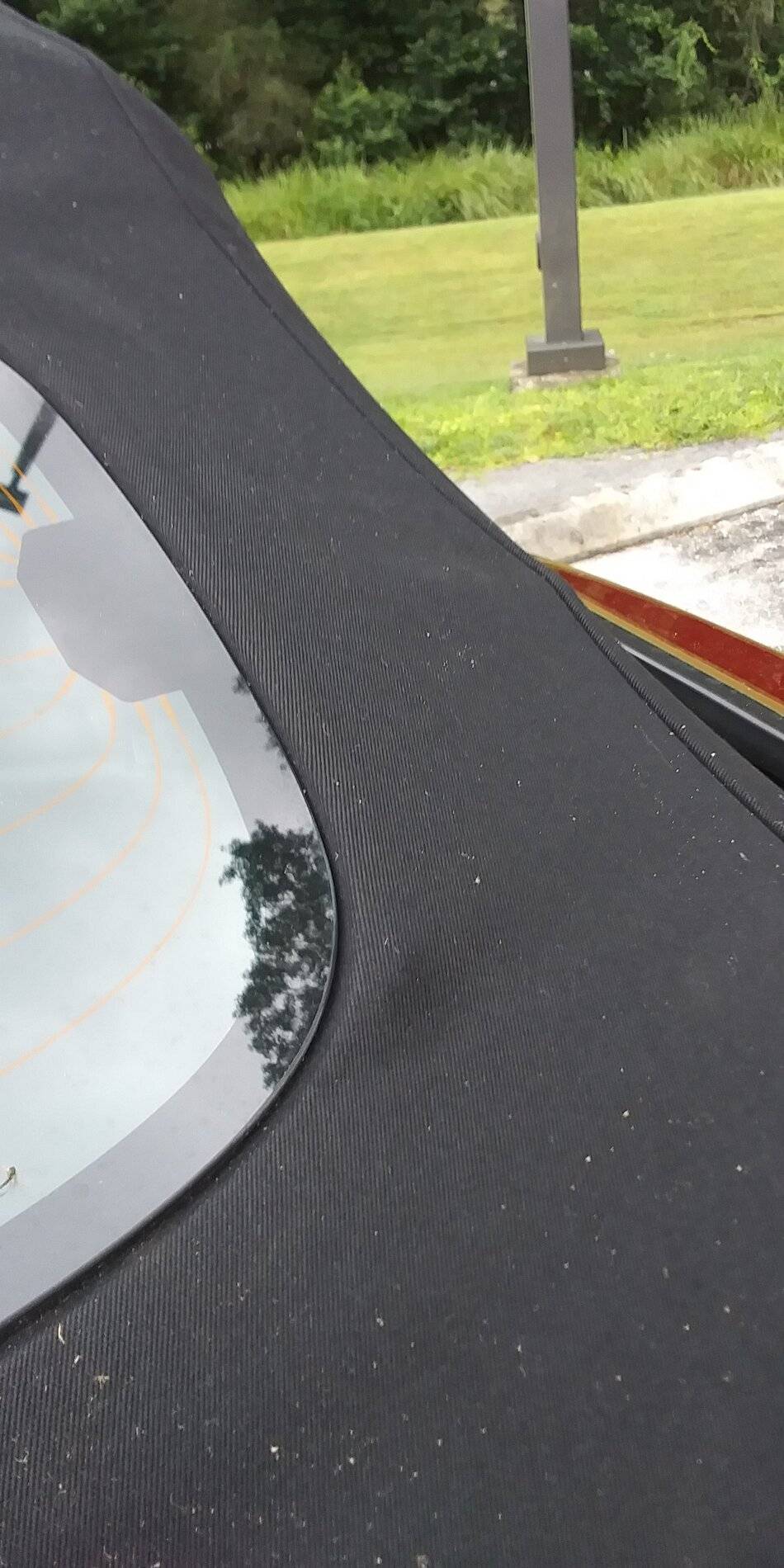

I can’t tell for sure from your pic but it looks like they are detached. When they both are out it looks normal (maybe even better). i noticed min because only one came loose and it was asymmetrical. When they are attached the window vibrations are greatly reduced.

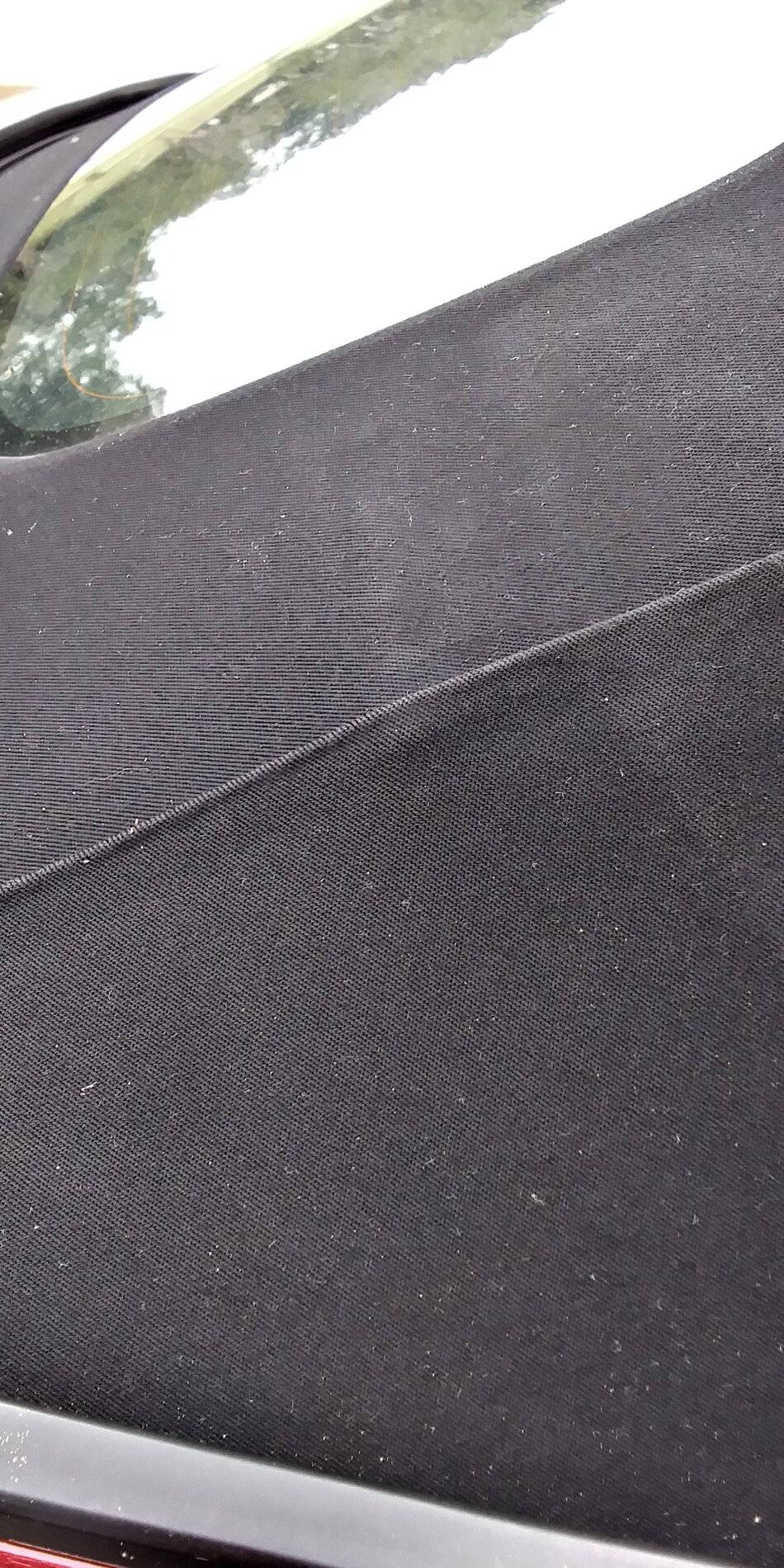

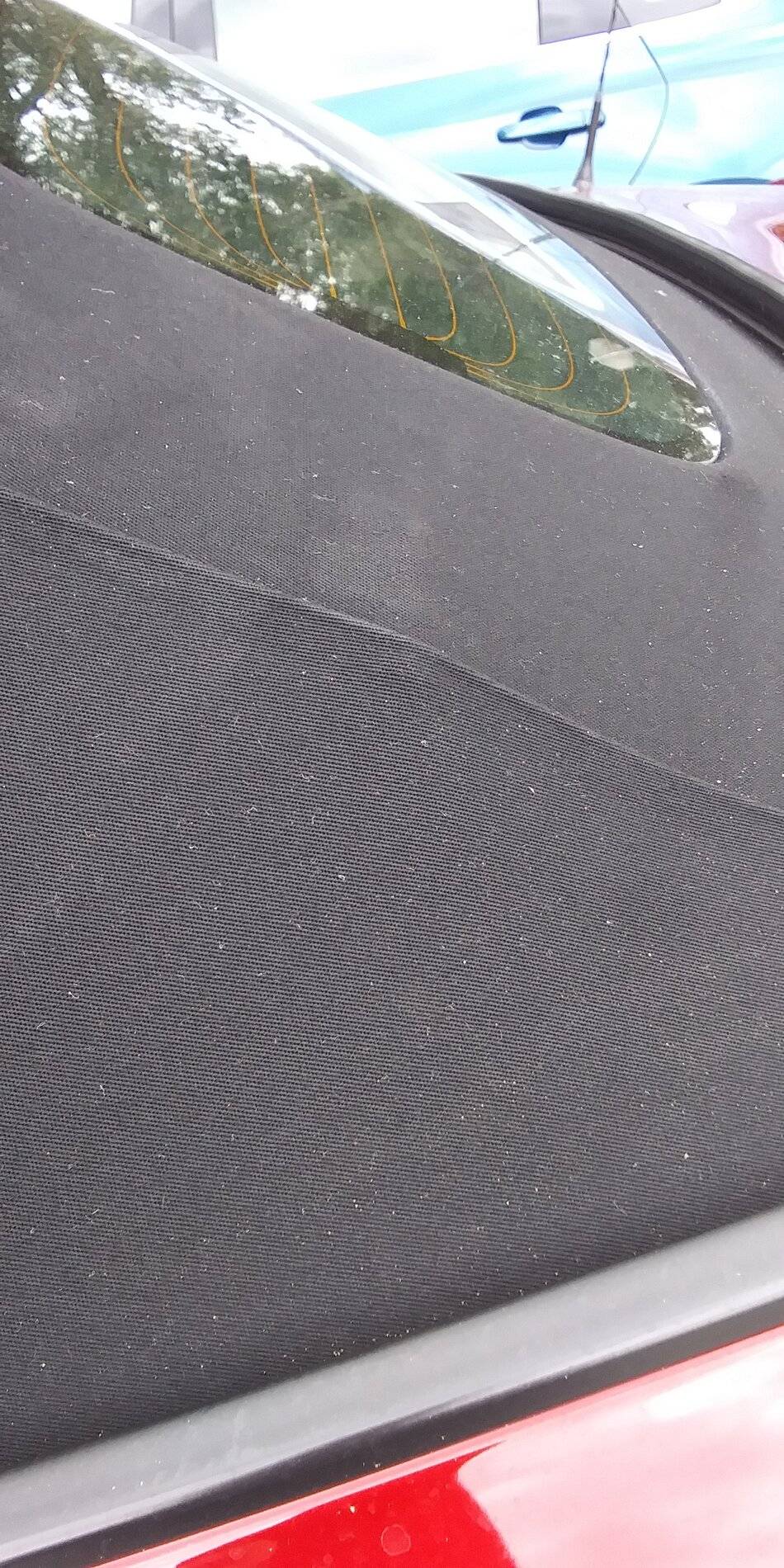

I took some close-ups. I can see the bumps on your images but they're not as pronounced. Both sides of my car look the same.
I also discovered that the rearview mirror was loose. I tightened it and the vibrations now seem less but they're not completely eliminated.

If your struts/arms were disconnected, the top would sag in at that point. This is clearly not the case with your top.

So it seems like my struts are A-OK. Thanks. The vibrations must be normal for the car. Thanks again.
