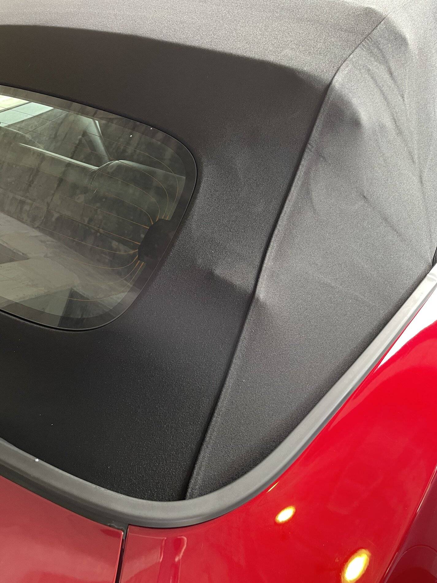

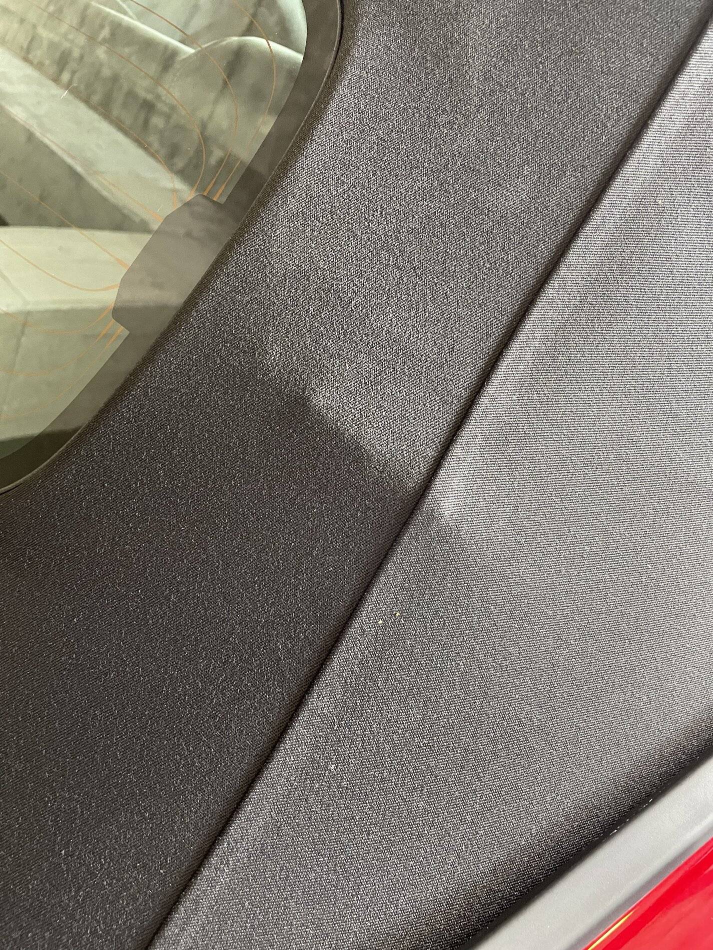

Check the support bracket on either side of the rear window. They were a problem for some early convertibles (like mine). They fall out of the attachment to the window and the rear window vibrates a lot with the side windows down. I had mine fixed by the dealer when my car was under warranty.

You'd know if the side support was out of its clip at the window, both the top and the window would be sagging at about mid point of the sail panel. If the position of the window looks normal, your support is clipped in (if not, it's the clip at the window that has come undone).

The support struts should be visible where they attach to the window. If the both have come loose it will look normal but the window is not supported properly and will vibrate excessively.

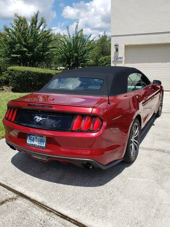

This is the only image I have of the back glass/top from the rear quarter... It's not a close up so I'm not sure it's helpful. It looks like there's a hump from the middle of the side of the rear glass to the side panel on the soft top in your images that I don't notice on my car. I'll definitely take a look again for this hump.
