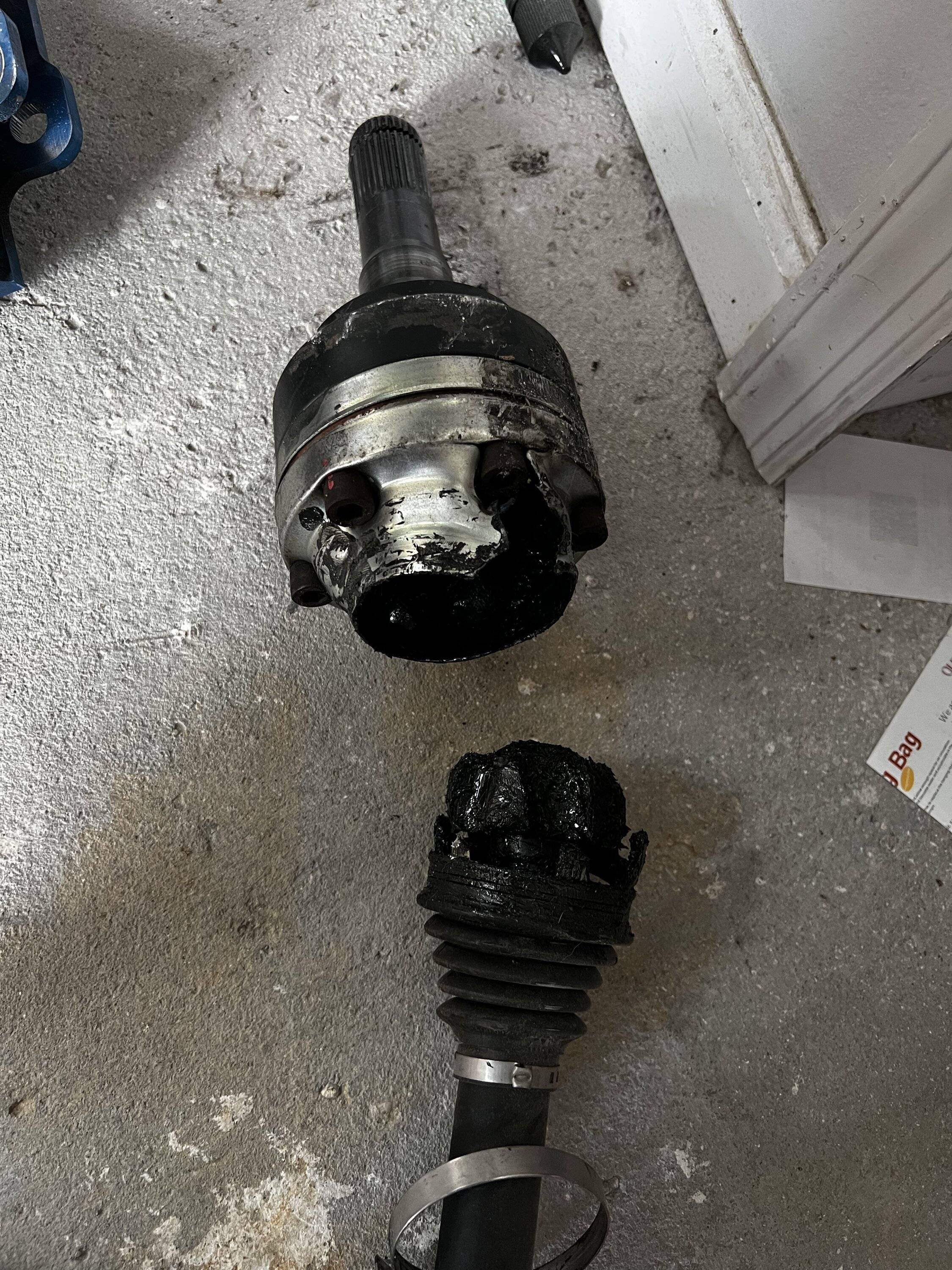

I’m getting tired of breaking half shaft usually is always the right side, I had the DSS “2000hp” and didn’t last long then I did the gforce renegade lasted longer but this Wednesday it decided to quit. What other options do we have? My car is a 6 speed so if harder on everything. Running on the 9’s with about 900hp. I’m afraid of upgrading to the 9” since I’m not breaking rear ends im breaking the cv part of the half axle and that part looks the same.

Are you breaking them on the street? Wheel hop? How's your suspension and alignment? You may have too much negative camber for that power (steep joint angles) laying beatdowns on it with a manual.

Ford performance and g force are made by the same company, the 9in is stronger but I’m not breaking the 8.8 my issues is with the cv it self.

Yeah..... That's either a hopping/shuddering issue or the angle of the rear knuckle having too much negative camber for sure under power.

I’m breaking at the track! I have bmr,
BMR-CB005R Cradle bushing lockout kit, level 2
BMR-BK055 Bearing kit, lower control arms, rear, premium
BMR-BK050 Bushing kit, differential, aluminum
BMR-TR005R Toe rods, rear, double adjustable, rod ends
VIK-B358AM Viking rear shock, double adjustable. 16R 14C
and alignment is set at what bmr told me at the moment I will have to double check what that was and if still on specs. It does wheel hop from time to time and that particular pass it didn’t wheel hop, on the previous It did but for second and I let off immediately.

What tire?

Turns out the issue wasn’t an halfshaft like I thought it was. This time was my rear end one planetary gear decided it had enough. I’m glad it was the diff and not the axles
