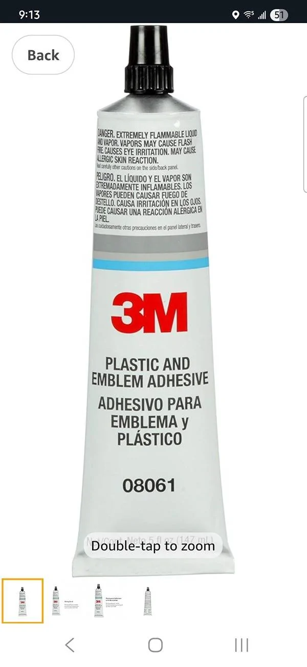

when I shut the trunk at a local car show. It is a 50-year anniversary car so it's the one that says GT 50 years. It didn't damage it, but I have no idea how to get it back on. It looks like it has some plastic pins that hold it on but I'm not sure. Anyone had any experience with this and know if there is a backing plate that you can get or will I have to try and find a whole new roundel. Thanks in advance for any help.
If your talking about a Two Plastic prong which holds a emblem to a panel, apply a small pea size amount on each side, press into panel, make up something to keep pressure applied for 24 hiurs and never look back. Good luck

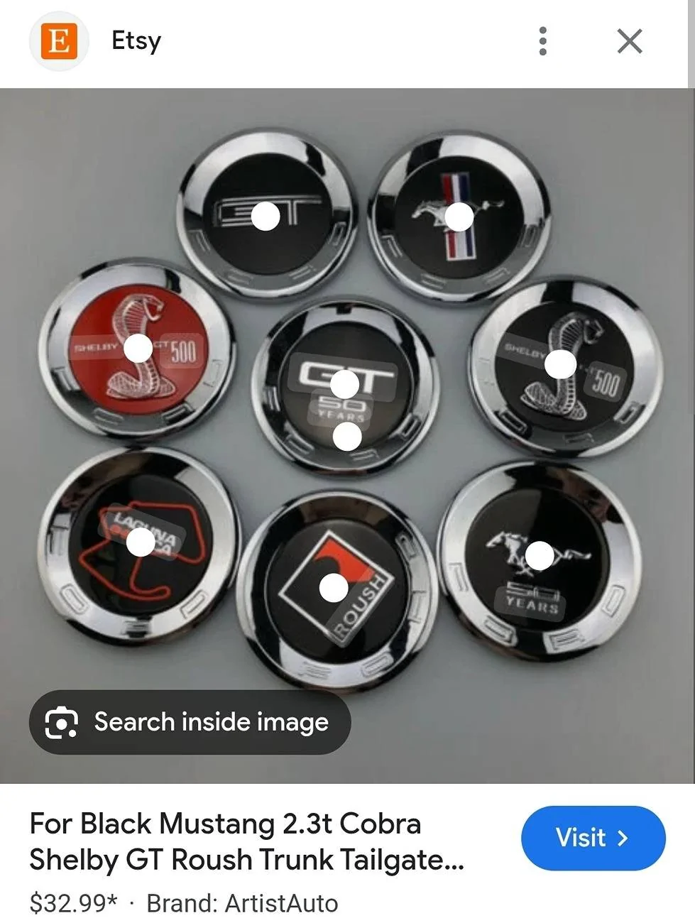

They make those aftermarket that stick on with 3m double sided tape. I used one on my Mustang. No problems.

Thanks everyone for your suggestions. I used the 3M adhesive that was in DougS550's reply and it seems to have done the trick. The only time I drive it is to take it to a few car shows so it doesn't get a lot of abuse. Only time will tell if it holds up.
