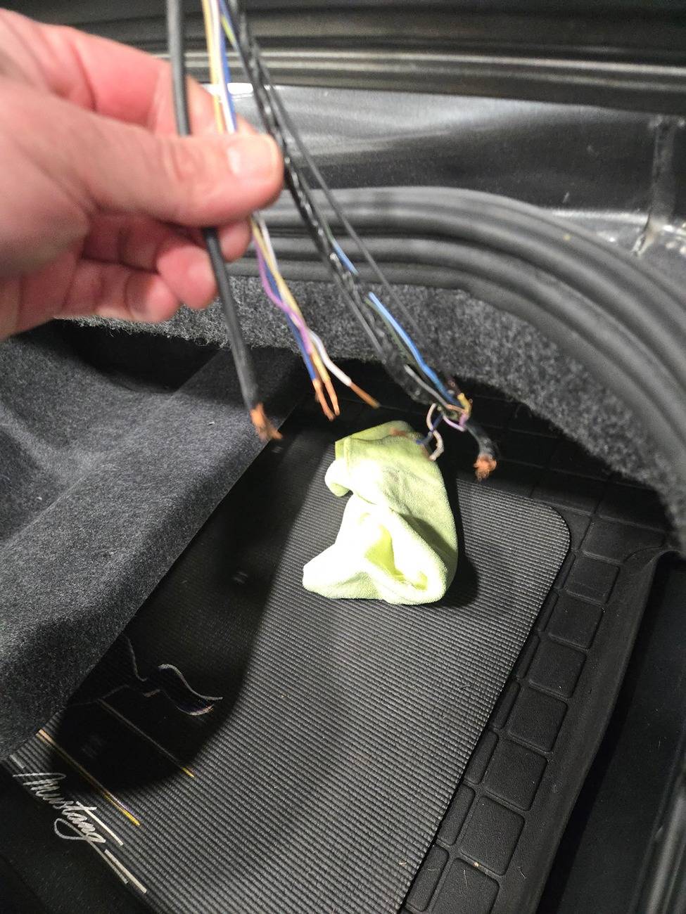

Hello Blipzyc I finally took my 2017GT in for the recall, and I'm very glad I did
I postponed this for a very long time because the only thing not working was the trunk light, no other problems at all
BUT, they found the entire harness was bad, and it was more than a four hour job to replace
Unfortunately I did not get to talk to the tech, but it's likely with that much time they have to get into the console
Now everything still works, just as before, but my trunk light also works

No, I think that recall is usually juat about the bit of wiring harness at the trunk. I dont think they’ll go under the dash

Wasn’t sure since I’ve tried tracing the wiring myself and it disappears somewhere under the back deck lid.
Does Ford do anything to prevent the trunk from pinching the wires? This is what’s caused my issues. I’ve spliced them myself twice before the recall.

Well, I mean the recall was because the wires were too short and would get fray/break at the trunk hinge area.
if you already spliced them to make them longer at that location, then they probably wont touch it for the repair. I’d double check your work.

Mine are too long then and get pinched when the trunk closes and that pinch point is where they eventually breakdown. I've got a '16 - first spliced in 2018 and again in 2022. Was going to splice a 3rd time and then the recall came out. Was hoping they did something to reroute the wires so they wouldn't keep getting pinched, but if not, I might just keep doing it myself.
