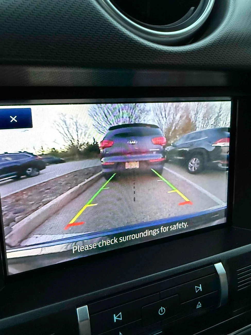

Out of nowhere on my 2021 GT, I've noticed my rear camera clarity has gone downhill and looks blurrier than it used. Like it's either not focusing or there's condensation inside. I've cleaned it off, and looked at it, and don't notice any condensation or anything. Has anyone had this before? I'm out of warranty now unfortunately, and I don't think this was a TSB on Mustangs (I remember F150s had issues with rear cameras). Seems the center is the blurriest part now. For example you'd be able to see and read the plate better and now it's super blurry.

The camera itself isn't that hard to replace, assuming it's the camera that is the problem, but it may need to be programed.

There is a camera recall. You can search Fords data base or call the dealership to make sure it applies to your year.

Mine did the same thing, I just bought one from Ford and put it in. The recall claims they still don't have product to fix it but I literally bought the camera from Ford's website

yeah just like the recall for the fuel pump from July that still doesn't have parts lmao. In my app, the only open recall is the fuel pump. hmm
