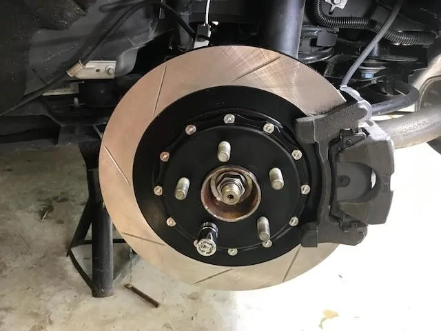

I have done one track day with the stock PP1 brakes on my 18 GT convertible and I can say they are more than adequate for the task in stock form, at least for my talent level. If you plan on tracking the car frequently, I would suggest getting a dedicated set of track pads and saving the PP1 stock pads for street duty. If you really want to improve braking performance, start cutting weight...this is hard however as I like my air conditioned seats, lol. Anyway, yes...Stock rear calipers are ugly and I don't know what can be done to improve that. Paint them some nice color and it is like putting lipstick on a pig. I even upgraded to some Steeda floating rotors F&R, on a damned group by, justifying cutting weight btw, and the bling of the rotor does not obscure those ugly rear calipers. GT350's have nice looking rear 2 piston Brembo calipers...
