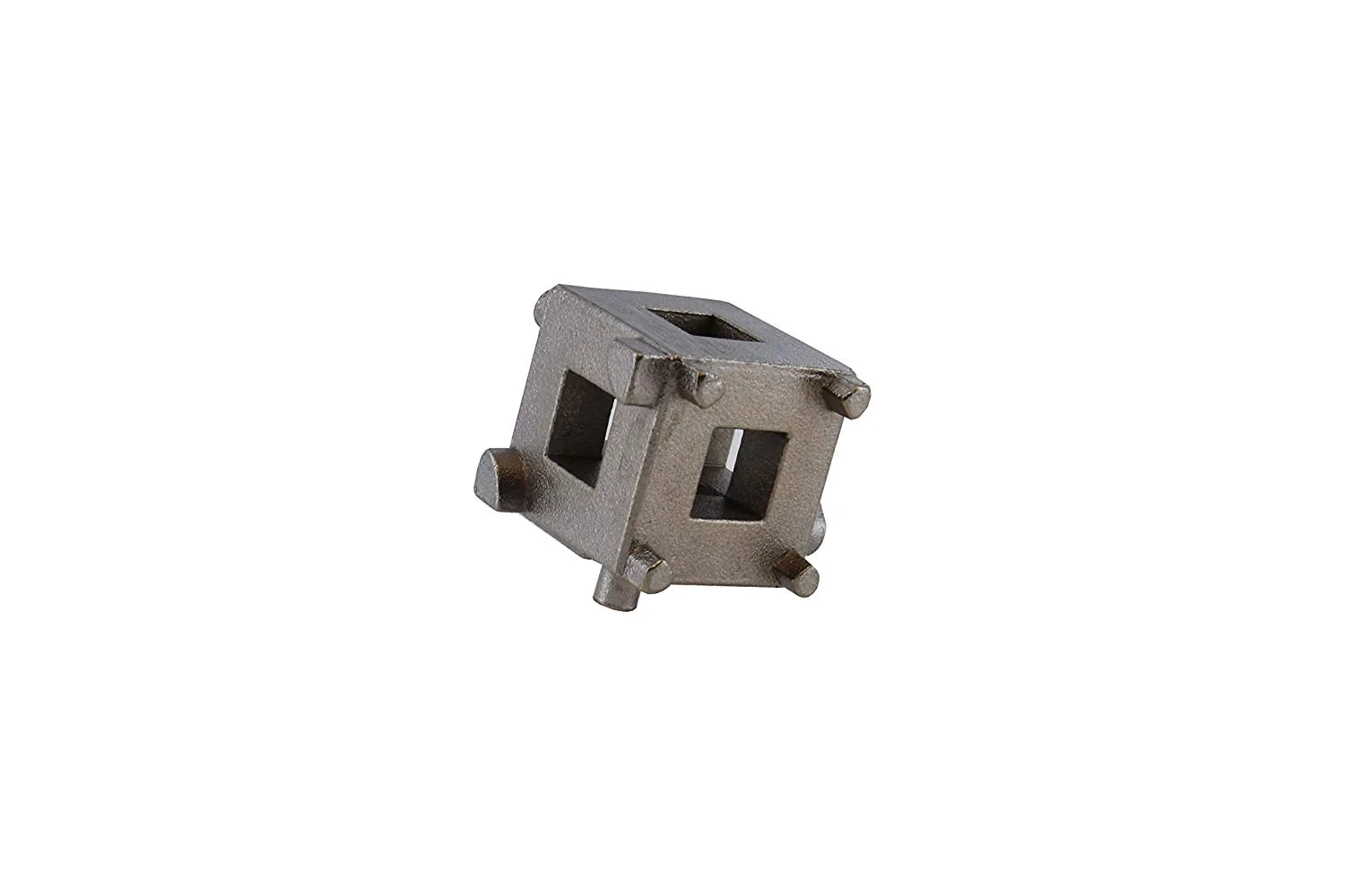

Yea, the rear piston twists in. While you could technically do it without special tools, I wouldn't recommend it.
You want a Caliper Rewind tool. You can buy a kit or some weird cube thing you stick on a ratchet. Either one will work, and both are cheap.

Never can find them when I need them so I have 3 now. They make the job so much easier.
I used one just like this.

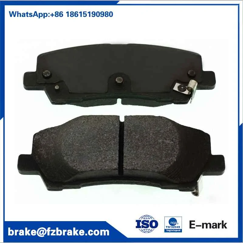

Also: VERY IMPORTANT!
The rear brake pads have a little dimple on the back that slides into the voids in the piston that are used to turn it back in. Make sure that the piston is lined up with the dimple otherwise you'll have your piston pressing only on that dimple and will have noisy/erratic braking behavior.

I've been using needle nose pliers to do this job on multiple cars with twist in caliper pistons for years with zero problems....I figure if you have to exert that much force to turn the pistons in, you likely have another issue going on.
I've been able to do this job with needle-nose pliers on some cars but not others (no real idea why - but the chance of having the pliers slip and cut the dust boot is not something I'm willing to risk any more).
I've also used the cube thingy . . . but the screw-in professional tool makes the job go so much smoother that it's worth it. These days, I get to use my son-in-law's since he got out of the car shop business.
