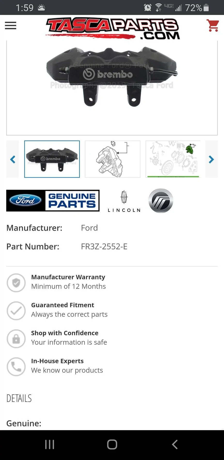

Does any company make a direct bolt on Brembo 4 piston rear brake set to match the 6 piston Brembo kit that comes stock on the 2016 PP Edition? I'm not interested in switching over to GT350 parts and knuckles.

Does any company make a direct bolt on Brembo 4 piston rear brake set to match the 6 piston Brembo kit that comes stock on the 2016 PP Edition? I'm not interested in switching over to GT350 parts and knuckles. Anyone know if this brake caliper from Brembo pictured would fit my application.

I'd call them. Pick their brains. They make it, they're the source for the good info.
I'm sure there's specific brackets and such needed too.
So I did call them and was very disappointed to hear that the person who is supposed to be in charge of all of that had no idea what the fitment would be all they know is that it will fit on a Mustang. So he actually told me to go to the forums to see if anybody did the swap for my application.
When I noticed the Ford part numbers, I realized that anyone you call there would have no idea on fitment, they're just selling Ford parts.
So I edited my post to "nevermind".
If I were you, I'd try to contact Brembo directly. If that's possible.
https://www.brembostoreusa.com/contact/

That’s the GT350 rear caliper. You’d need all of the parts in the diagram, e.g.- the GT350 brake conversion kit.
