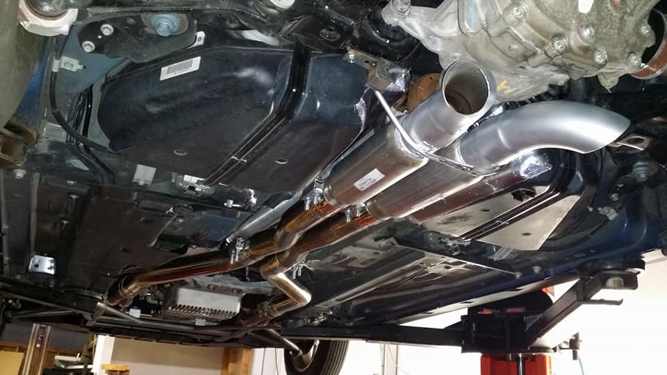

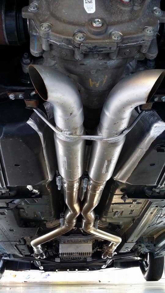

I keep getting asked about my exhaust. I can't remember if I've posted any exhaust pics. I used existing holes in the cradle, tapped them, I'm not real happy with this and may change in the future, but they are staying in place so far......so here are the parts and a couple of pics.
Headers 1-7/8" Stainless Power SM15H-PRODUCTS
Leads 3" MBRP I can't remember the part#, but they do sell they separately.
X-Pipe 3" Stainless Works ZR1X
Mufflers 3" Summit Racing bullet mufflers
Turndowns 3" Summit Racing

Why not go slightly farther back and use the existing hanger spot?
You could, but it would require some custom bending or lowering the exhaust, I like it nice & tight to the floor, it will not clear the rear housing as tight as I have it.
