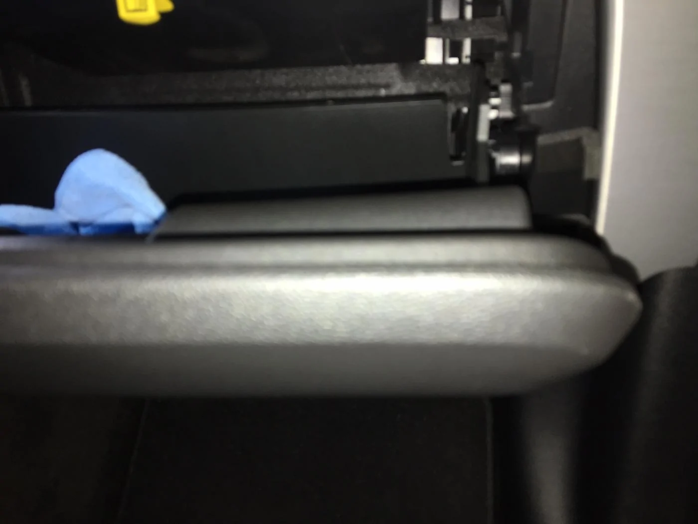

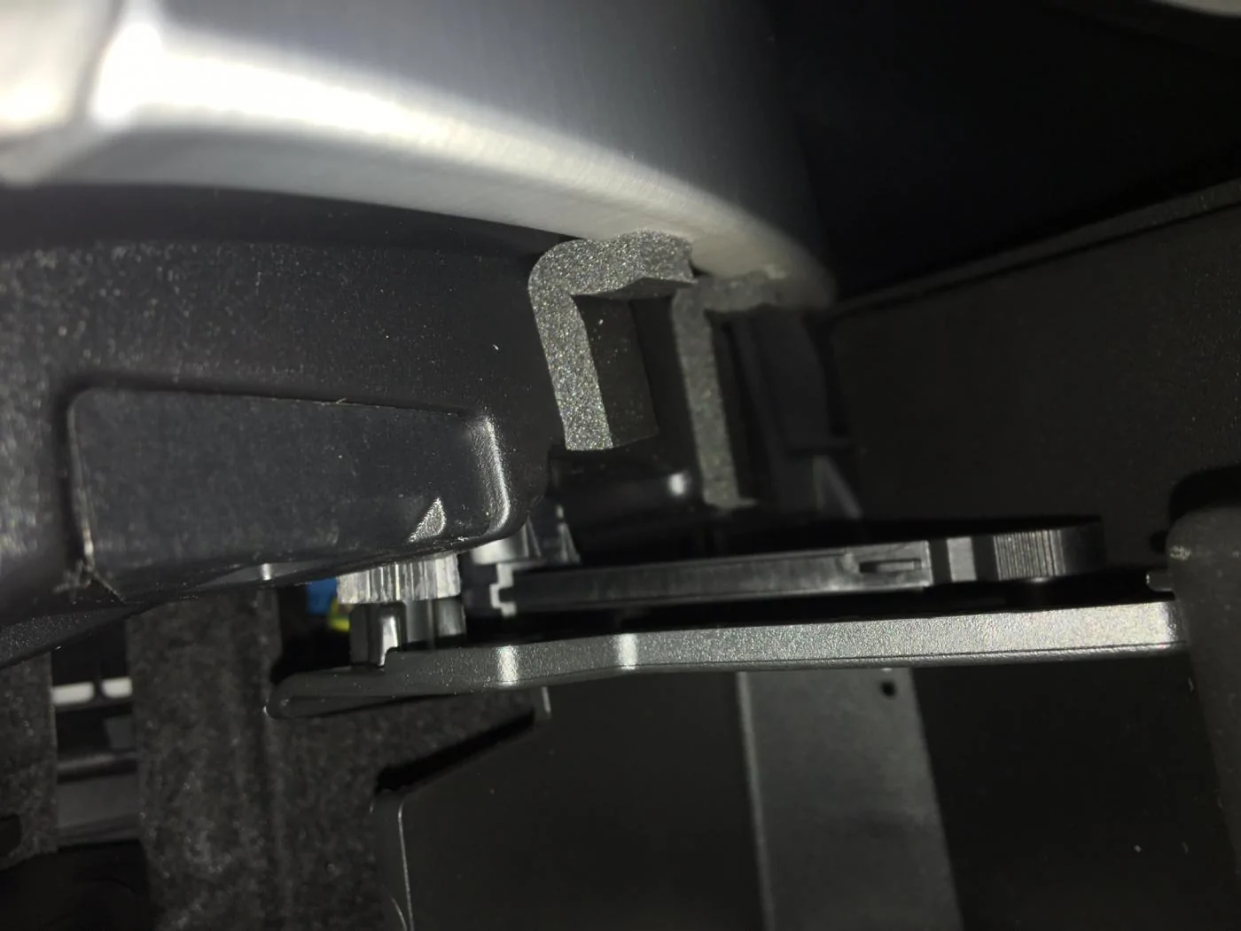

There are numerous things in the stang that creates that noise. If it's primarily coming from the glove box area then it's a simple fix.
I've told my solution before and all it requires is felt tape to be placed in the right side of the glove box area where the glove box door meets. When I get home later tonight I can upload some pics if you like?

Sure no problem. You can find foam tape at any local Home Depot, Lowe's, or Orchard's Supply. I prefer to buy at Orchard's since they're a smaller company. Then cut small pieces and make it custom fit into the right side of the glove box. Where the glove compartment door meets the side. Refer to my photos for that placement.
